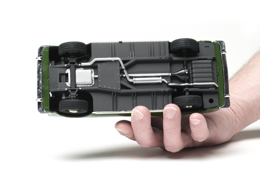

Assembly begins with the chassis. It’s molded as one piece with rear suspension, engine bottom, drive train and exhaust molded onto the chassis pan. Apparently, this kit was motorized at one time, as there is a box for a AA battery to fit into, and a hole molded in for an on/off switch. The front suspension is simple as well, but does offer some detail. The front spindles have great engraved detail on the back sides. There are even drum brakes.

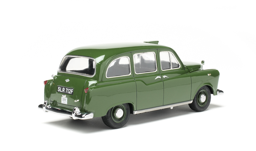

The body is a single, nicely molded piece. But it needs more detail. Side marker lights should be covered with foil, then painted clear orange. The window trim, door handles, and rear body emblems need foil, too. The windows mount inside the body; I found the one-piece side windows tricky.

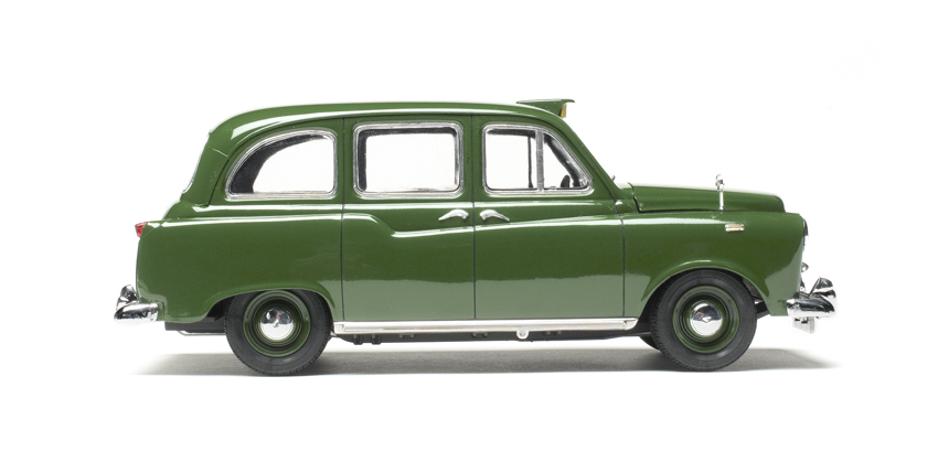

Wheels and tires look good. The fronts install via a metal pin from the outside, which is secured in place by the spindles. The rears are mounted on a solid metal axle. A small chrome-plated, dog-dish hubcap is included for each wheel. These parts trap the metal pins in the front wheels. My only nit is the tires: They are too new for a 1950s taxi. The Bridgestones would look better on a modern pickup truck.

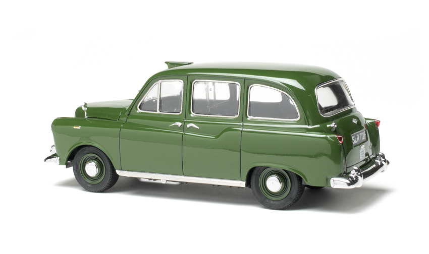

Final assembly is really a breeze. The roof sign, windshield wipers, fender-mounted mirrors, grille, turn signals, bumper, and license plate are all separate parts for the front half of the taxi. The headlights are two-piece units for each side, and they also help reveal the model’s past, which apparently featured working lights as well; the chrome headlight buckets have deep, molded holes for a small light bulb. On the completed model, the holes create a strange “google-eye” effect. Taillights, a chrome fuel filler cap, and the rear bumper complete the assembly.
The decals are the final step. Along with the gauges inside, there are two license plates and a taxicab permit to be located on the rear deck lid.
This is definitely an unusual subject, and a refreshing change of pace. The final result is excellent — I’ve already thought of a few projects for it. I’d recommend it to any modeler looking for something different.
