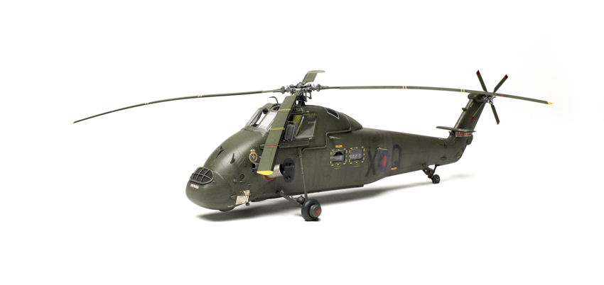

The nose is separate — probably a nod to other variants of the S-58 family to come — but that introduces the biggest fit problems in the kit. Dry-fitting showed some heavy mold seams along the upper edges of the halves that I had to remove to get a good fit. It’s difficult to join the halves because they only meet at the top.
Next came the chin, which juts down and forward; it’s a single piece, but it doesn’t quite match the contours of the nose. I wiggled it close to being right, then refined the fit with sanding.
I had the same problem with the intake insert. The mesh for the intake screen is easy to cut and will attach with solvent cement. I cut it oversize, pushed it into the part from behind, and used a hobby knife to slit the material on the sides to help it conform. I trimmed the excess mesh with scissors after the cement had dried.

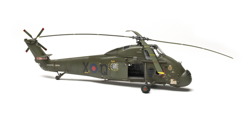

Mounting the large, well-molded windshield proved troublesome, mostly I think because of the nose’s fit issues. I had problems and ended up cracking it. (Of course, this may be due to user error.)
I was going to use the plastic rotor-head screen (No. 18A) with the plastic net, but I couldn’t get it to fit. So, I used the alternative photoetched-metal part (No. 1PH).

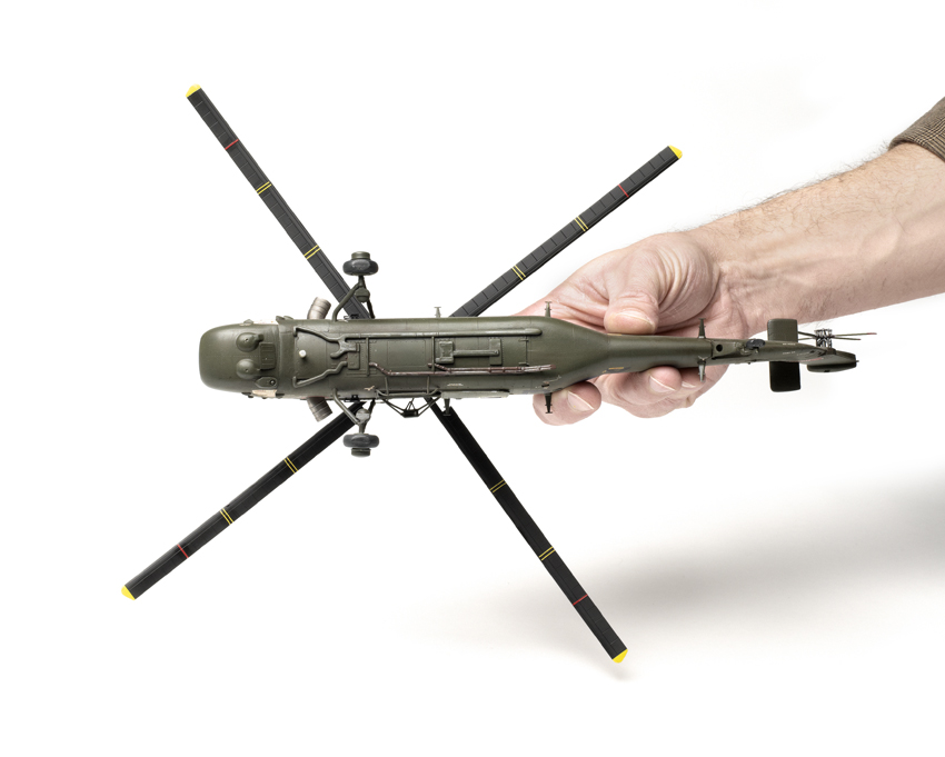

The main and tail rotors assemble easily. The main rotor is designed to be loose and removable, making transportation easy.

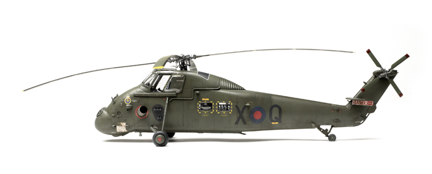

The kit includes four marking options. I was tempted by the colorful gray, green, and black camouflaged Royal Air Force rescue chopper, the red and blue Royal Navy rescue bird, and another R.N. transport in tan and green camouflage.
In the end, I settled on the fourth option, an overall green R.N. HU.5, after finding a photo of the aircraft included on the decal sheet — XT480 — rescuing survivors after the sinking of RFA Sir Galahad during the Falklands War.
I mixed my approximation of the dark olive green worn by the aircraft using Tamiya NATO green, dark green, and a little yellow.

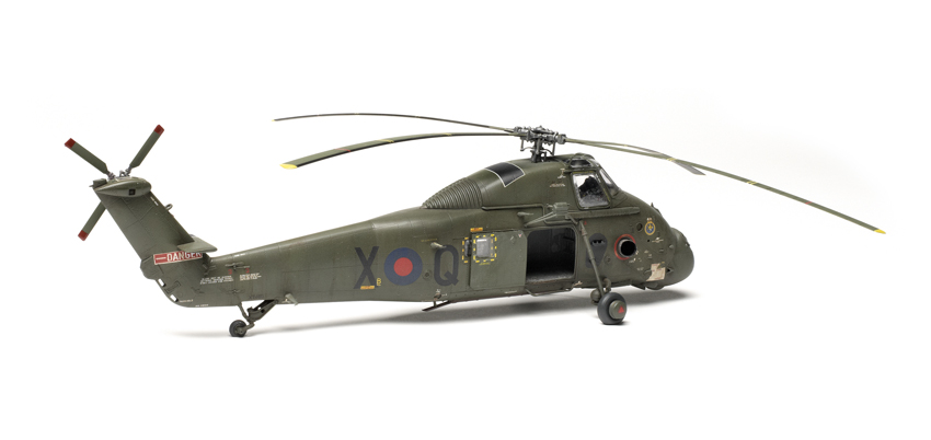

The decals applied well over a coat of clear gloss. But a lot of them are too big to fit where they are supposed to go. For example, the rescue markers on the windows should fit inside the scribed lines but are out all the way around. The problem is especially noticeable at the front, where there are a lot of stencils. Putting them all where they belong is complicated.
After clear coat and final assembly, I’m pretty happy with the chopper. The model captures the utilitarian lines of the Wessex well and it makes a terrific addition to my Falklands collection.
