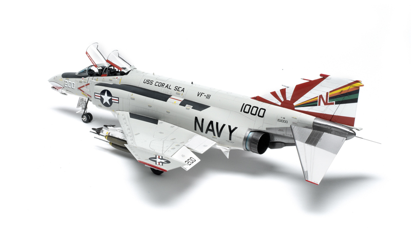

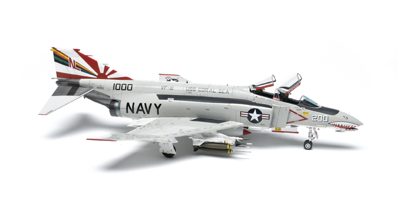

Finally — an F-4B with engraved panel lines and full intake trunking. Wow!
The kit is molded in three colors — gray, white, and black — for those of you who want a nice-looking model without painting. It really doesn’t look too bad that way, either.

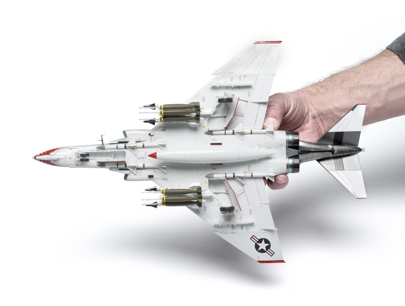

You get three types of Sidewinder missiles, two types of Sparrow missiles, and 12 Mk.82 bombs with pre-fusing caps, short fuses, or the extended fuses (which I used).
You get a centerline fuel tank (Navy version) and two wing tanks that aren’t often used on Navy fighters when deployed. They are, however, used on Air Force versions (hint, hint).

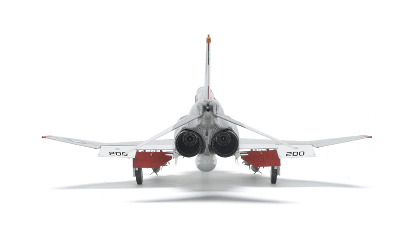

You also get a centerline Vulcan cannon, an ALQ-119 ECM pod, and chaff dispensers for later versions, along with all the associated hard points, missile rails, two MERs, and two TERS. Also included are two forward nose-gear doors that are finally the proper shape, one for the Navy and one for the Air Force. And at last you get the longer exhaust cans and wider tires used on later versions. The intake trunking is a nice feature, but you can see a step when you look down the intakes.

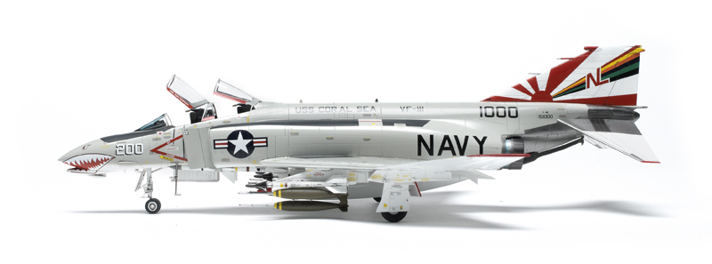

Step 6 joins upper and lower fuselage. You have the option of an extended or retracted refueling probe; I closed mine up. I didn’t want to detract from the lines of the model.

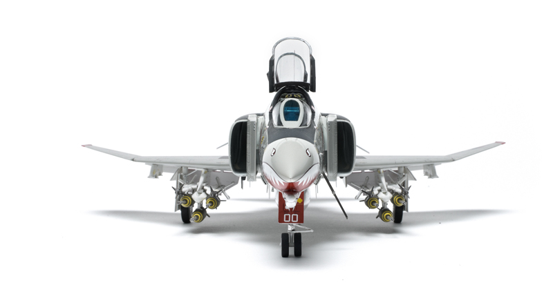

In Step 7, installing the intake assemblies, make sure that the seam above the wing is smooth so you can deal with the mismatch that’s inherent in Phantom models; I haven’t found one yet that mates perfectly, in any scale. (Ejector-pin marks have to be filled inside the intakes on their bottom sides.) The panel that replaces the Air Force refueling receptacle is a sloppy fit. Also, the air conditioning intakes (parts G34 and G35) are a bit too narrow. But they’re workable.
In Step 9, Part O2 stands a bit proud and has to be sanded and blended with the fuselage; otherwise the tail won’t sit right.

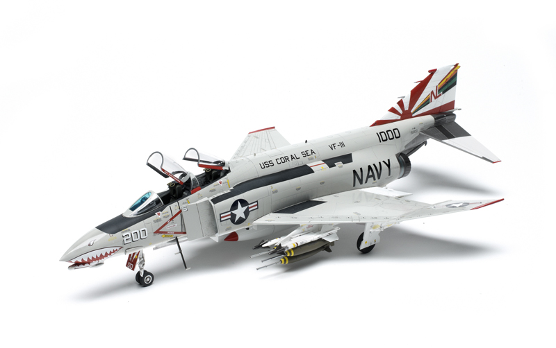

The rest of the assemblies went off without a hitch. I used the missiles called for in the instructions. The bombs need the pre-arming caps to be installed on the front, but the kit provides both short and extended fuses. I used the latter, also shown with the finished model on the box.

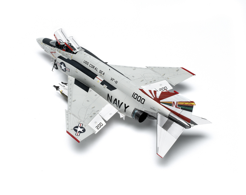

I painted my model with Testors Model Master enamels and Alclad II for the exhausts and Sidewinder tips.
There are lotsa stencils! They went on perfectly, but they like to stick almost immediately. The good news is that they’re arranged in numerical order on the decal sheet, making application easy. Just cut off a row, find them in the instructions (which are very good), and put them on. Tail decals are engineered perfectly and fit with no trimming.
I spent about 45 hours on my kit, 10 just for the decals, and it builds into a terrific model. Highly recommended!
