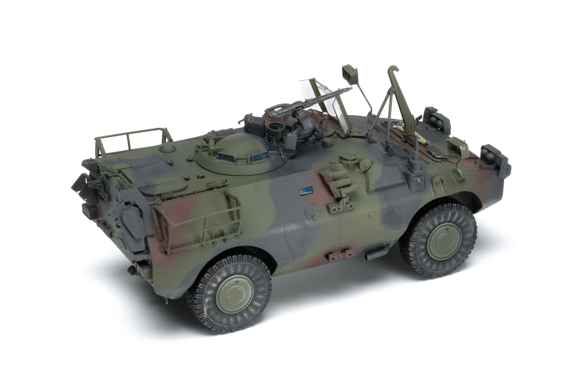

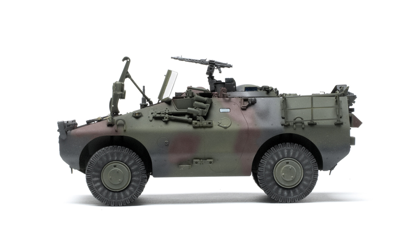

Opening the box, I was delighted to see just nine sprues of parts, two frets of photoetched brass, four vinyl tires, and a nice decal sheet. Surface detail is well-molded throughout. Seeing a part count around 300, I assumed this would be a fairly quick build. That was not the case.
Instructions are presented in 12 steps over a 12-page magazine-style booklet. Included are a separate decal and paint guide and a parts tree breakdown.

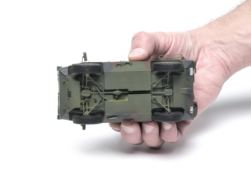

The first couple of steps deal with building the suspension and drivetrain. Parts PE A1 are suspension-mount brackets. These are very difficult to put in place, so be patient. Suspension detail looks great once it’s fully assembled and installed.
I ran into quite a bit of trouble on Step 6. The directions are not very clear on bending the photoetched-metal parts, and once this assembly is together it’s not clear where it goes in Step 7. I referred to the picture on the decal and paint guide to see if I had it in the correct position. Turns out I might have had the angle off a touch.
Steps 8 and 9 are very busy; you have to be careful to make sure nothing is missed. I chose not to add parts D26 (bolt heads?) as I lost most of them while cutting them off the frets. You can pose some of the hatches open or closed. But there is no interior detail, so I glued mine shut.
The rest of the build is pretty straightforward and mostly trouble-free.
The photoetched-brass parts are thick and hard to bend. A good bending tool helps. Also, I did lose a couple of photoetched-brass parts while bending them — Part PE A6 hit the floor and was never found — so I left these parts off the model.
I painted my model using Tamiya and Floquil paints for NATO green, NATO brown, and grimy black. The decals went on over a gloss coat with no problems at all. I noticed no silvering on any of the decals.
My model took me a little more than 30 hours to complete, much more than I anticipated when I opened the box. Due to the difficulties with the photoetched brass, I would not recommend it for a beginner. However, experienced modelers should enjoy building this Puma.
