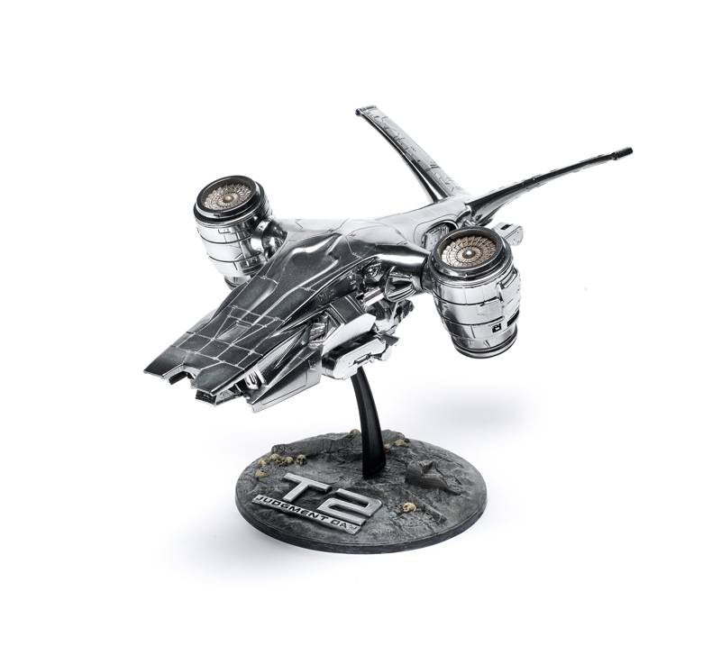

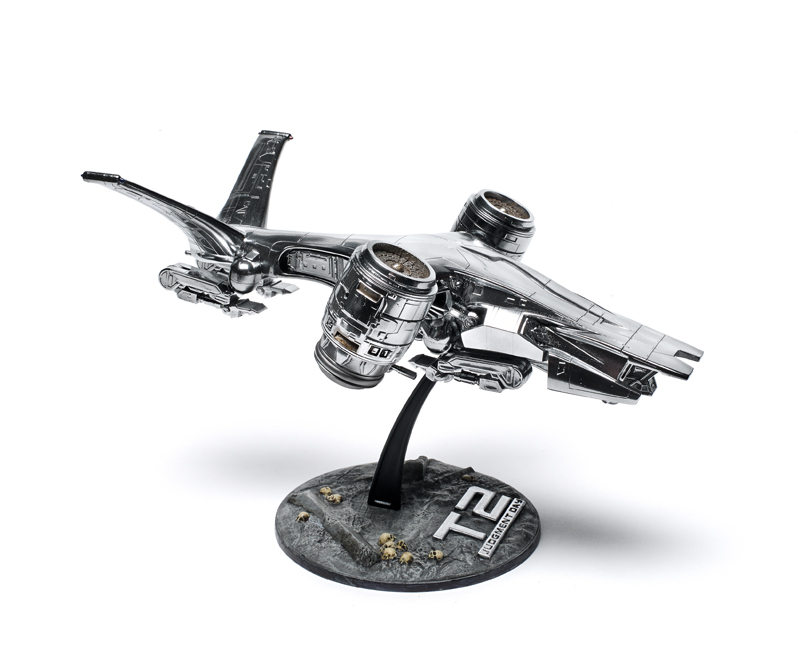

The hunter-killer should be shiny, but the plastic is a bit pebbly. I airbrushed Alclad II gray primer and microfiller and sanded to smooth it before spraying gloss black and Alclad II chrome. Testors Metalizer burnt metal in the exhaust areas provided a little variety.
I pushed the subassemblies into position and glued on the clear parts.
I painted the base in shades of gray, then picked out the skulls on the ground with desert sand. Artist’s oil washes and dry-brushing added contrast and detail.
The finished hunter-killer matches the aerial weapon from the movie. It’s surprisingly small in 1/32 scale. I’d like to do one with lights and a more-detailed base.
