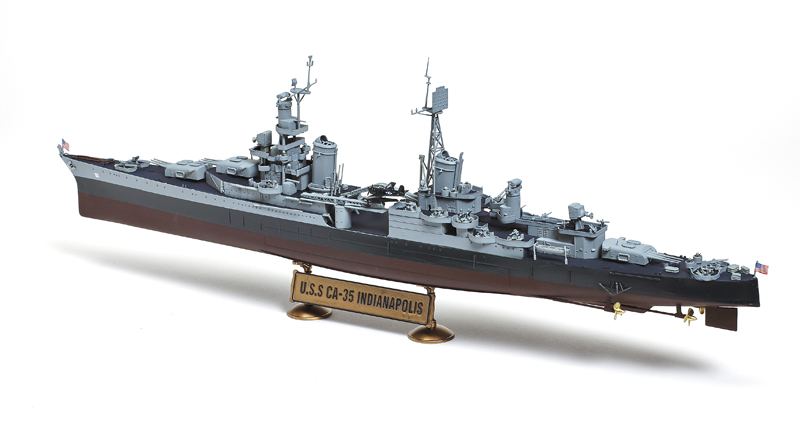

Academy’s kit provides a choice of either a full hull on a stand (included) or a waterline model. Guns and turrets are movable, and the larger guns have hollow ends. The comprehensive instructions and painting guide are helpful. One set of markings is provided.

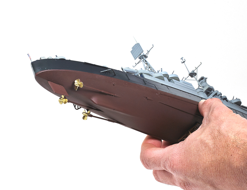

Choosing the full-hull version, I found the upper and lower hull dry-fit was fine. The deck was a tight fit — no gaps or seams to deal with. (The break was at a vertical wall in front of the hangar.) Propeller shafts are numbered so you need to note their position. Since the camouflage pattern is in Measure 22, I painted the lower hull in Tamiya hull red and Testors sea blue. The propellers are Testors Metalizer brass.

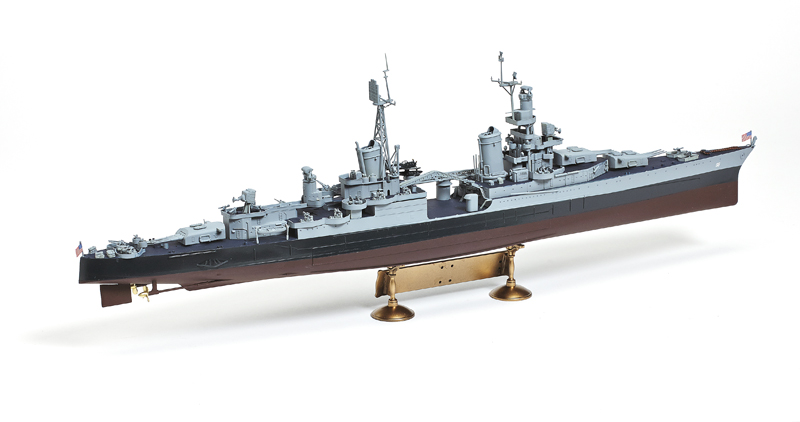

I assembled the stand and painted it with SnJ Bronze. However, the base’s footings are a little on the small side; even with the ship on it, it tipped over easily.

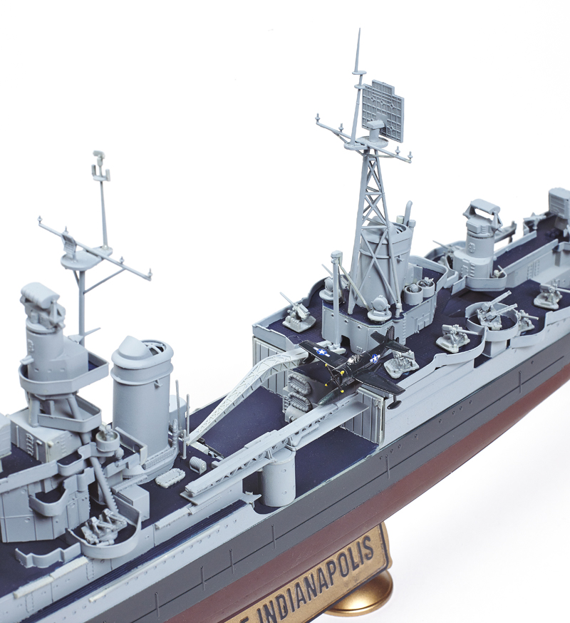

Attachment points for the superstructures are minimal, making the glue joint less solid than I would like. The mast — part numbers D23, D24, D25 — was difficult to glue together and had a seam that needed to be cleaned up. The radar turret had gaps between the walls that needed filling.
I painted the superstructure with Testors dark ghost gray (No. 1741). Installing the superstructure assemblies on the hull went well. The catapult and aircraft installation went off without a hitch.
