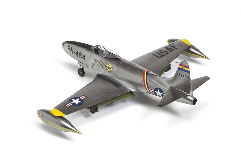

I built the wings as directed but left off the ordnance and gear until after painting. However, when I tried to join the wings to the fuselage, either the tops of the wings matched the roots or the bottom matched the fuselage. I went for the wing roots and used layers of Mr. Surfacer to smooth out the 1⁄16" step on the underside. Next time, I would glue the lower wing to the fuselage first, then mate the upper wings to the roots and trailing edge. This would leave a gap at the leading edge that would be much easier to shim and fill.

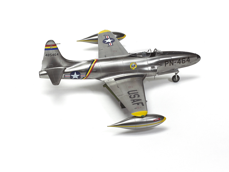

I was able to press-fit the horizontal stabilizers, allowing me to attach them without glue after painting. I primed with Mr. Surfacer 1200. After dealing with four sink marks in the nose and polishing the primer smooth, I airbrushed Tamiya gloss black as a base for a natural-metal finish of Alclad II airframe aluminum.
The Alclad II paint’s smoothness made gloss before decals uneccessary. The insignia are oversized compared to the markings instructions. Confused, I refloated and lifted them several times. Finally I applied the fuselage stripes, trimming and shaping them to match the instructions, and placed the insignia as the markings guide originally showed. The decals held up incredibly well. The tail stripes required trimming but settled down with multiple applications of Solvaset.

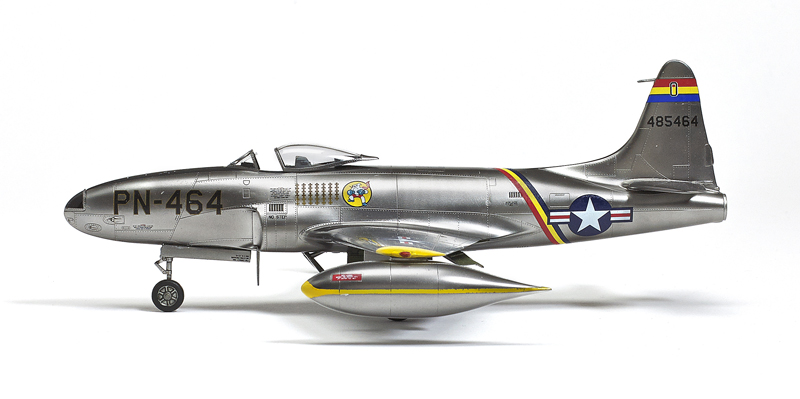

The plane’s stance is too level — the nose should be up a little — but this could be easily corrected by slightly shortening the main gear.
To weight the nose, I coated small fishing sinkers in super glue and dropped them in the nose before adding the radome cover (Part G2).
