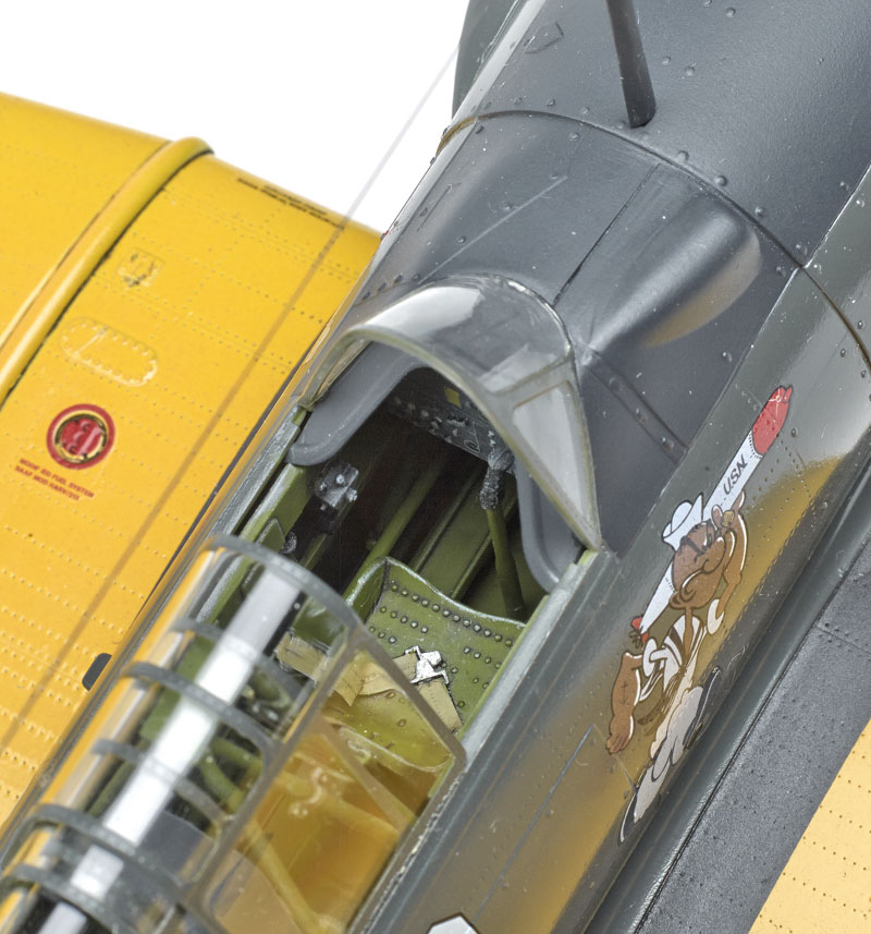

Steps 1-7 deal with the cockpit. You have a choice of joysticks for U.S. and foreign, and decals for the instrument panels. They actually fit pretty well, but, as I said earlier, they want to stick right away. When you finally pull all the components together, take your time — there are a lot of locator holes.
Leave the rollover tower that’s supposed to be installed in Step 7 off until final painting; it’s easier to mask the cockpit area that way.

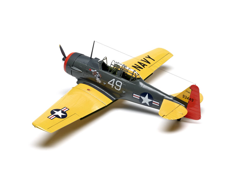

For markings, I chose Option 2, a Navy plane with yellow wings and dark gray fuselage. Paint callouts point to a tan prop, but I’ve never seen one painted that color; I painted mine flat black. I found the landing gear is too far inboard (by about 1⁄8"), but that’s not a fatal flaw.
It took me only 19 hours to build this Texan. That’s pretty quick, considering the engine-mounting difficulties. A beginner might get crossed up by some of the problems I found, but intermediate modelers should be able to work their way through to a decent model. Kitty Hawk’s kit looks nice when it’s complete — even if the canopy doesn’t go with the variants depicted and the colors don’t resemble standard military schemes.
