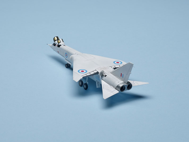

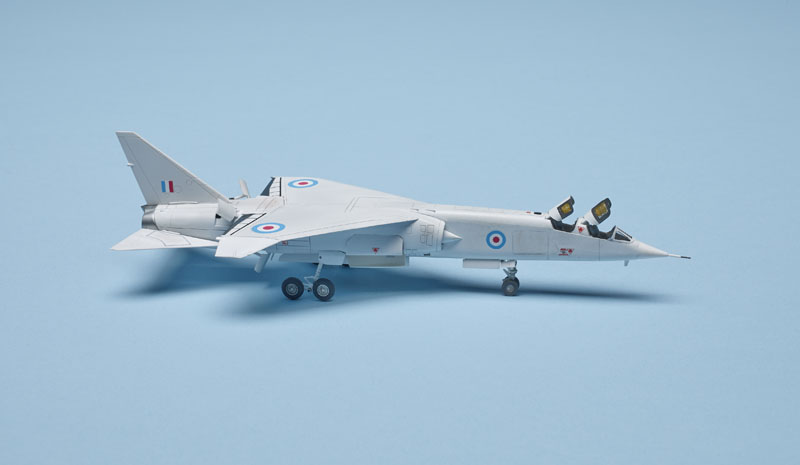

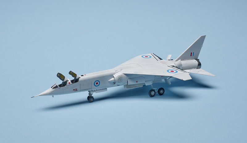

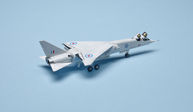

Before assembling the upper and lower fuselage halves, I added some ballast (even though it’s not mentioned in the instructions). Almost immediately, I deviated from the suggested sequence by not attaching the wings as recommended. Doing so would make installing the intakes and main gear bays more difficult. I added those parts to the fuselage first, then the wings. I left off all the stabilizers and the exhaust until the end of the build. Overall fit was good, though I did have to thin down the forward edge of the flaps so they fit flush with the top of the wings.
Two areas needed attention. The clear parts did not match up with each other in the closed position, so I displayed them opened. The windscreen needs some sanding to fit, too.

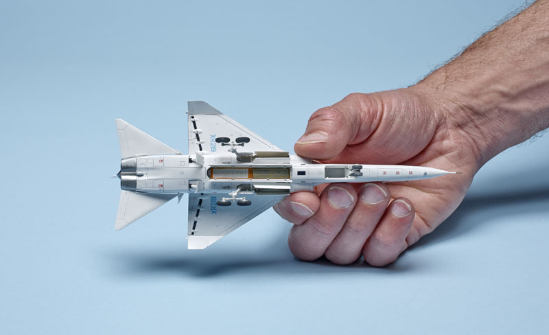

My biggest challenge with this kit was the main gear. The wheel bogie attaches to the main strut at a single point, offering little purchase for the bond. The wheels should be perpendicular to the ground, but those on the model angle inward and forward. I opened the “half moon” hole on the bogies so they could rest parallel to the ground, but the joint was still flimsy. I would suggest you add a small brass pin to connect the strut and the boogie.
Painting is simple — it’s white. To break up the monotone, I spayed some off-white and light gray in various bays and panels. I chose to depict aircraft 219, since it was the only prototype to fly, flew many missions, and was quite weathered. I’ve had problems with GWH decals silvering on other builds, so I made sure I had a good gloss coat laid down. This and the white background definitely helped. I used pastels to depict wear on the model. The canopies’ clear portions are gold and almost opaque.
This is a great little kit, but the engineering of the main gear is a problem. You can display the model on the kit-supplied stand, and this might be a good choice if you do not want to deal with the landing gear challenges.
