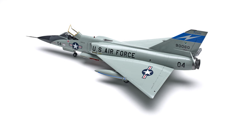

Two sets of markings are supplied, one from the New Jersey Air National Guard and one from the Florida Air National Guard. The blue for the Florida markings is way too bright. Although the color varied slightly, it was never that vivid. The true color is closer to Blue Angel blue, FS15052 or thereabouts.

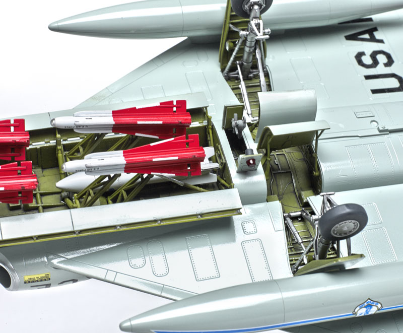

The only other tricky part is the weapons-bay assembly in steps 19 and 20. If you have the weapons bay open, which I do, instructions are to install the bay-door hinges (hinges, not the door), then the bay doors (steps 19 and 20, respectively), before mounting the missiles and associated missile rails, supports, and forward cross-bridge assemblies. I did it the other way around, essentially working from the inside out. There’s a little slop in some of the components, so it’s a good idea to glue the supports and rails together and place — don’t glue — them in position until the glued parts dry. This gives you a chance to adjust everything as the glue sets so it all lines up.
When installing the bay doors, just follow the instructions. Install the upper bay doors first, making sure the hinges seat properly in the fuselage hinge area. Then make sure the doors contact the actuators you installed earlier. Once the glue on these has set up, install the lower doors. There’s a male/female hinge arrangement for this assembly, too. It gets a little tedious because you’re trying to get everything to mate and match up (hinges, actuators, etc.), but it can be done.
The other option is to close it all up with a one-piece molding of the doors (Part B8 in Step 18).

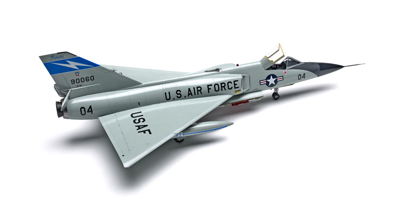

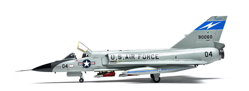

Decals were easy. As I said earlier, I used the Florida Air National Guard markings despite the blue being too bright. (I already have a New Jersey Air National Guard model.)
It took me about 31 hours to complete this F-106, a little more than average; I could have knocked off about 10 hours by just closing the weapons bay, but I’m a glutton for punishment. If you take the easy way with the weapons bay, and you consider yourself an intermediate modeler, you shouldn’t have too much trouble getting up to speed with this Mach 2 interceptor.
