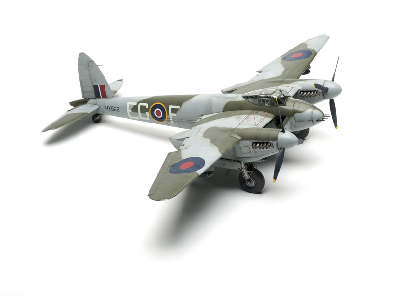

We’ve waited a long time for a replacement for Revell’s good, but old, 1/32 Mosquito. Those hopes have finally been fulfilled in a big way by Tamiya’s Mosquito FB Mk.VI — one of the most common versions of de Havilland’s iconic “Wooden Wonder.”
The kit’s loaded with features, including a detailed weapon bay with 500-pound bombs and 20mm cannons. Wafer-thin cowlings attached with small magnets cover the complete Merlin engines. (The U.S. release provides optional clear-plastic cowl panels.) Two photoetched-metal frets of different thicknesses and printed masks (you have to carefully cut them out) round out the package. From the box, you can build one of two Royal Air Force aircraft in sea gray camo with dark green patches or an overall silver Australian bird.
The well-laid-out instructions bear careful study because of the many options — crew seated or not, flaps up or down, multiple positions for the weapon-bay doors. It’s easy to miss parts that need to be installed for a later step.

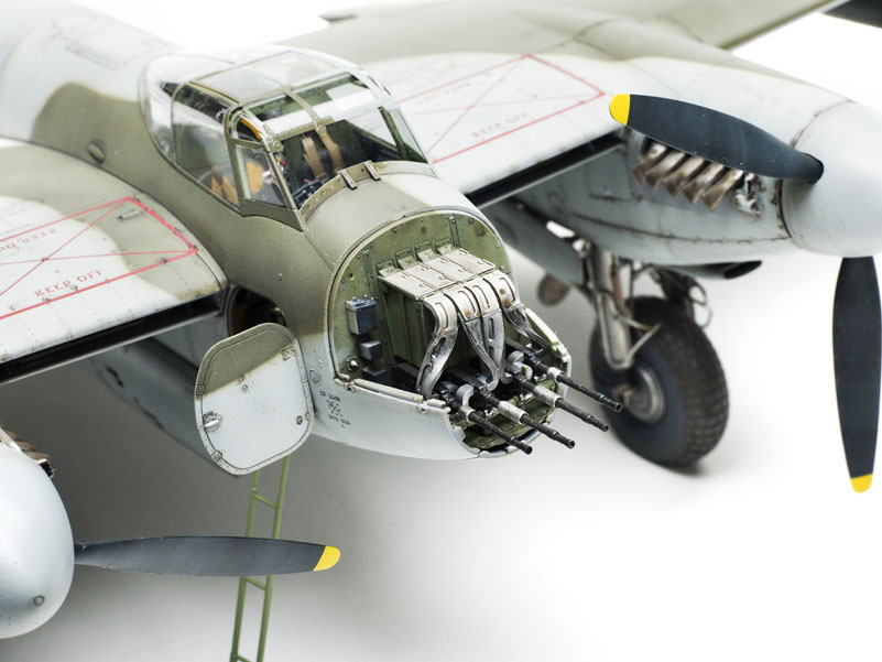

Tamiya has you install the four .303-caliber machine guns in the nose early. But the gun cover fits well, so I left them out until after painting to minimize losses during handling and simplify masking.

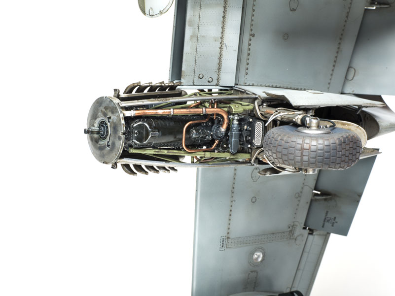

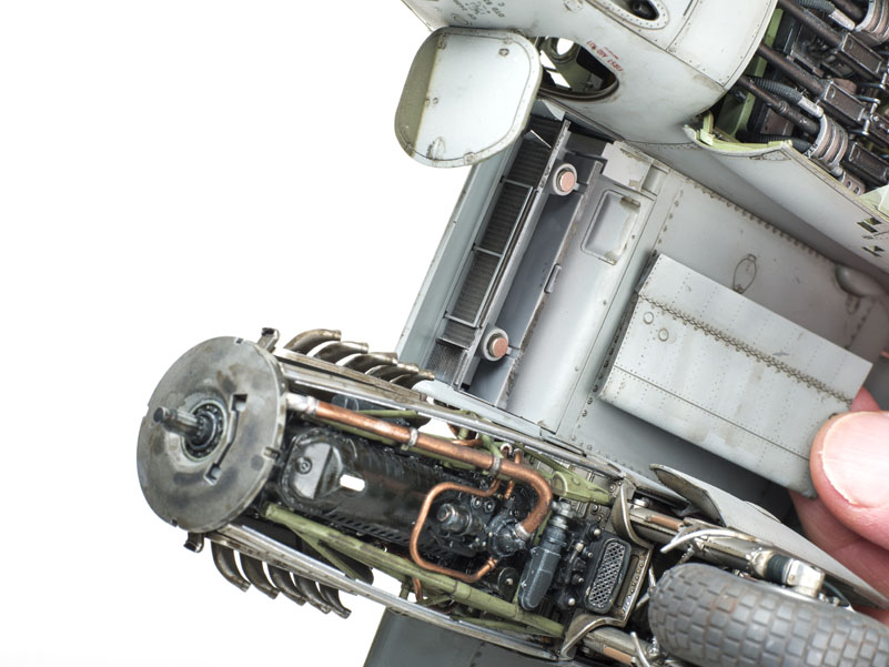

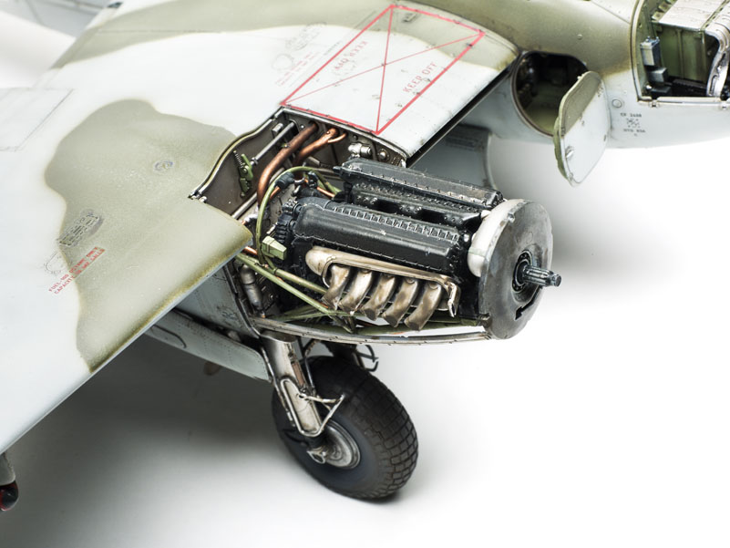

I built only one of the engines to display, so I left many of the detail parts off the second, using only what was needed to connect the prop, panels and exhausts. Pay attention to the instructions — especially which engine you’re working on — as many critical components are handed. Numerous magnets and metal plates are installed during engine assembly for the removable panels.
Two machine screws secure each engine to its firewall.
I encountered difficulty installing one of the pipes (Part 54). Pay attention to the drawings for details about which parts of the piping snake over and which parts snake under the engine mount.
Once complete, the engines and their nacelles fit perfectly. Tamiya molded a substantial wing center section as a single part, eliminating alignment problems. It’s a complex unit incorporating cockpit detail topside, gear-bay details underneath, and engine-mount details in front. Once again, the fit is outstanding with machine screws attaching the outer wing panels.

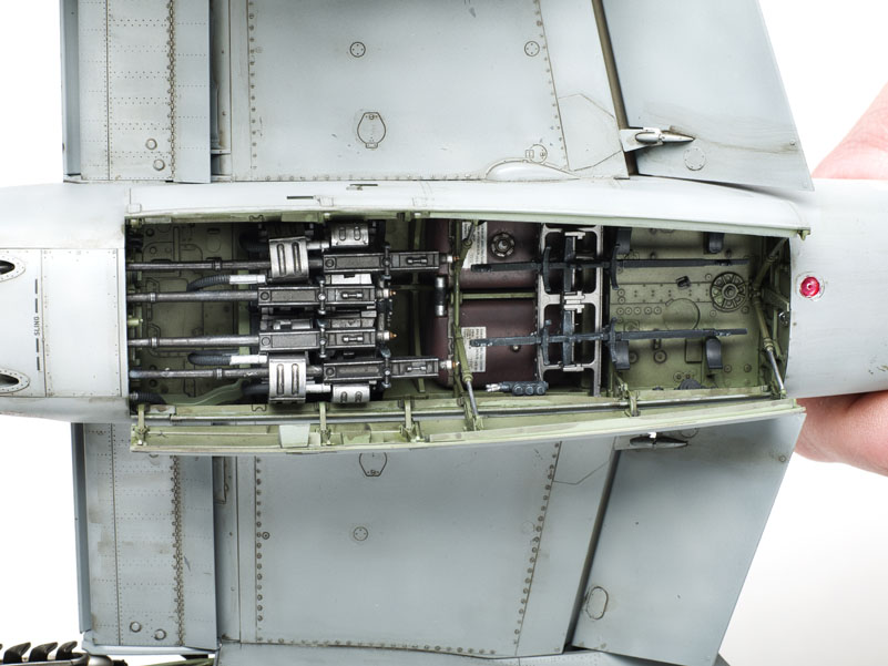

I was hoping to leave out all the weapon-bay detail during painting, but the shape of the round fuselage precludes adding the sides of the bay without the 20mm cannons installed. The detailed guns include mounts, ammunition cans and chutes, and heater hoses. The barrels are a cinch to align thanks to two photoetched-metal guides — more thoughtful engineering.

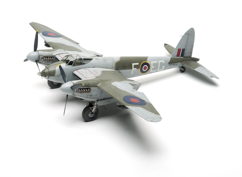

With enlarged copies of color instructions as a mask, I painted the big Mosquito Tamiya medium sea gray and RAF dark green. I hoped to use the cowl panels as masks to cover the assembled and painted Merlin, but the magnets weren’t strong enough to stand up to the airbrush. I made a tent from business cards instead.
The decals went on well, but I suggest trimming as much carrier film from the large red “No Step” crosses as you can. The film is thick and noticeable. There are a large number of tiny stencils to apply, but the instructions are clear about placement.
Weathering was applied using Flory dark dirt wash. Then I attached all the bits and pieces, such as the landing gear and bay doors; the fits were first class.

As you might expect from a large-scale Tamiya kit, details abound. These are just some of the parts that make up the pilot and navigator stations. Although a bit difficult to detect, the armored bulkhead for the navigator is molded in clear plastic to allow for the vision port. Note the photoetched-metal instrument panel sections that hint at the detail to come.
