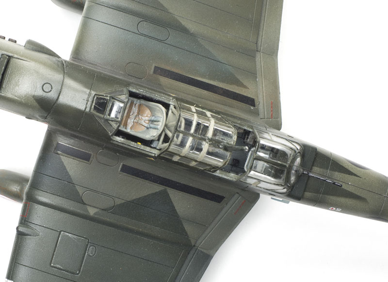

This kit was engineered with the modeler in mind, starting with the cockpit. Detail is outstanding: Airfix provides the side walls as two pieces with molded detail that will pop with careful painting. You glue the rest of the cockpit’s pieces onto the lower center wing; this assembly slides up into the fuselage to complete the cockpit and provide the foundation for the correct wing angle.

Airfix provides a single clear piece for the two overlapping parts of the opened canopy. Frames are molded for both the pilot’s sliding section and the fixed center portion in this one piece. Masking the frames is a little tricky, since the vertical interior frames are a different color (RLM 02) from the other frames. I eventually used strips of decals for these interior frames.

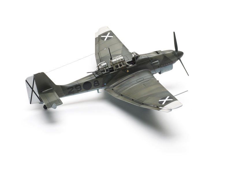

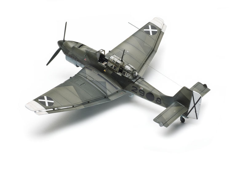

There are two marking options, though both have the same camouflage scheme. I sprayed GSI Creos, Tamiya, and Vallejo acrylic paints to match suggested colors. Painting the splinter pattern isn’t difficult, but it requires much masking.
After spraying a couple of coats of Tamiya clear, I was ready to apply the decals for the Legion Condor. The decals worked as advertised and responded well to setting solution. Clear areas between the numerals on the fuselage exhibited some silvering, but that disappeared with more applications of Micro Sol and coats of gloss, then semigloss clear. The clear layers did, however, mute my weathering effects quite a bit.
