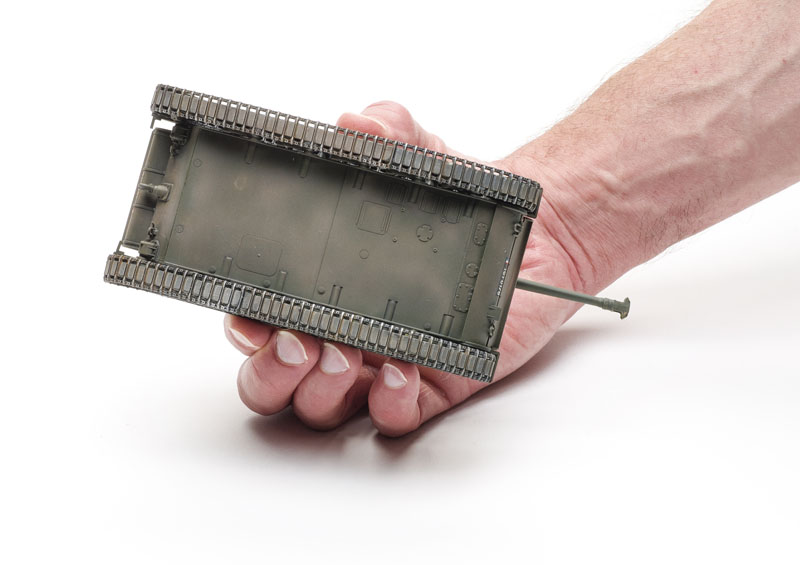

While the tracks are easy to assemble and paint, they do lack the slight sag in the upper run seen in photos of the real vehicle.

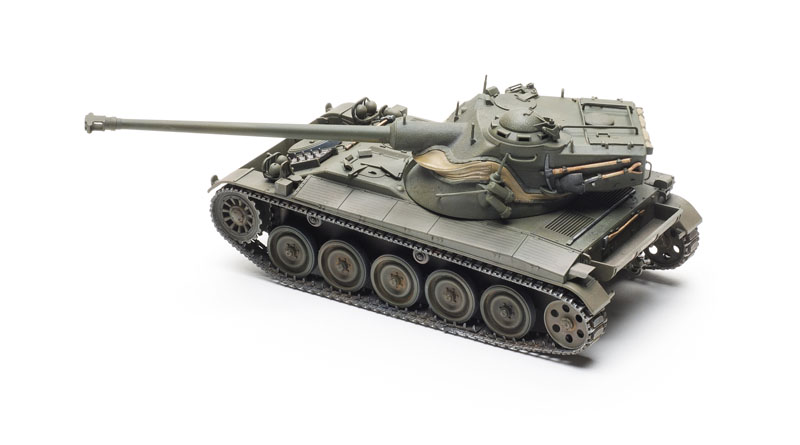

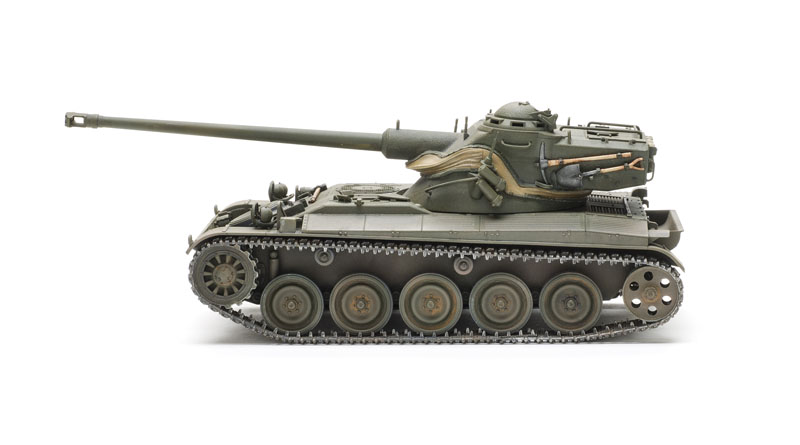

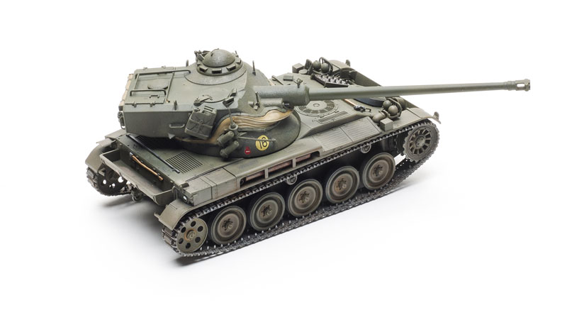

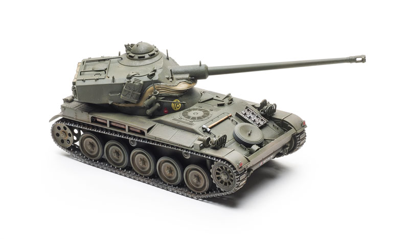

The finished model matches published dimensions, and, aided by the excellent fit and engineering and single-color paint scheme, it took me only 14 hours to build my AMX-13. The kit would make an excellent choice for a beginning modeler.
