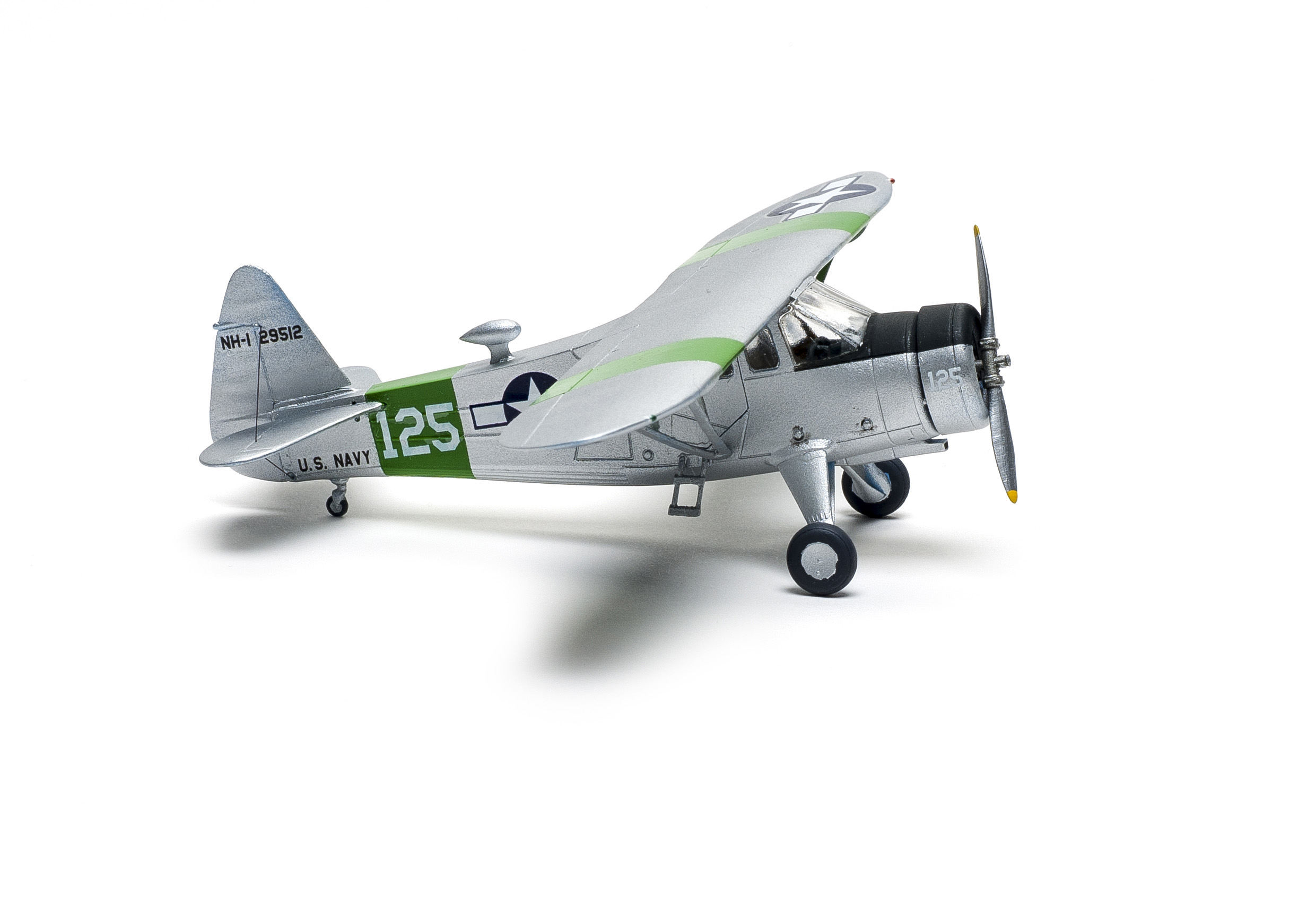

Cast in an eye-catching powder blue resin, the parts are detailed and well defined. The smaller detail parts are a bit over-scale and are difficult to remove from their pour plugs. However, it was a pleasant surprise that the resin struts were easily removed, thanks to the molded-in gaps in the plugs.
The resin is resilient and reasonably strong — I didn’t have to replace any broken parts. Clear resin windows are included, and while they were quite thick they fit exceptionally well.
I added Pledge Floor Gloss (PFG) to the windscreen to enhance its clarity, along with a touch of filler at the top where it meets the wing.
A full interior is included, along with a separate cabin door that can be posed open — although the thickness is over-scale. Be aware that the decals are sealed with a carrier film over the entire sheet, not the individual images. I found that out while attempting to apply the instrument panel decal — better then than later!
The fuselage halves needed sanding along the mating surfaces to even them up prior to gluing them — my sanding must have been a bit too exuberant, because I had to restore some material at the nose with a piece of styrene rod stock.
I painted the detailed one-piece engine casting and mounted it inside the one-piece cowling prior to adding it to the fuselage using the alignment tab molded on the nose — well-designed, Dekno!

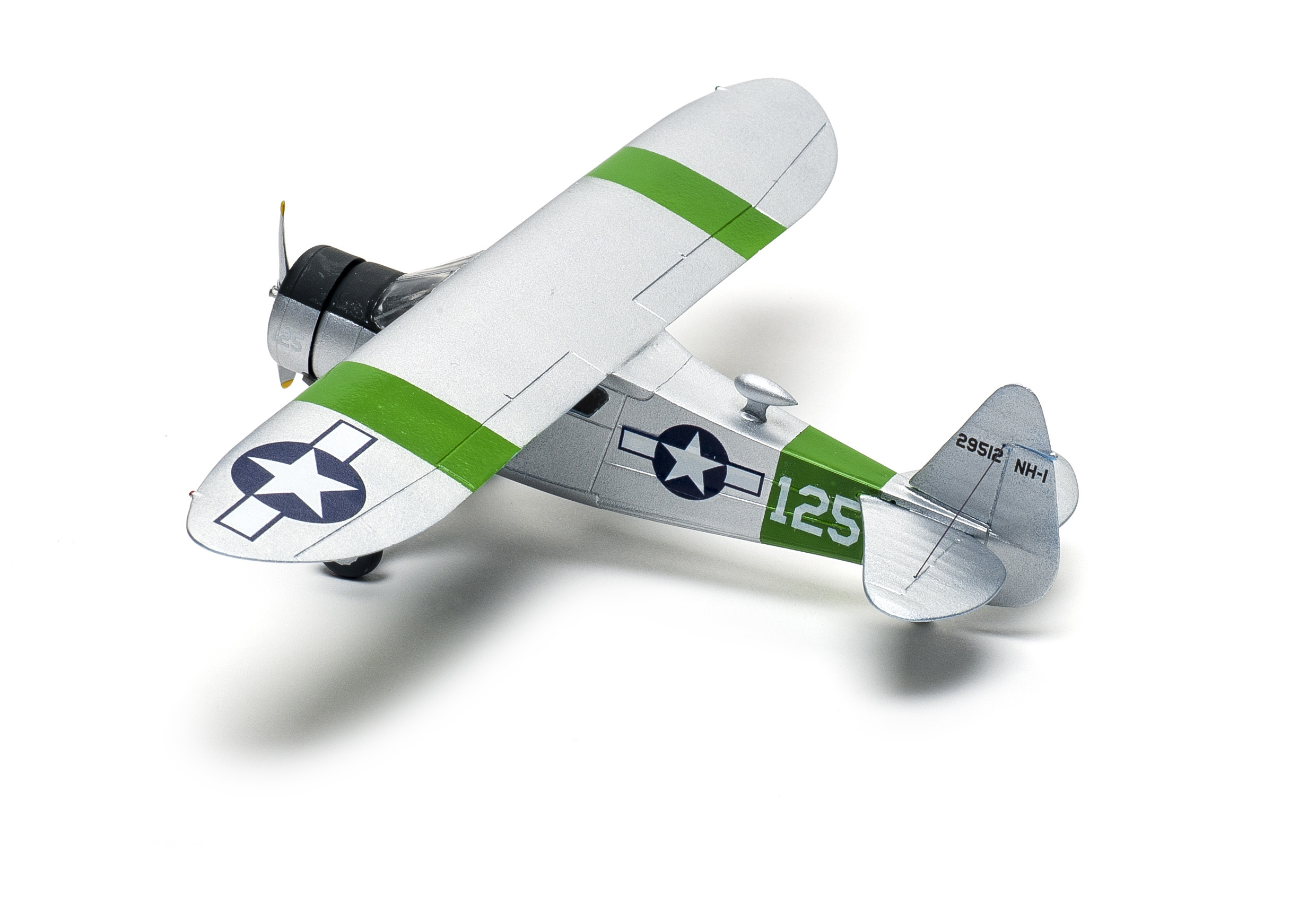

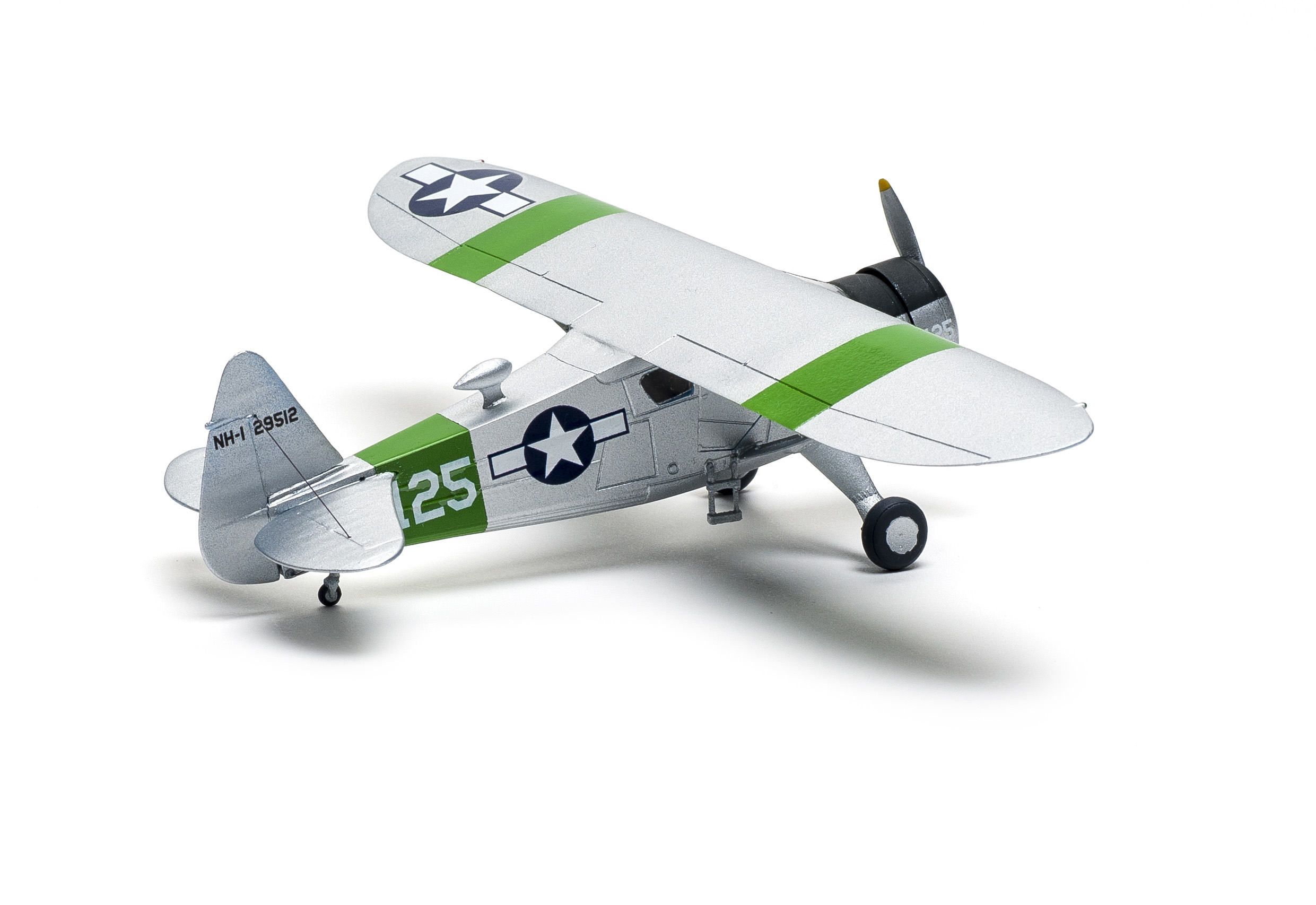

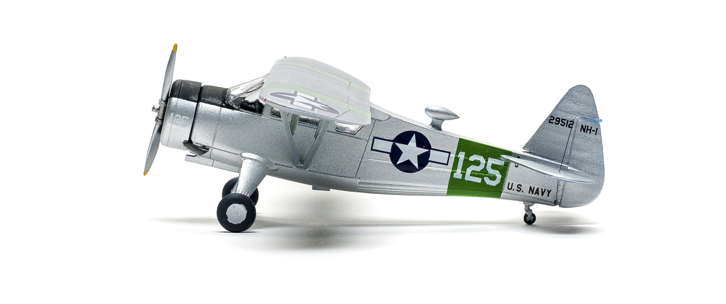

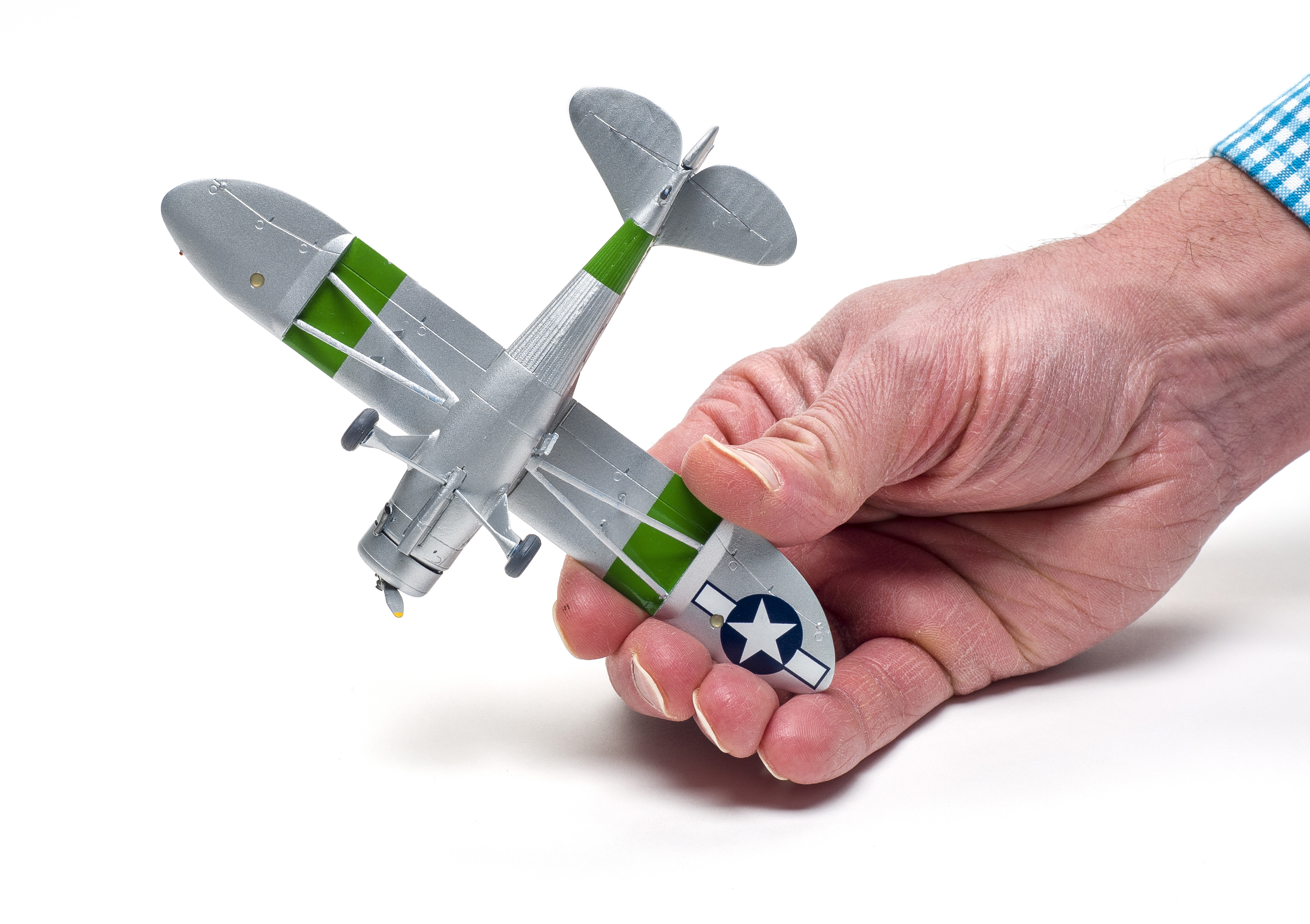

I had chosen the Navy NH-1, which includes green stripes on the wing — Testors willow green — so I left the struts off for masking. Otherwise, the full airframe was assembled and painted, leaving off only the prop and petite tail wheel. After first spraying the stripes, I masked them and applied Tamiya flat aluminum.
Decals were trimmed as closely as possible, then applied; they settled down nicely. After the window masking was removed, I added simple rigging lines at the tail — not shown clearly on the artwork or mentioned in the instructions — and the Howard was finished.
I spent a little more than 10 hours on this charming little kit and, while I wish it had at least one civilian decal option, it was an impressive and simple build. I will have to try some more of Dekno’s forgotten flyers, like a Stinson Reliant, or …
