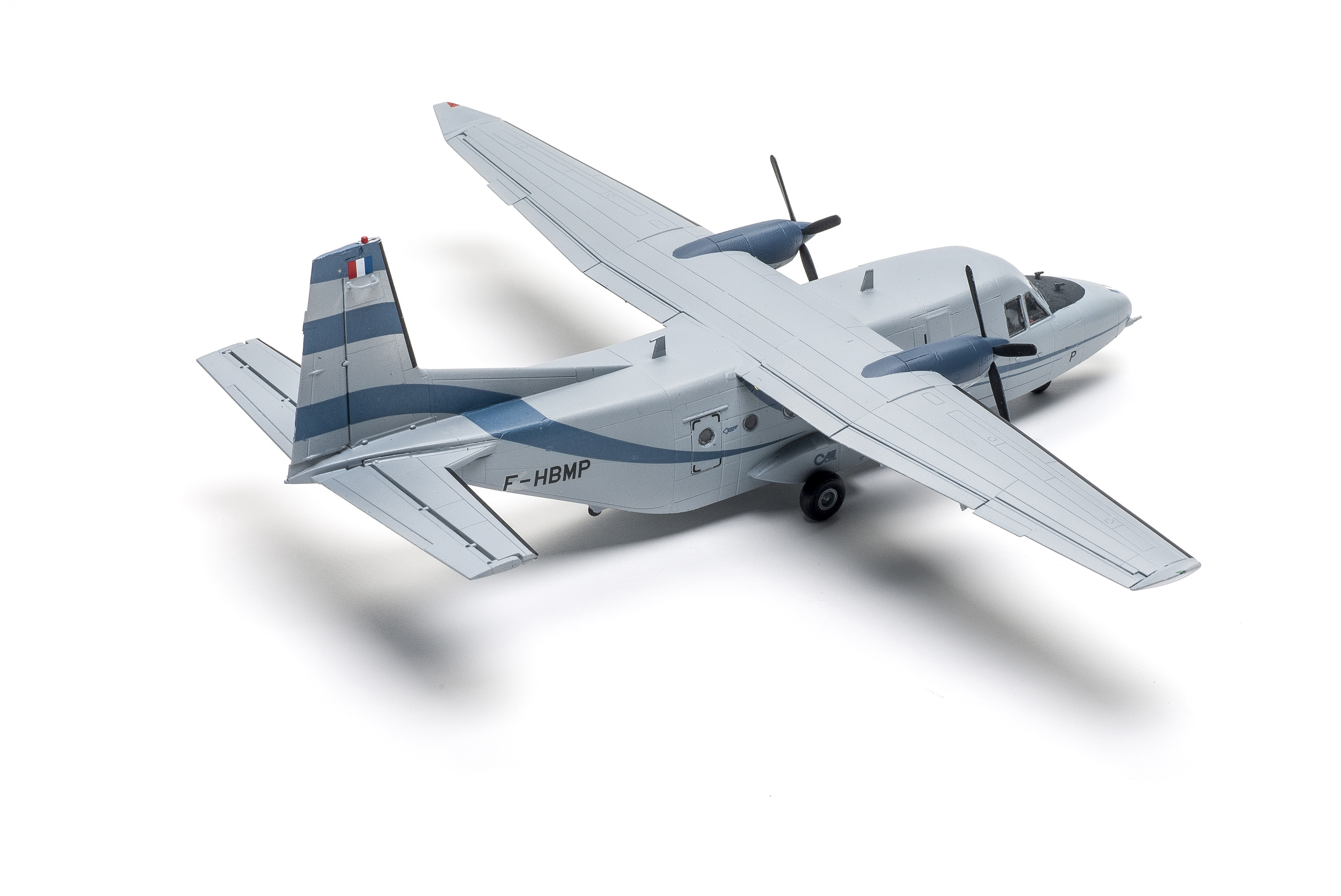

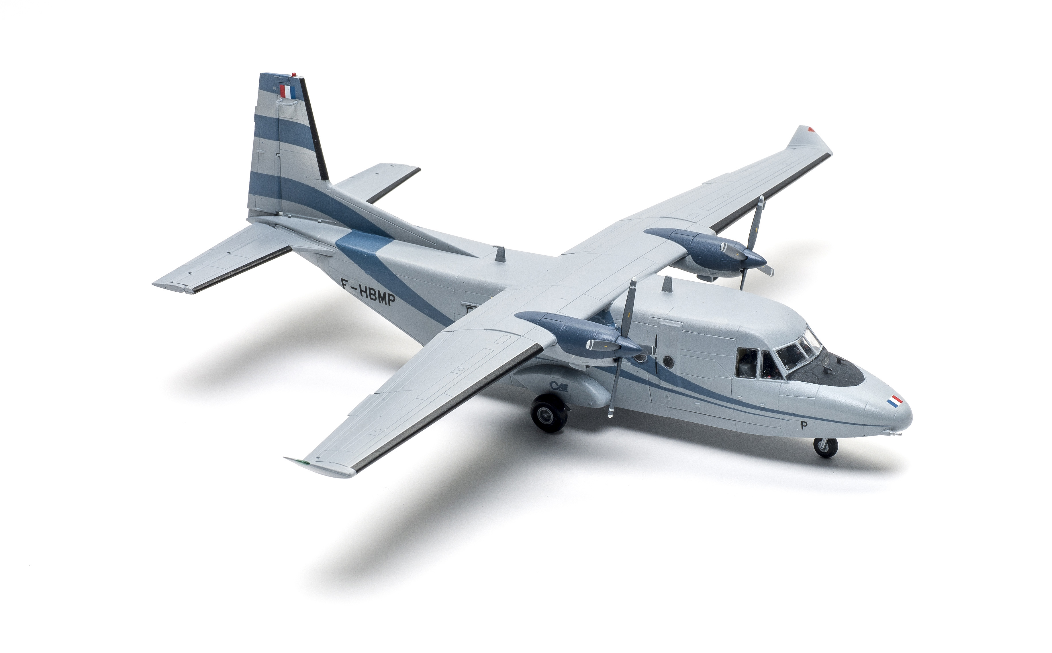

As molded, the fuselage represents the short-nose 100-series airframe. To convert it to the long-nose 300 series, I carefully cut halves along scored lines behind the cockpit. A stepped tab is left at the seam to align and attach the new nose pieces. That is one of the hardest things on the build.
Before joining the fuselage halves, 13 cabin windows must be inserted. Fear not: There are small tabs on each one to aid gluing them in place. I secured each with a drop of super glue on a toothpick. Then I masked each window with a drop of white glue. It is easily removed with a hobby knife or toothpick after painting.
The simple cockpit includes good decals for the instrument panel.

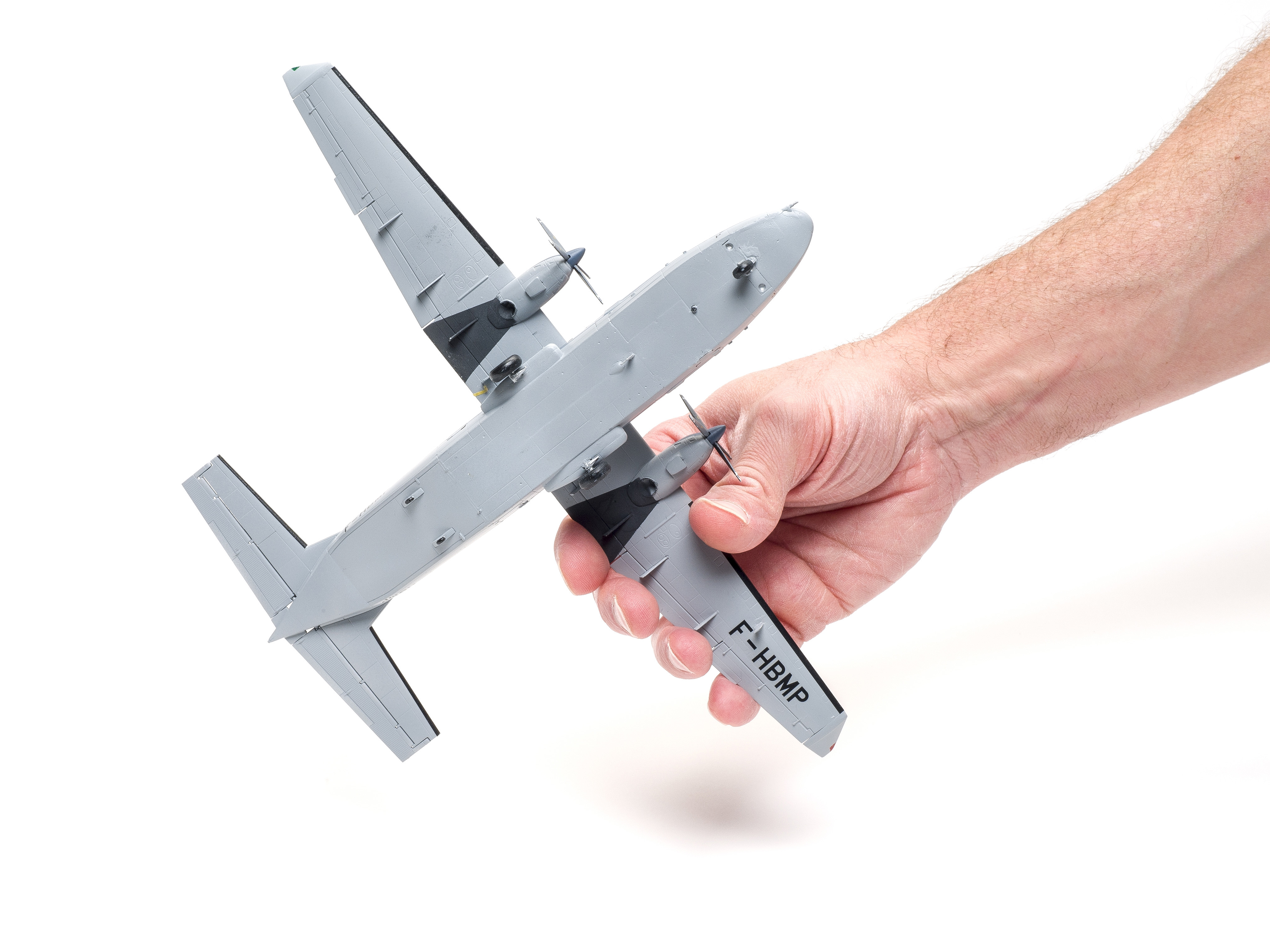

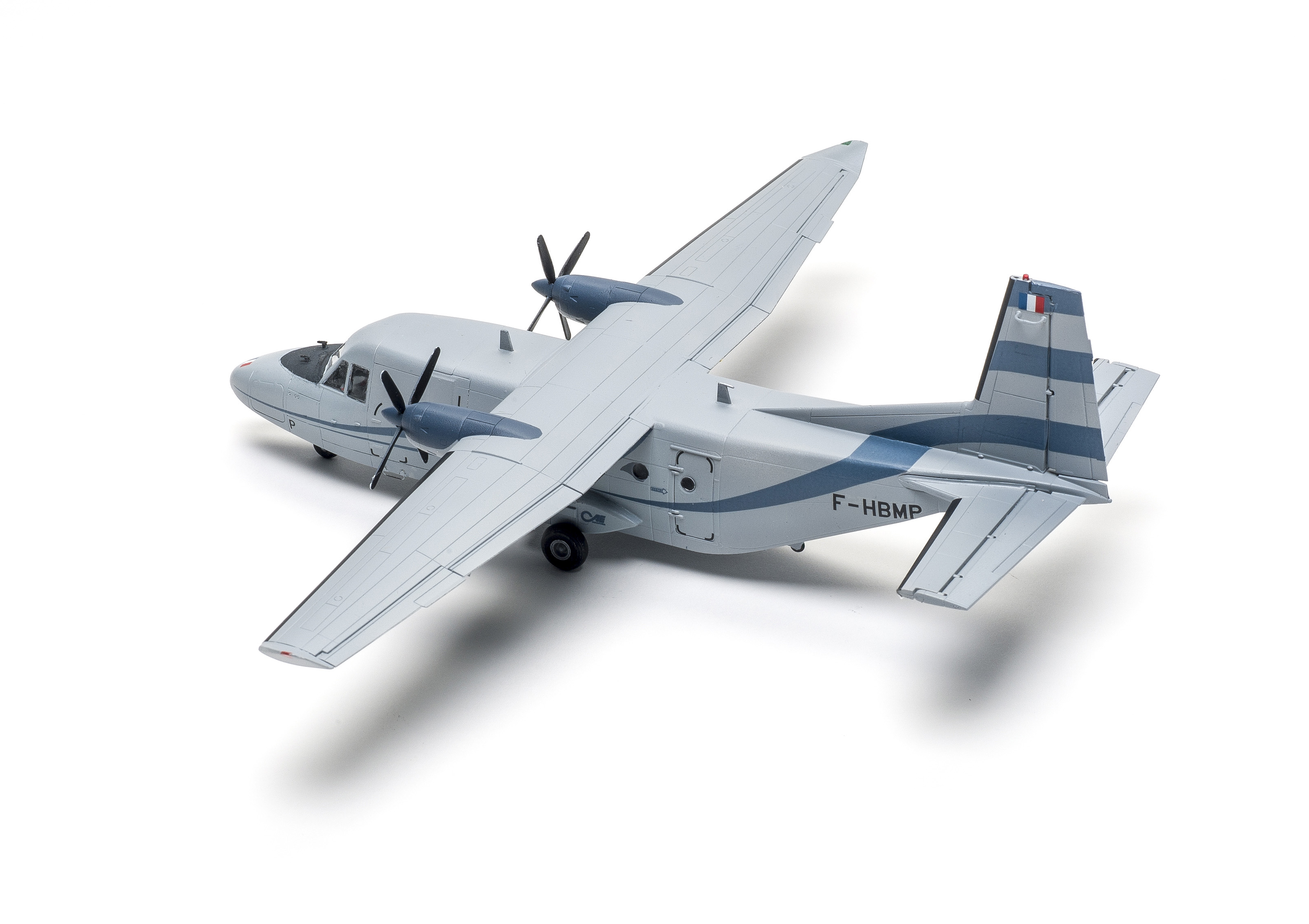

The join between the high-mounted wing and fuselage was perfect and needed no filler. The kit has the option for open doors but since there is no interior I left them closed. A open rear cargo ramp would have been nice with some interior detail. The tricycle undercarriage went together without argument.

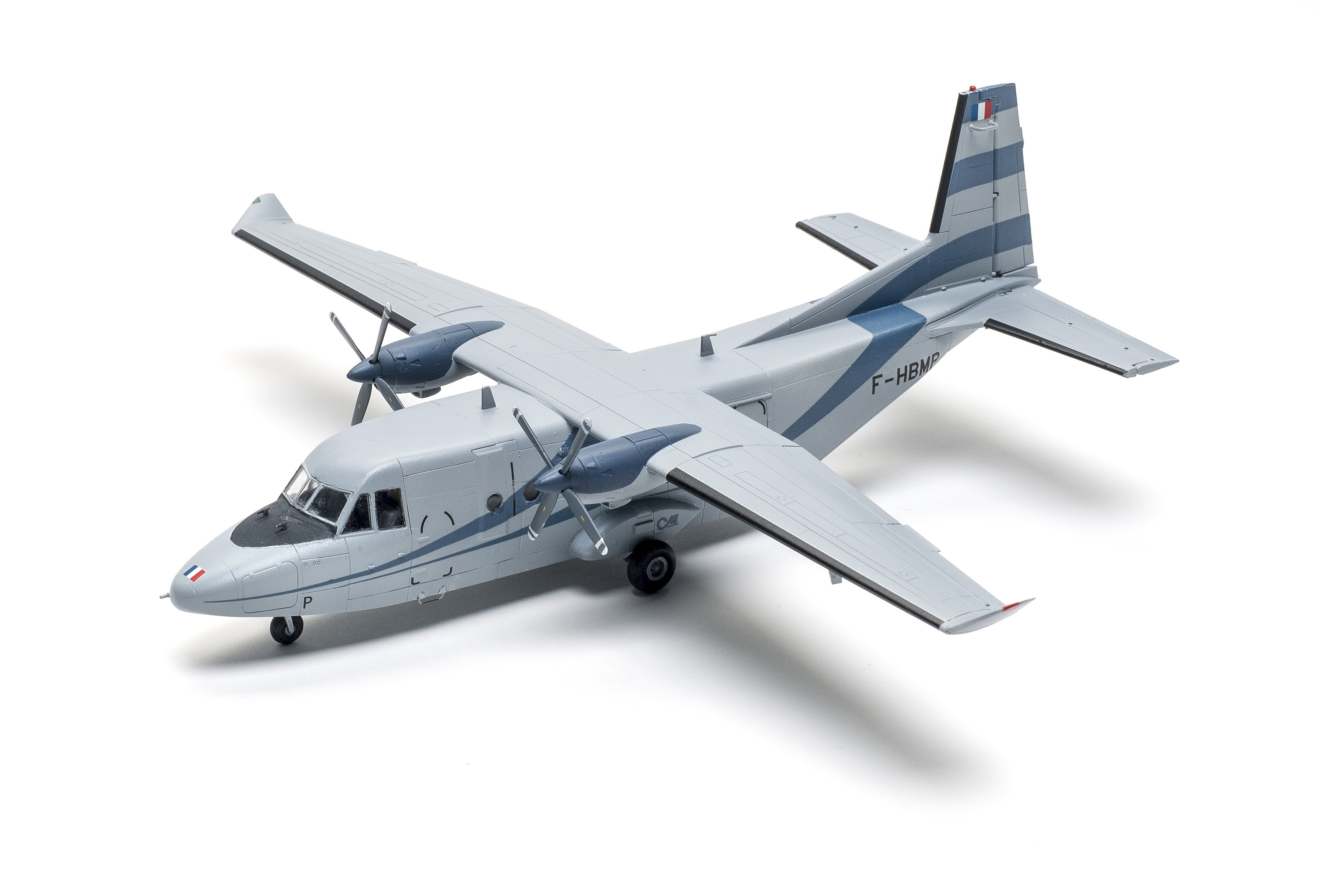

Decals provide markings for four French C-212s, two from the French air force flight test center, and two civilian aircraft. I painted my model with Testors light gray and U.S. Navy blue to replicate the wild paint scheme on the aircraft from French CAE Aviation.
Unfortunately, the decals for the stripes were extremely fragile and came apart. The other decals are printed by Cartograf and performed perfectly.
I spent about 43 hours on my C-212 Aviocar, mostly because of the conversion surgery and decal problems. I recommend that less experienced modelers stay with the 100 version.
