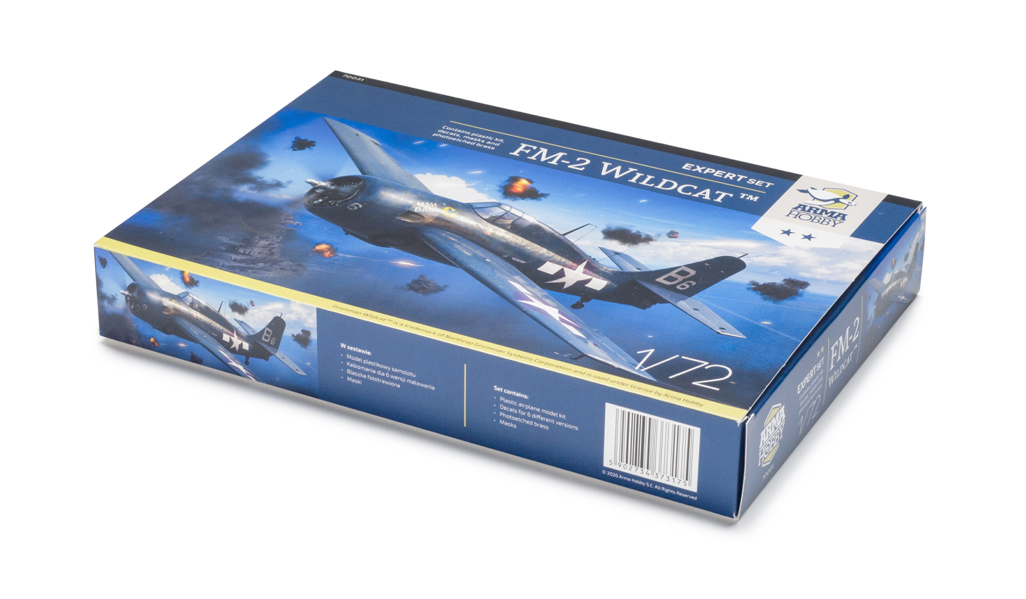

This “Expert” boxing includes photo-etched metal (PE) details, masks for the canopy and wheels, and decals for six marking options. These include two in overall dark sea blue, two in the grey and white “Atlantic” scheme, one tricolor option, and a camouflaged British Fleet Air Arm Wildcat Mk.IV.

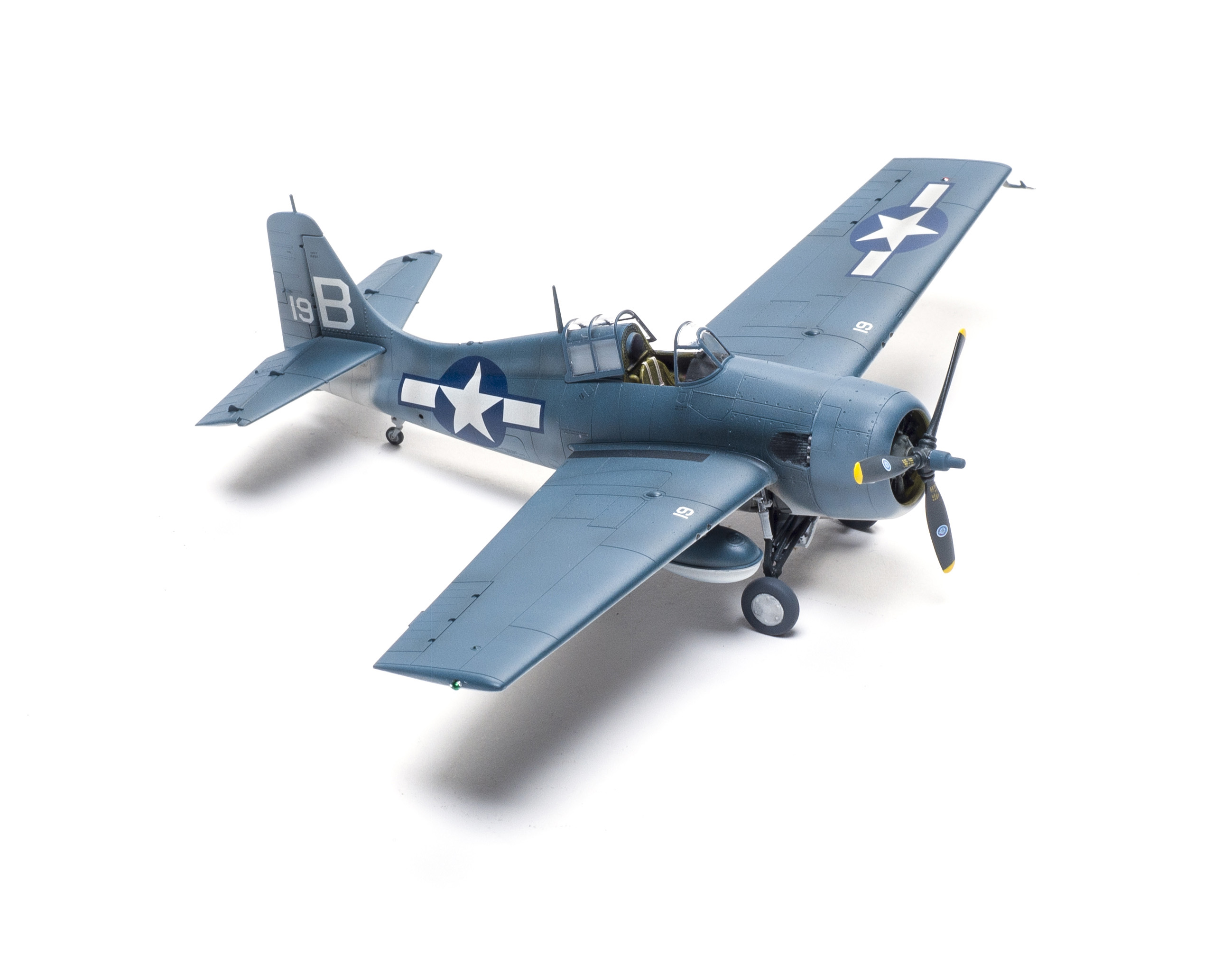

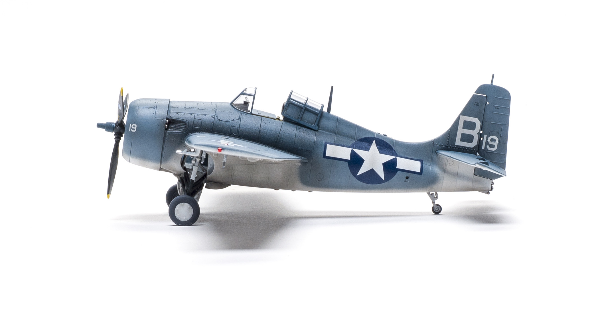

Arma has you assemble the main center-line gear mount on the retraction arms by bending the arms to the correct angle — hard to determine without the gear legs in place. Try as I might, I couldn’t get the auxiliary struts to fit; I may have trimmed them too short. I attached the main gear to the forward bulkhead once it was in place: a tense step with lots of room for error. In the end, I had a beautifully detailed assembly.

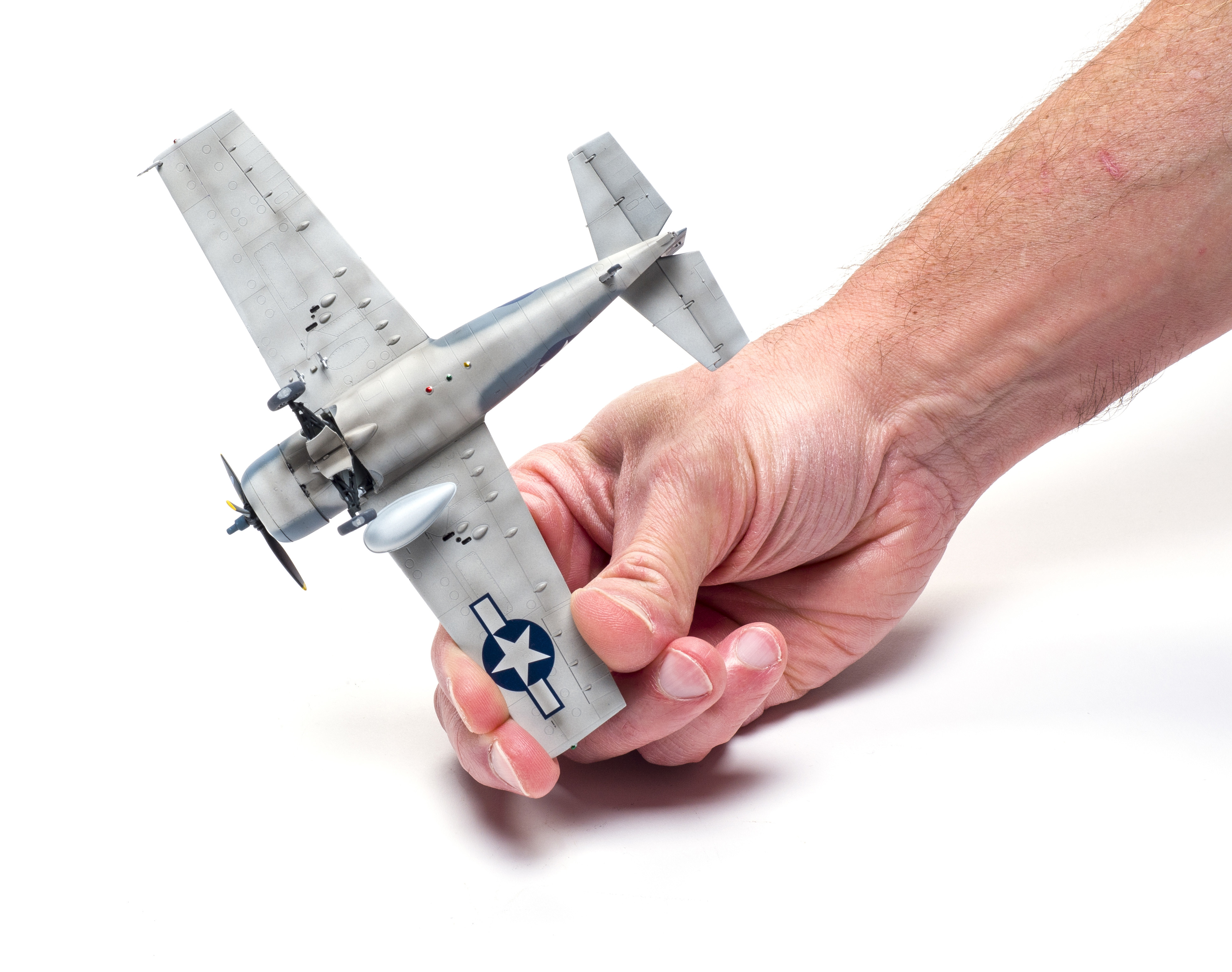

I had no problem building the wings. Don’t forget to open the holes for the underwing rockets if needed. Tiny stencil decals are provided to finish the rockets. The kit provides two drop tanks, although the painting instructions direct you to mount one under the starboard wing only, which was a common practice based on photos.

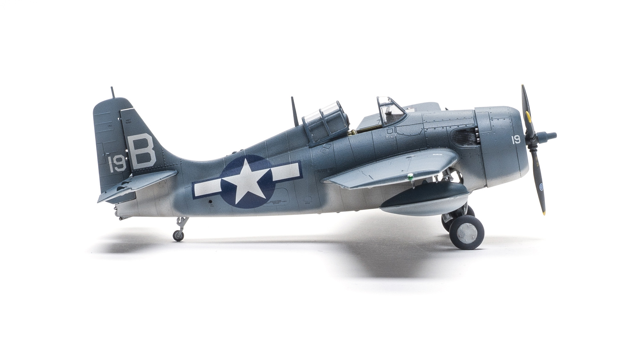

To finish, I added the tiny to the panel shroud, and attached the windscreen. The canopy masks fit well and are a welcome addition.

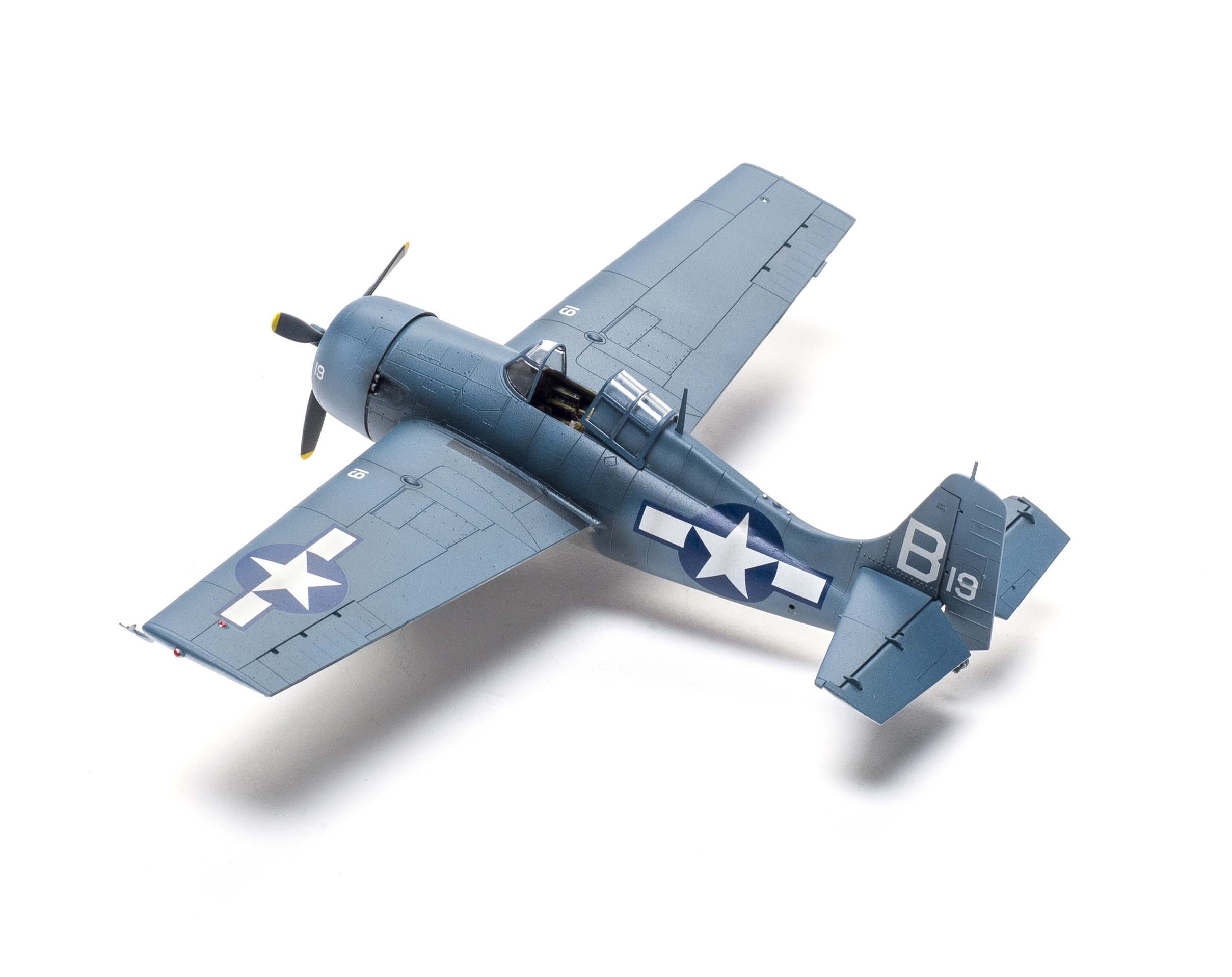

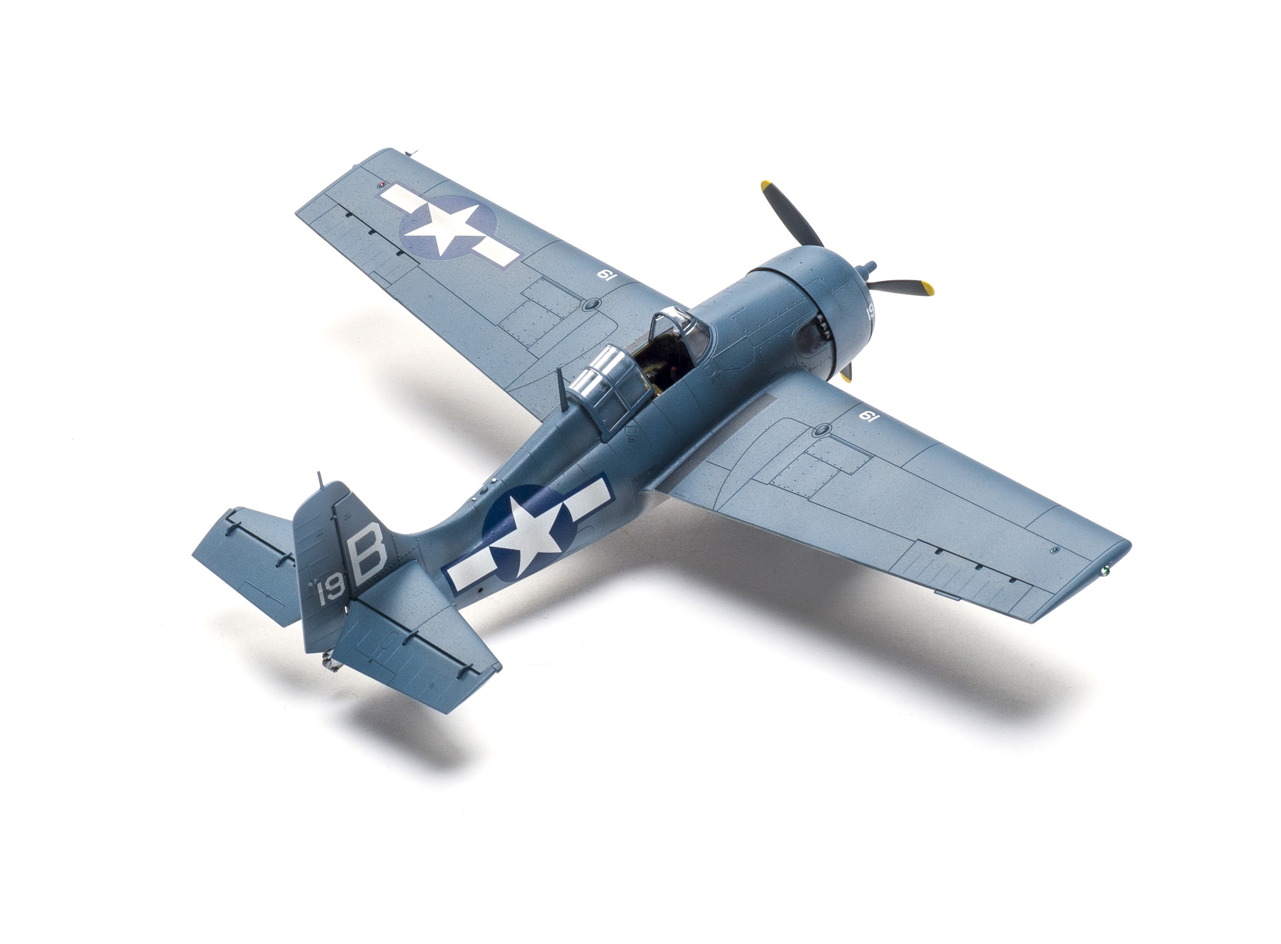

I painted my Wildcat with Tamiya white (XF-2) and medium blue (XF-18), and Hataka Orange Line intermediate blue (No. C027).
The decals went on without problems and the white areas are opaque enough that there was no bleed from the underlying colors.
Stencils are supplied in both white and black, depending on your scheme. Be aware that the text is missing from the profile for the first option, Mah Baby, but it is easy enough to apply the stencils using the profile for the other overall sea-blue option.
A quick 17 hours and I was ready to land Arma’s FM-2 in my display case. The kit’s detail, finesse, and precise fit impressed me. Only the landing gear proved challenging, but some of that may have been my fault. This is one cool ’Cat for your collection.
