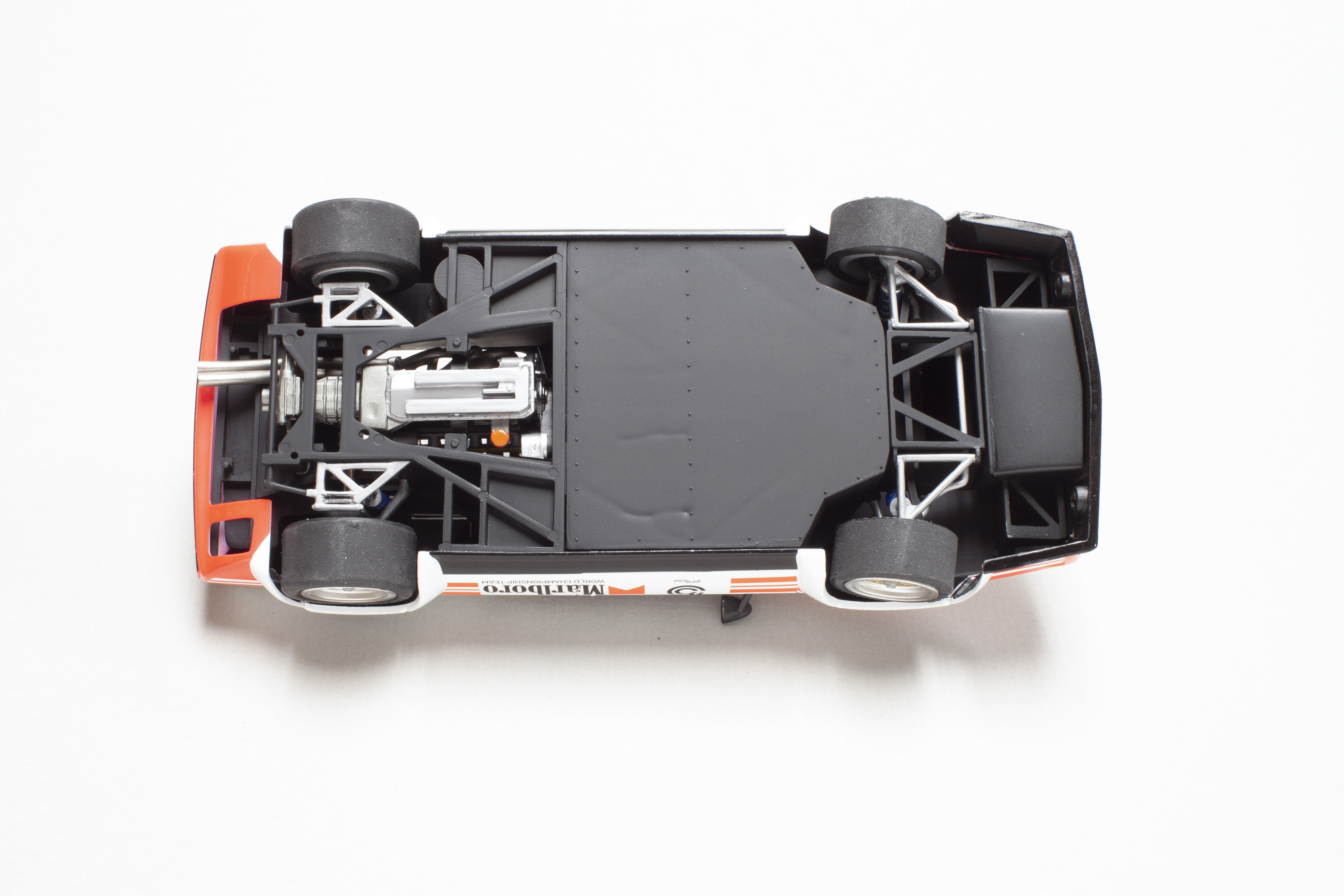

The 11-part fuel-injected 6-cylinder inline engine generally fits nicely. I drilled out the intake trumpets for improved realism and attached them early rather than waiting until the engine was in the chassis. I also deviated from the instructions by installing the engine after the lower subframe was attached to the main chassis. Sanding a little off the side of the alternator gave clearance with the chassis so the engine sat straight. The rest of the rear suspension went together without problems.
The straightforward front suspension has upper wishbones molded into the main chassis and lower wishbones molded with the subframe. The steering is designed to be movable with the tie-rod captured by mushrooming pins with a hot screwdriver. I found it stayed in place without modifying the pins.

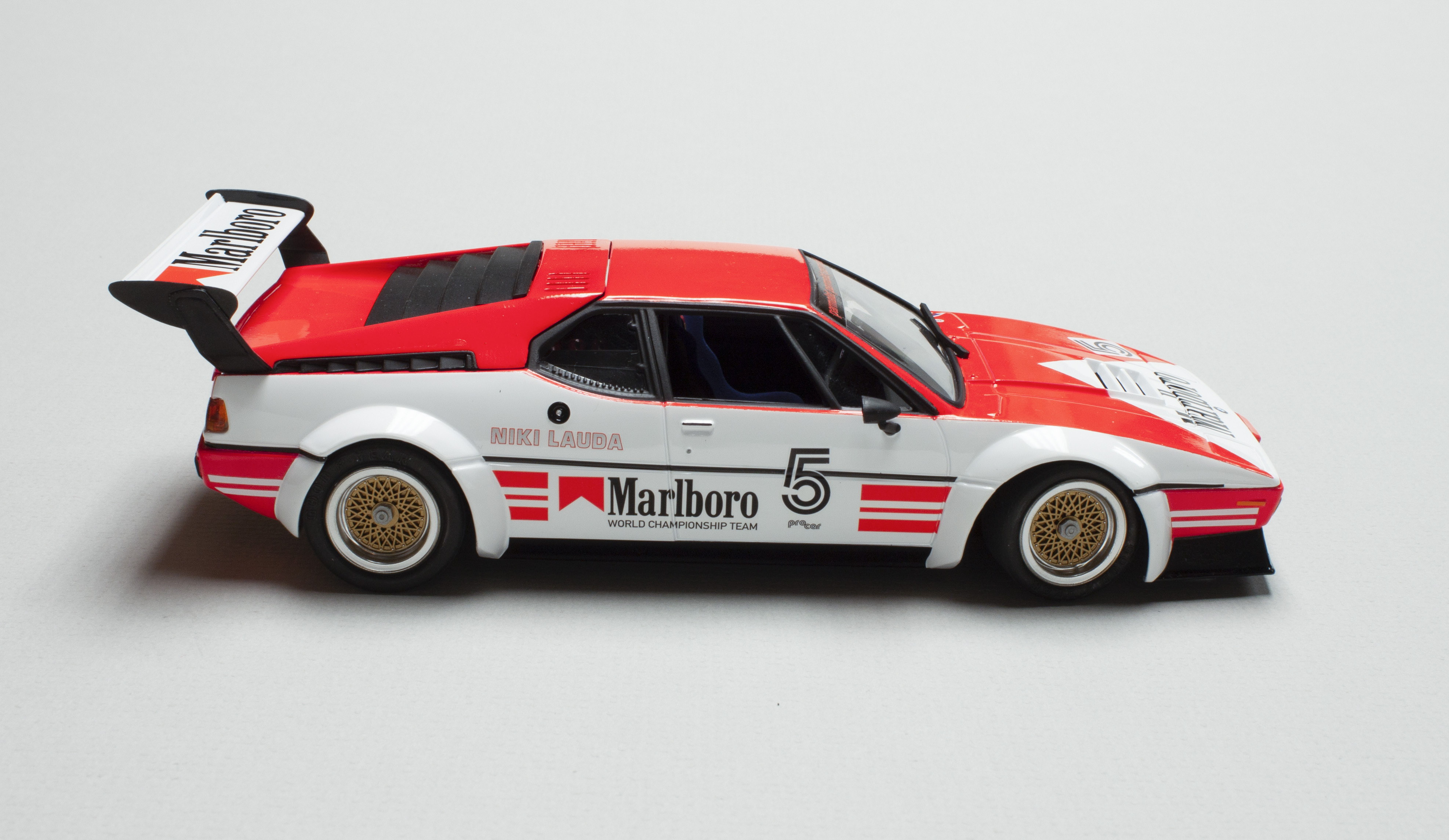

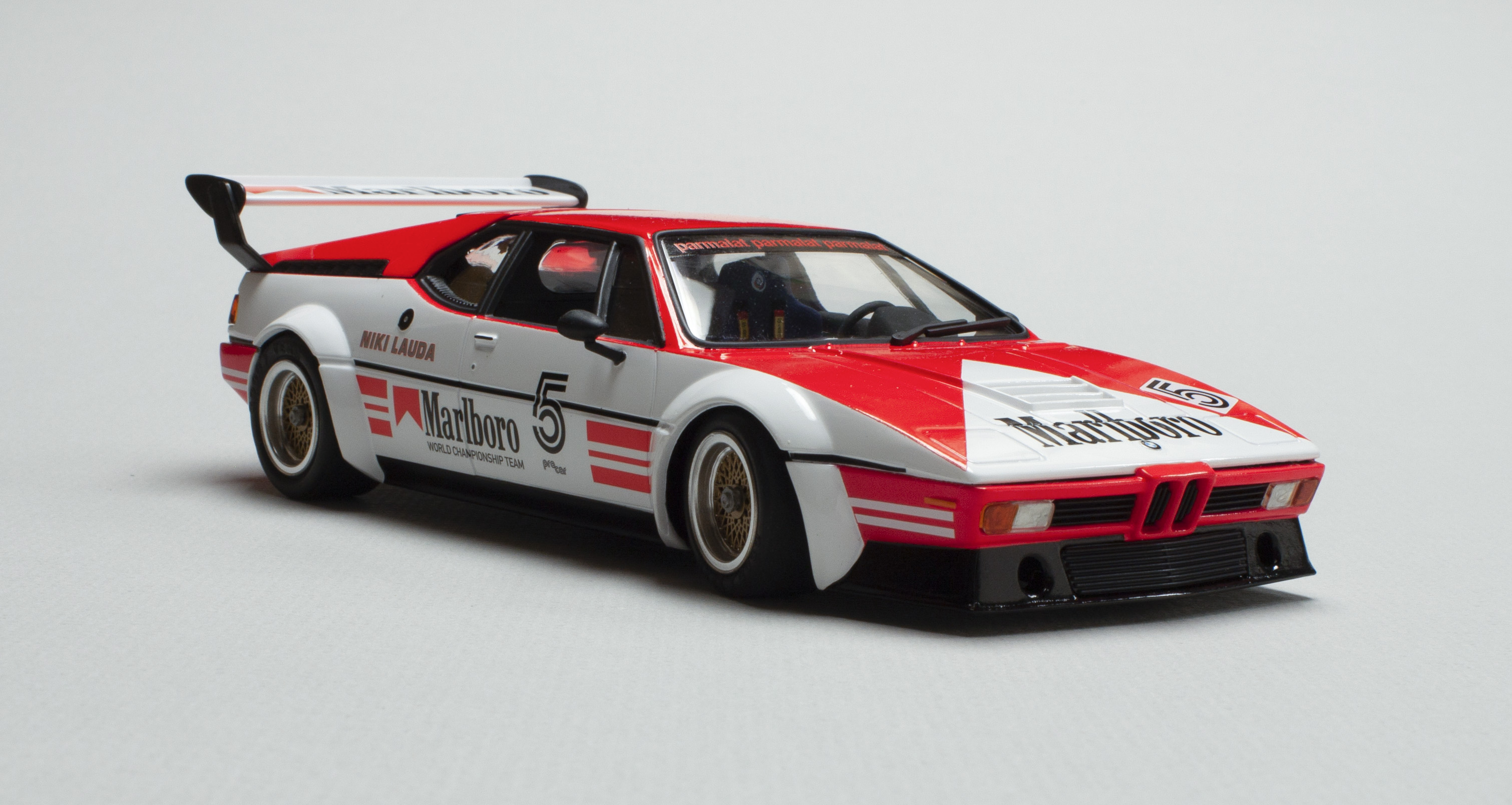

After cleaning up a few mold lines and filling a couple sink marks on the body, I attached the front and rear bumpers and sprayed Tamiya pure white (TS-26) for the base color. On looking more closely at the scheme, I realized masking would be easier with the bumpers off the body. So, I carefully cut the front bumper from the body. I left the rear in place, because a black separation line would hide any goofs. Tamiya fluorescent red (TS-36) is supposed to match the decals. I confess that I don’t have a lot of experience with this shade, but it seems sensitive density — apply too much and it just looks red, too little and it looks pink!
Be sure the surface is wet when sliding the decals on. They are very thin, and I had trouble finagling some of them into position.
