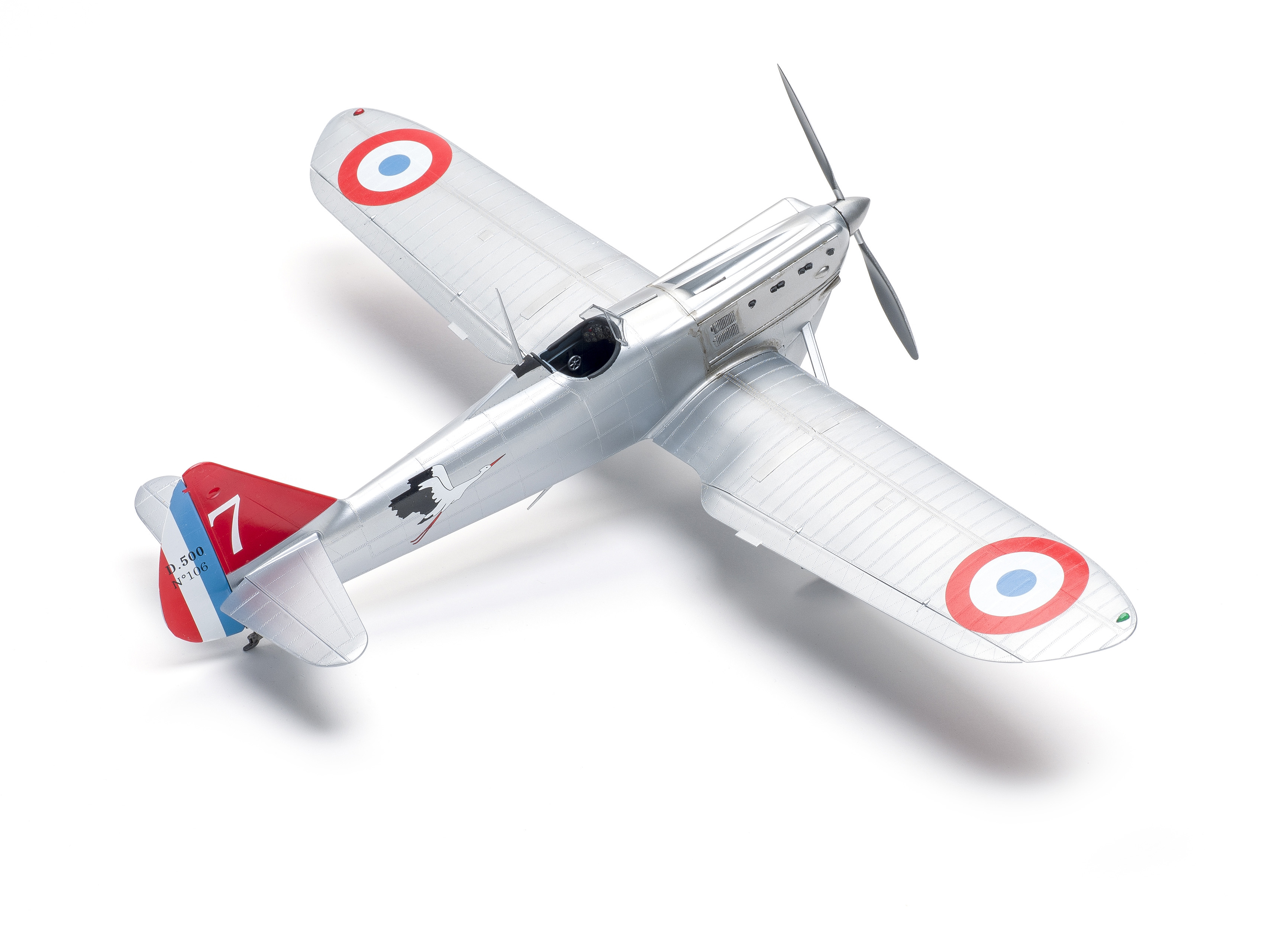

All control surfaces came as separate parts, and Dora designed joints that allow for razor sharp trailing edges. Unfortunately, this makes for some difficult seams to fill on the rudder and lower wings. I left the assembled rudder off to ease painting and decaling.
After trimming and truing the edges, the wing’s one-piece lower center section fit tightly to the fuselage, needing just a touch of filler at the rear. The upper and lower outboard wing sections fit very well and exhibit beautiful surface detail.

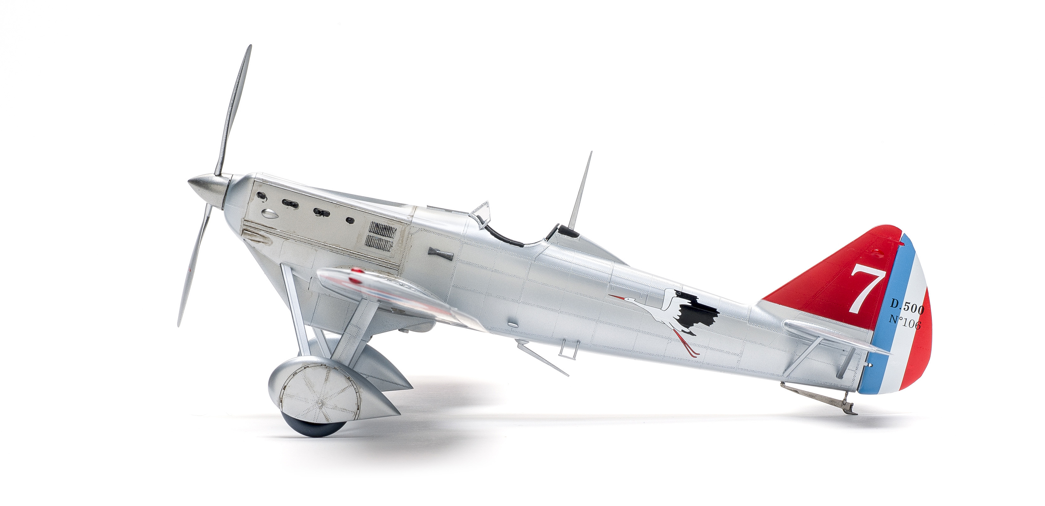

The fixed landing gear parts all fit nicely and the attachment points align everything perfectly. I bored out the axle holes in the wheels for better fit.
An antenna mounted on the lower fuselage seemed like it would interfere with the ground and many photos show it folded. So, I cut it at an angle at the base and reversed the angle so it folded back towards the fuselage.

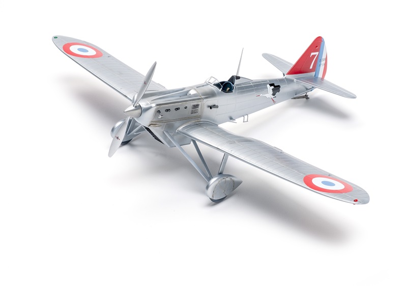

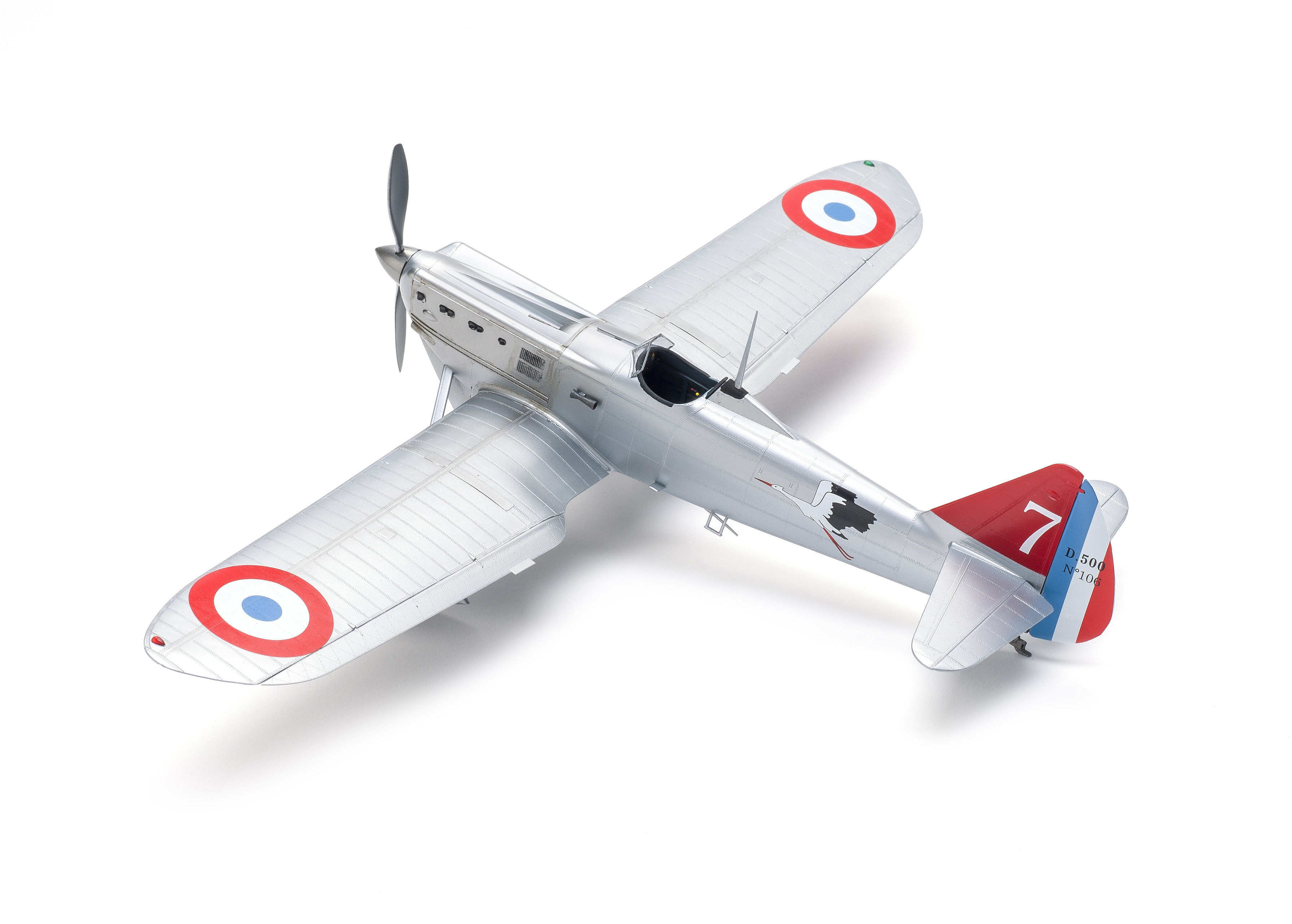

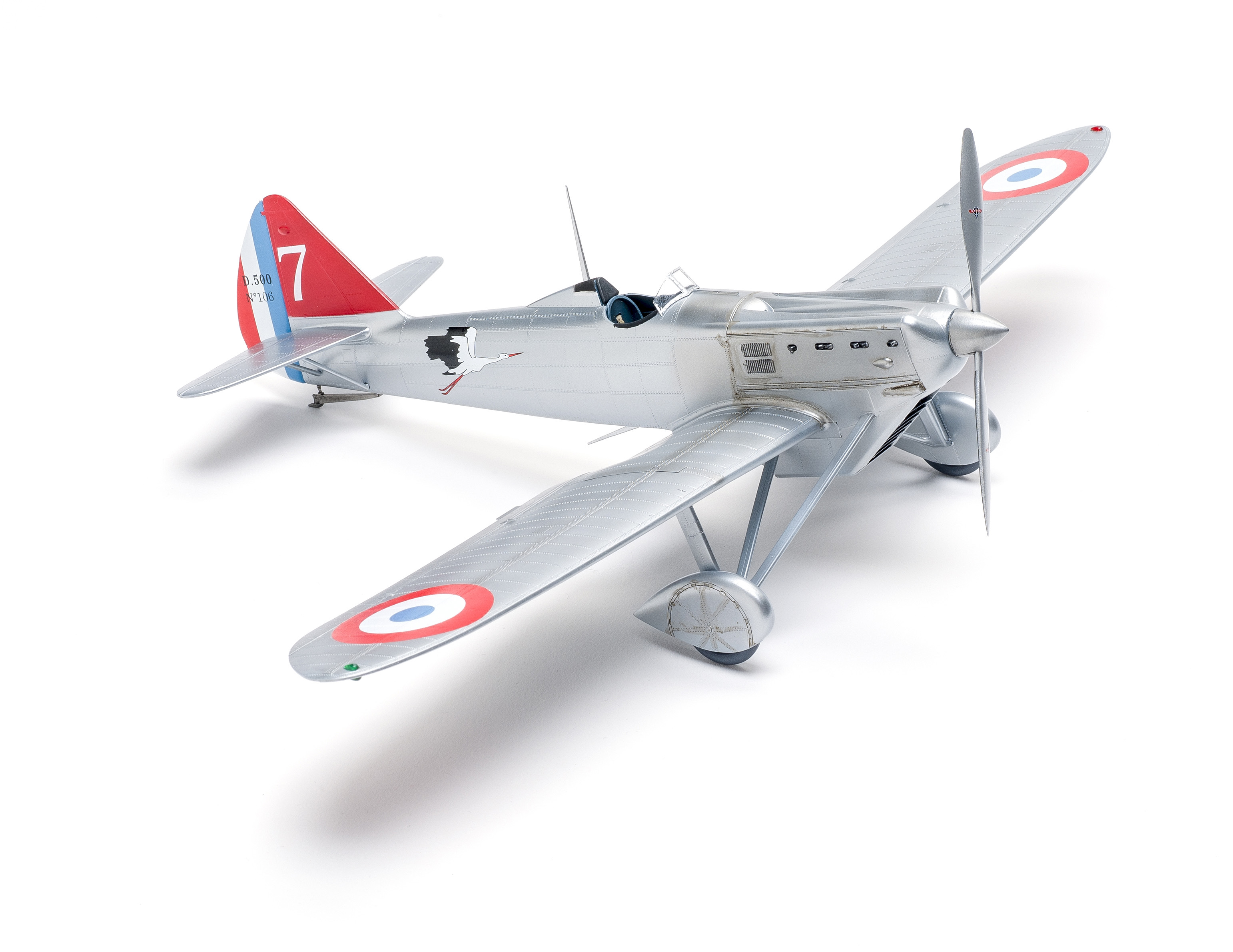

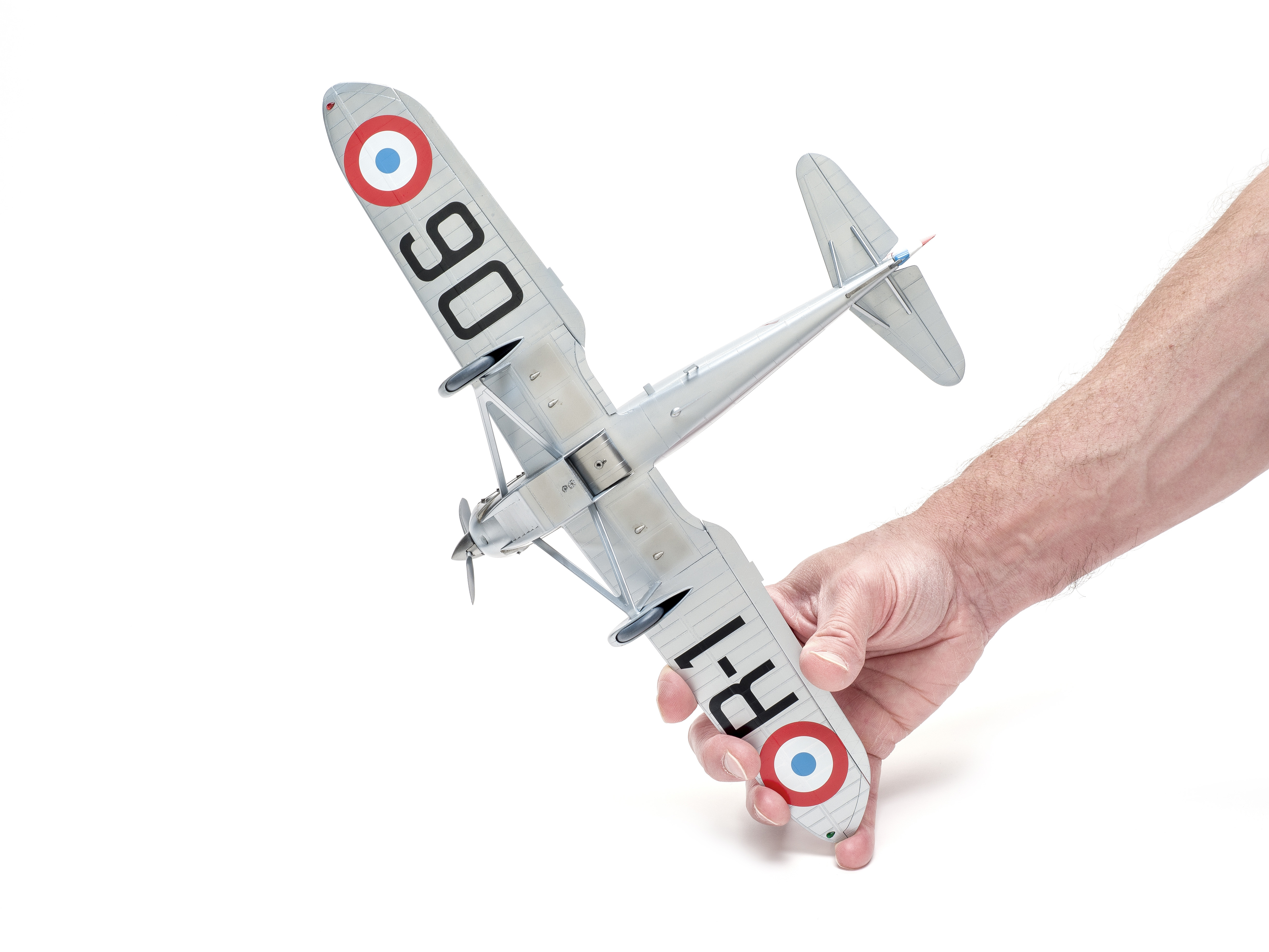

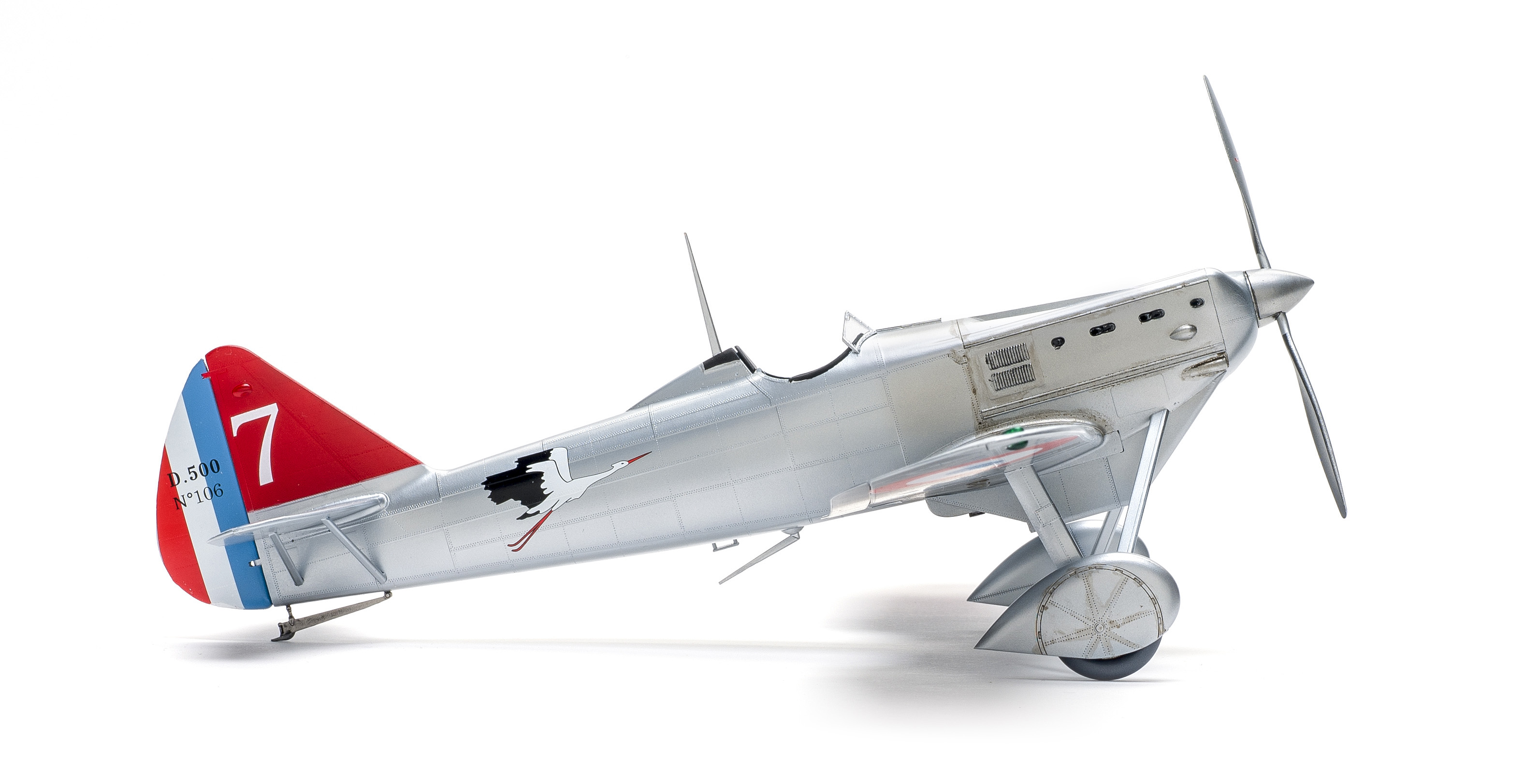

All four marking options included go over natural metal, but the national insignia and squadron markings provide plenty of color. I painted my D.500 using Alclad II aluminum and varied the look with dark aluminum for the cowl panels and the spar caps on the wings.
The decals performed flawlessly and settled over surface details with a little heat from a hair dryer and decal setting solution. Be aware that the second decal option shows an alternate pattern of exhaust ports that are not included in this kit.
My petite French fighter took an enjoyable 18 hours to build, highlighted by outstanding design and fit, and it’s a Grade A first effort in 1/32 scale by Dora Wings.
