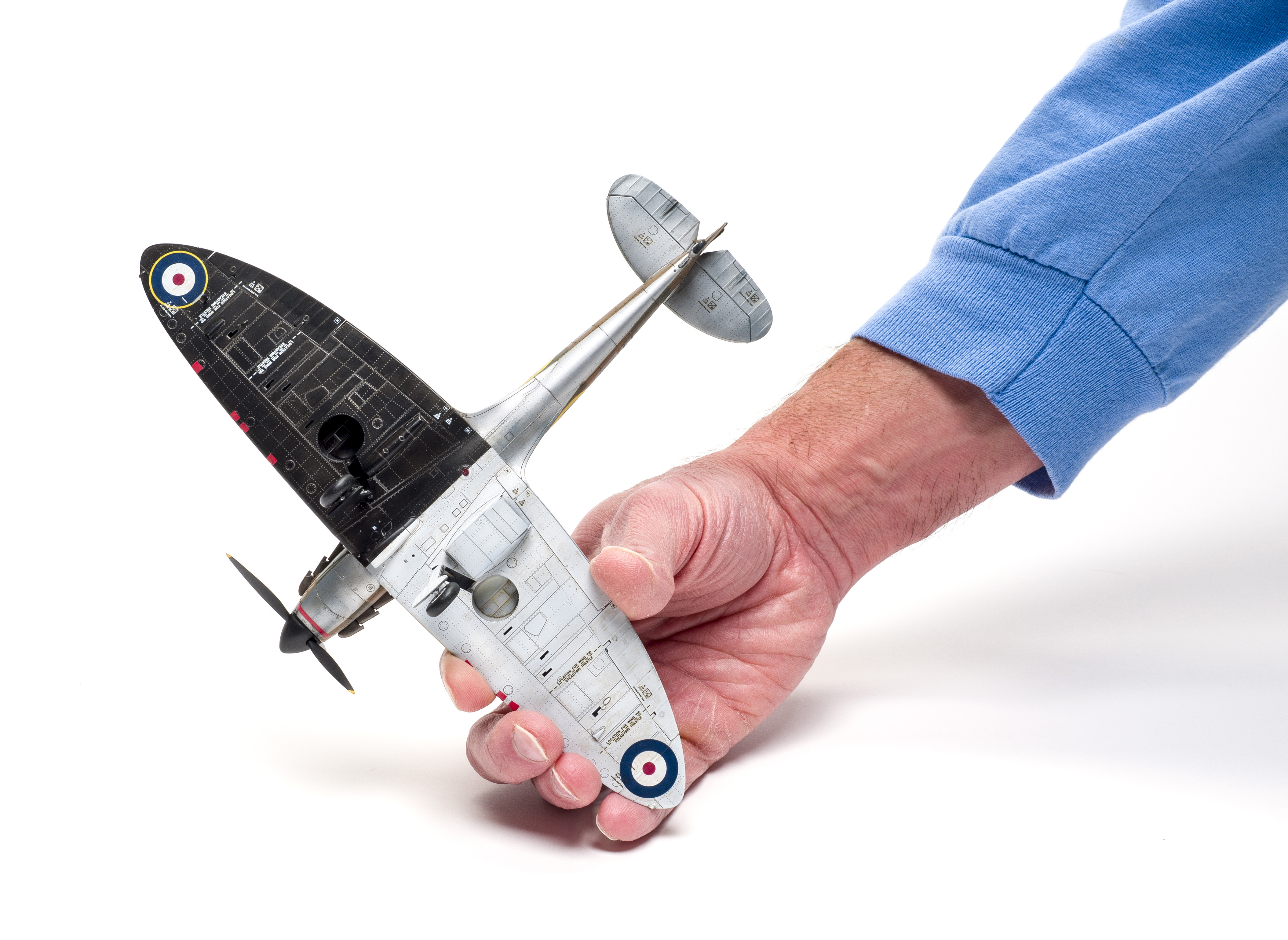

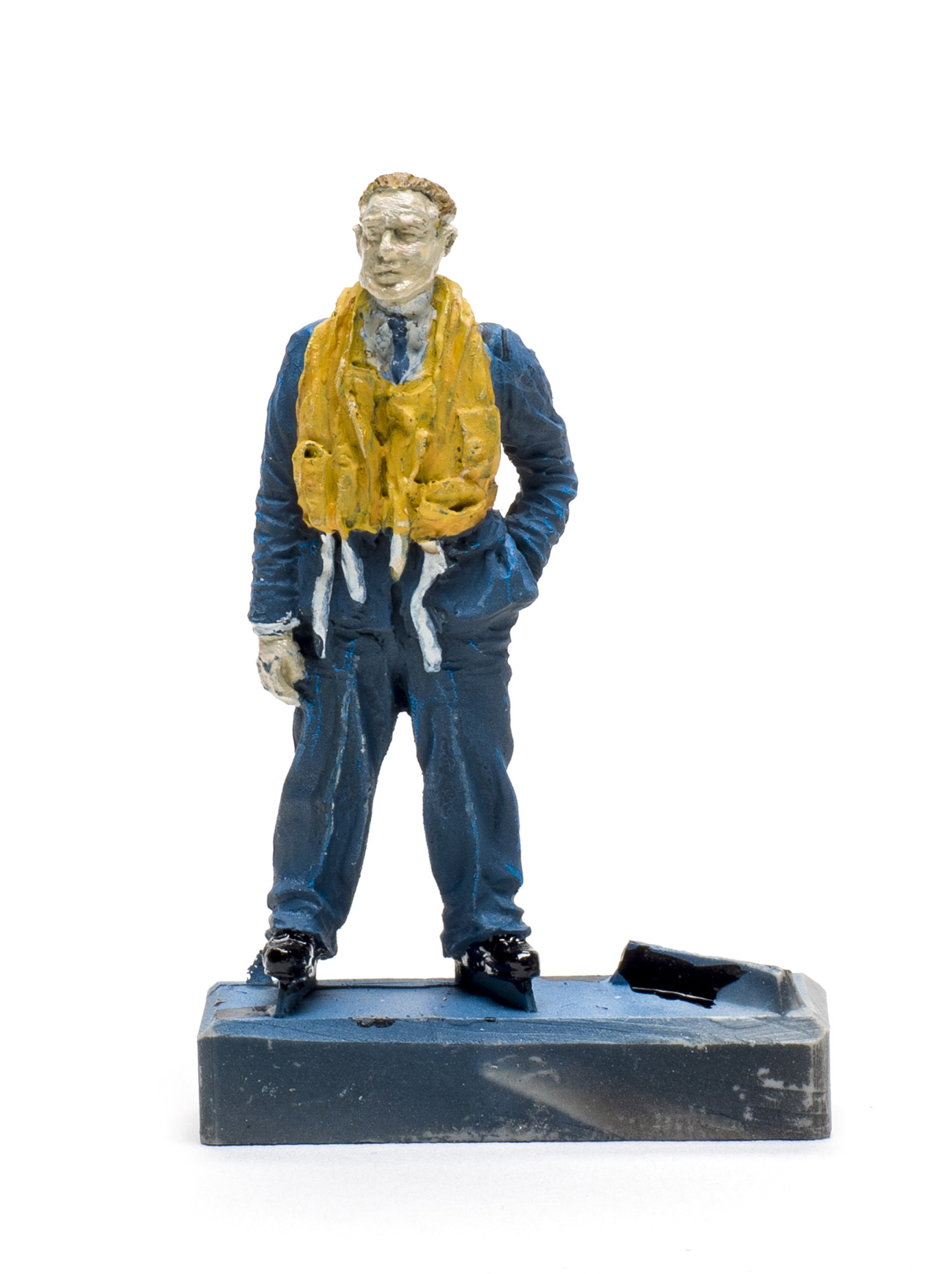

The initial kit, Tally Ho! The Spitfire Story, is a limited-edition dual-combo that includes two full kits and a resin pilot. There are more than 500 parts here — 263 for each airframe — and the stunning surface detail comprises recessed panel lines and both recessed and raised rivets as appropriate. The recessed rivets on the wing are so fine that I can see them but can’t feel them with my fingertip.
At first glance it appears the two sets of part trees are identical, but the fuselages differ. Optional parts abound: four props, three seats, three styles of canopy, two windshields; I could go on, but you get the point.

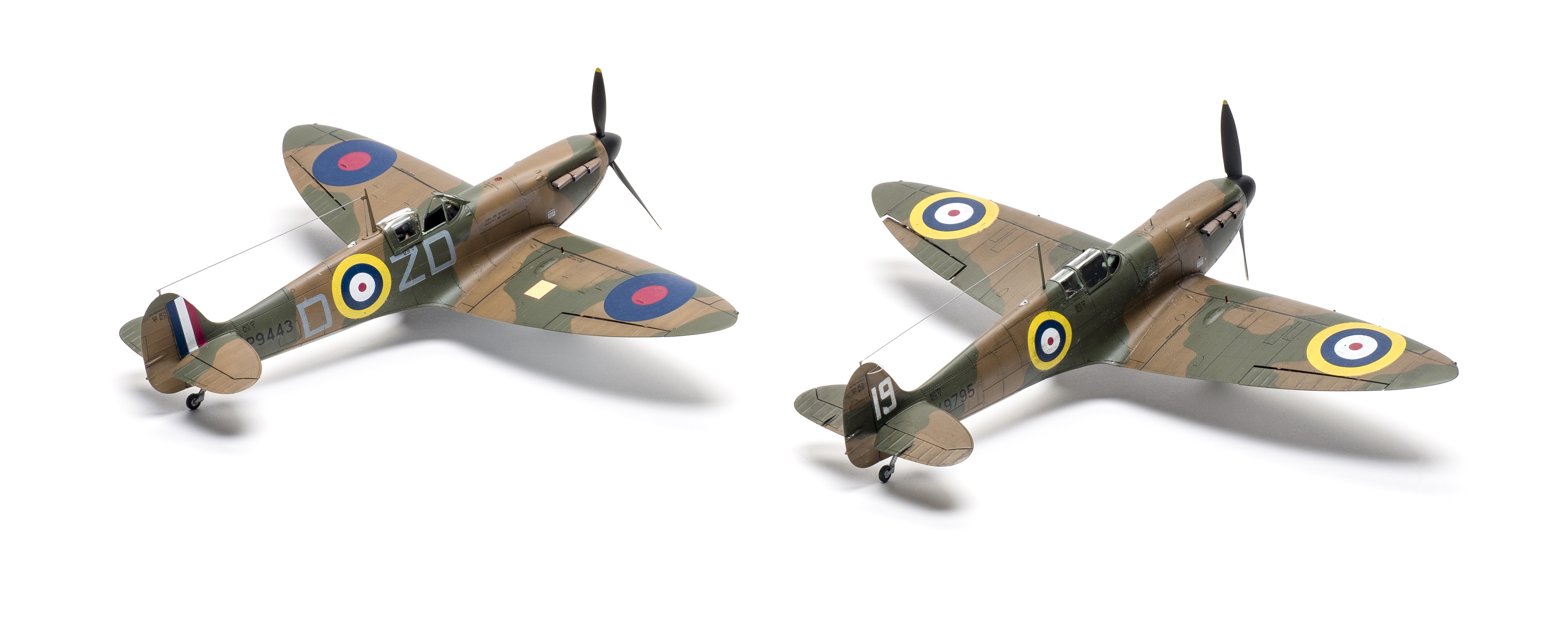

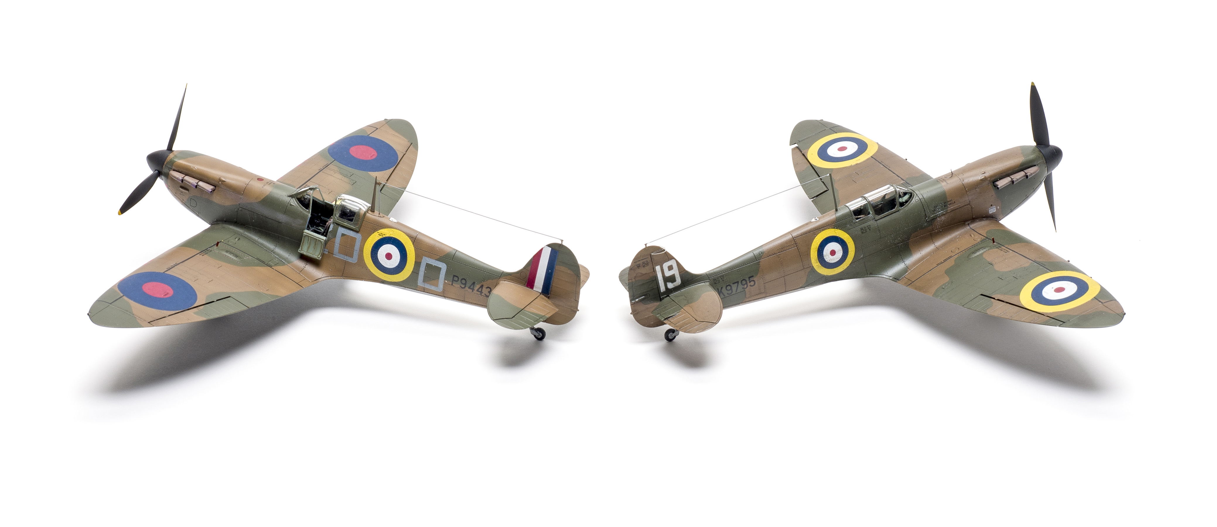

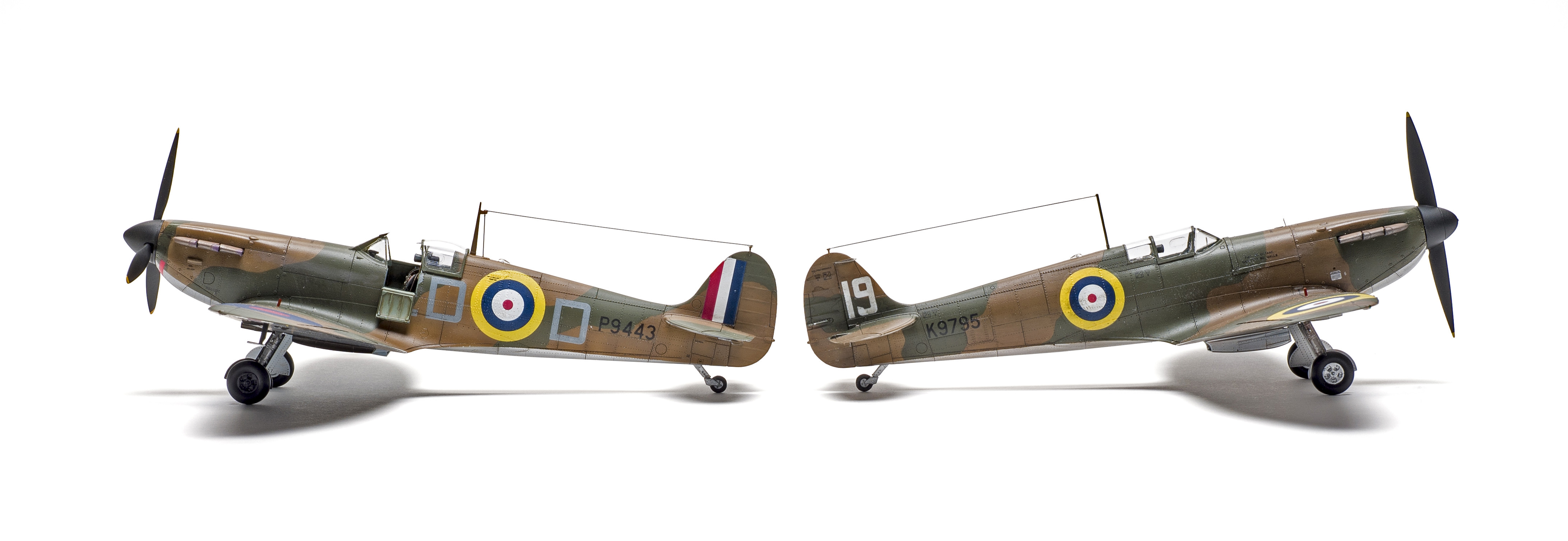

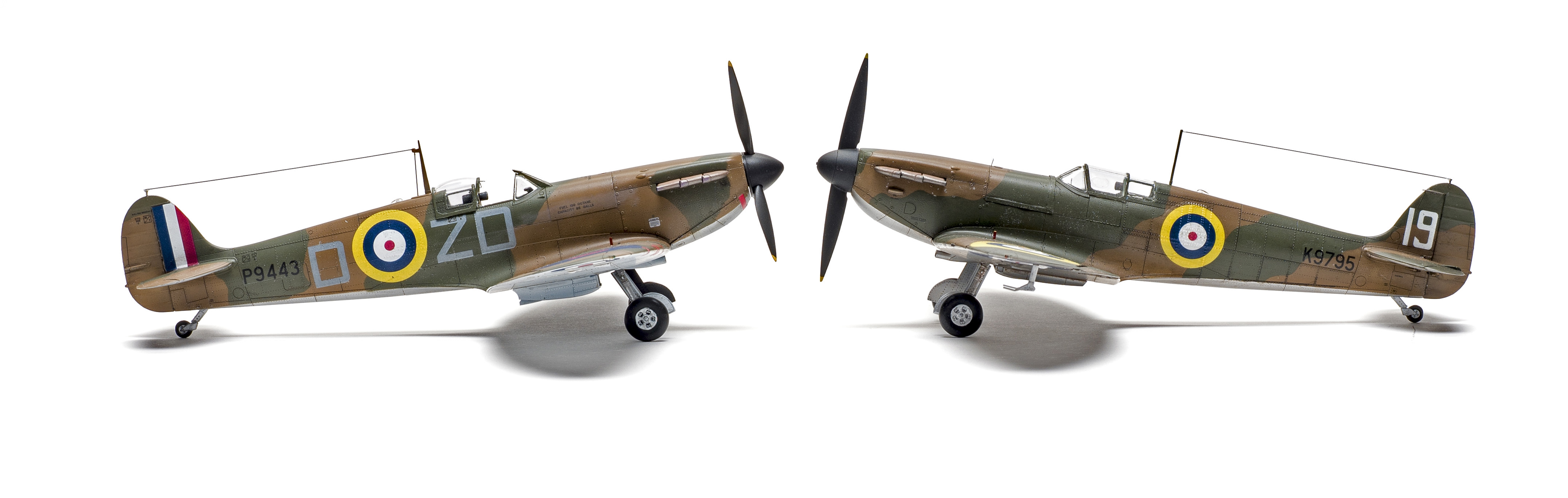

I needed to decide which planes to build before starting. I chose options A and F to highlight differences between the 1938 and 1940 versions. I was concerned that the options would not be called out until the marking diagram, but Eduard clearly labels the options for each airframe throughout the instructions. (I did finish construction of airframe A before starting on F so I wouldn’t get them confused.)

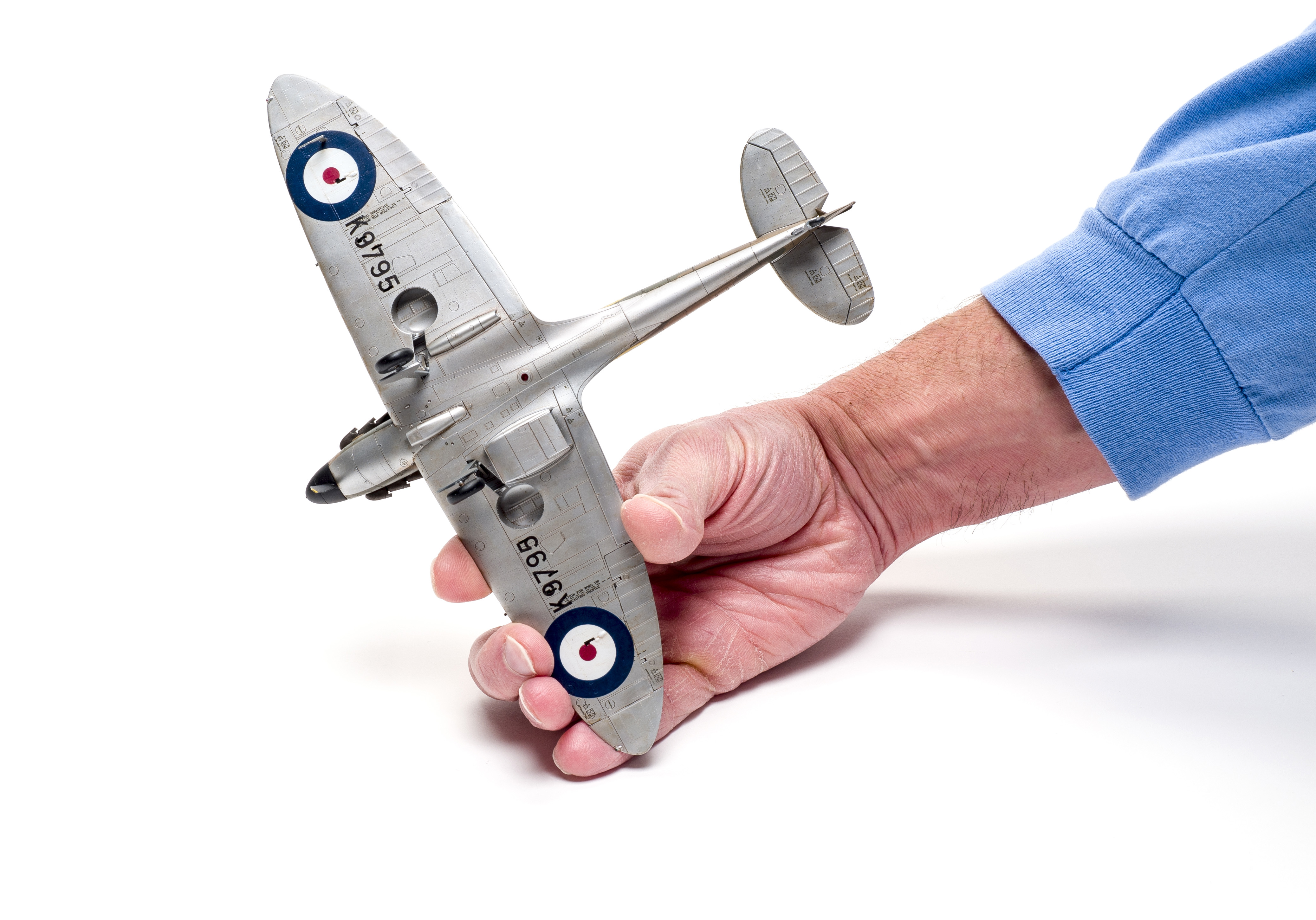

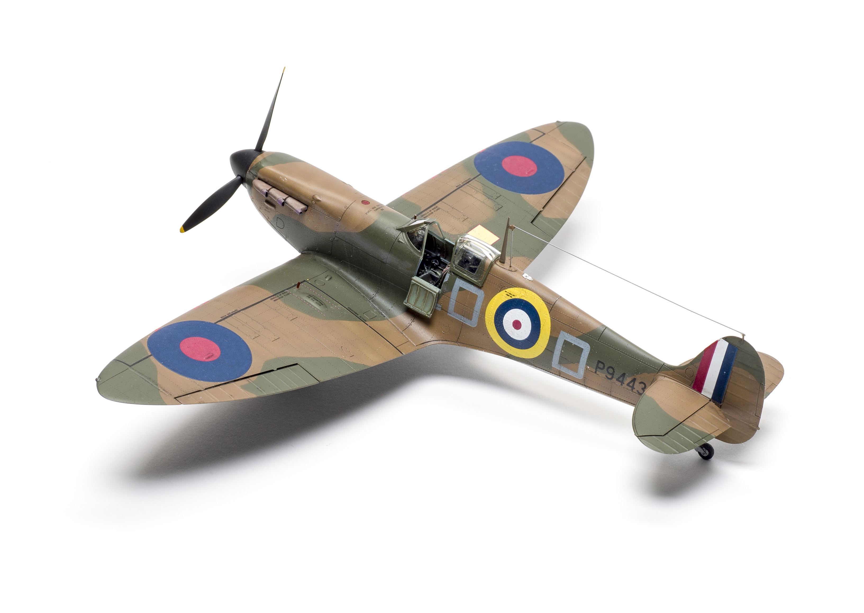

I painted the cockpit parts with Testors Mode Master RAF interior gray green, then  picked out details with Sakura Pigma Brush and Sharpie markers. For the camouflage, I airbrushed Mr. Color lacquers silver (No. C8), dark earth (No. C22), and dark green (C361), and Tamiya acrylic gloss black (X-1) and gloss white (X-2). A coat of Pledge Floor Gloss laid a foundation for the decals.

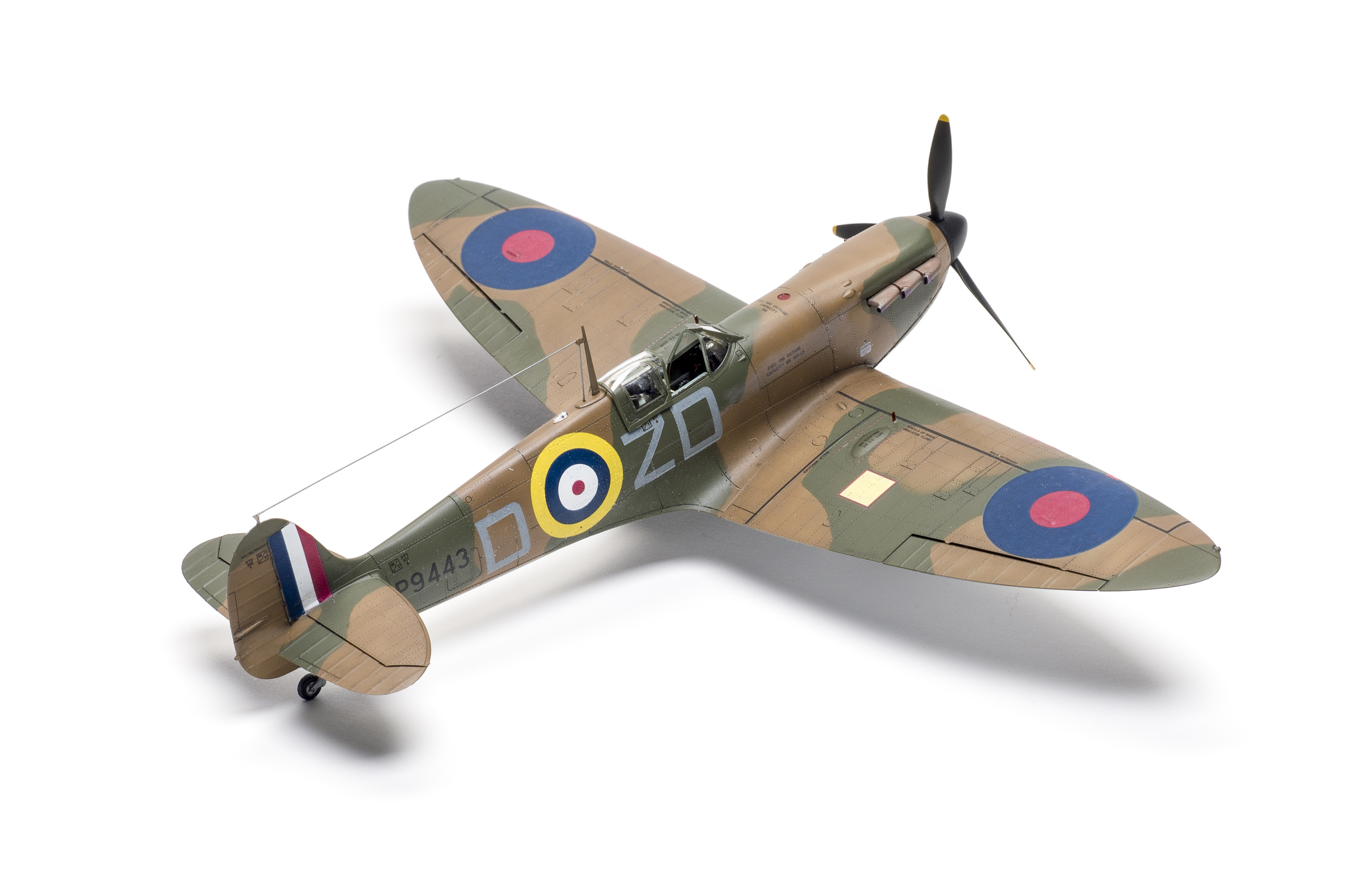

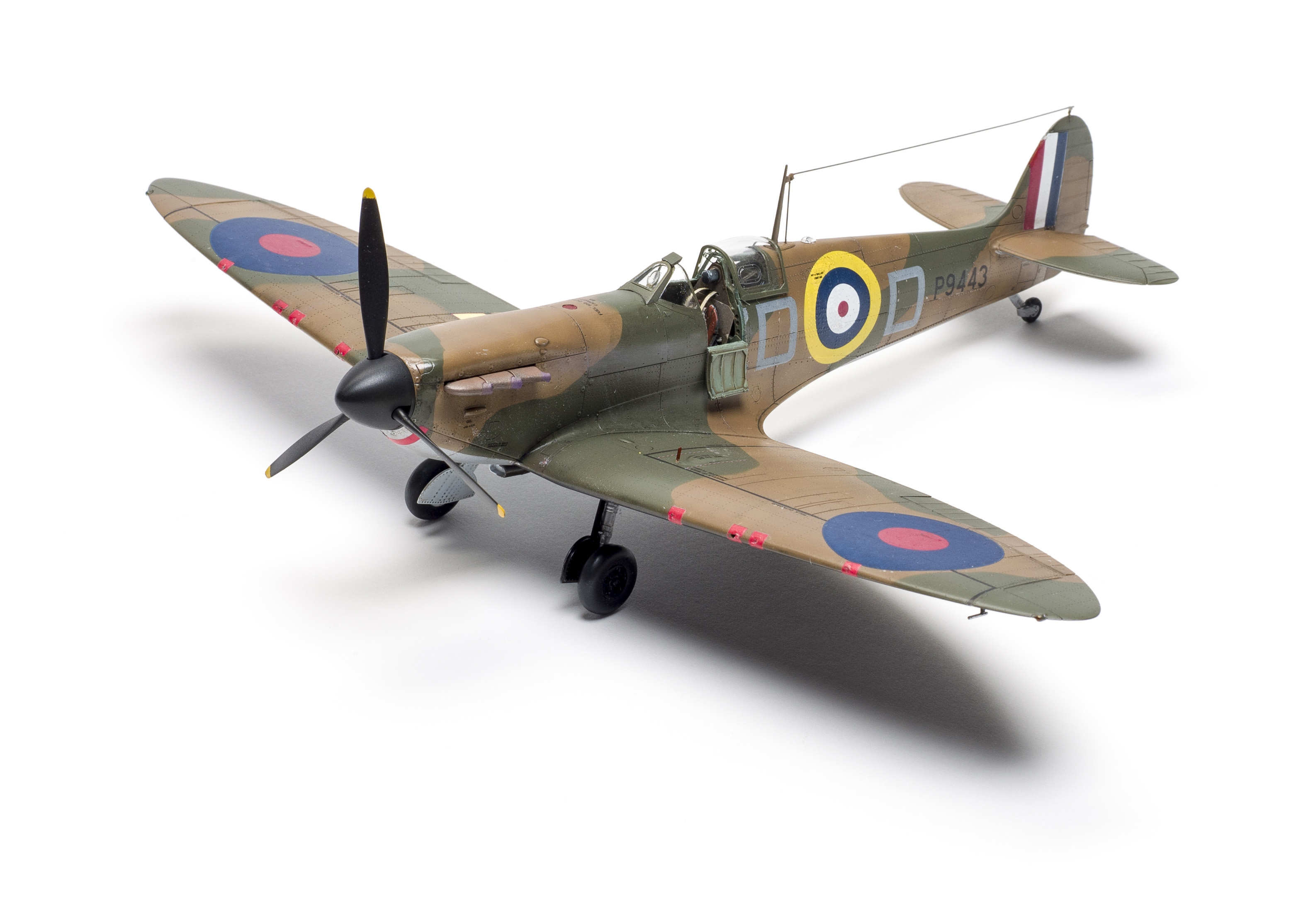

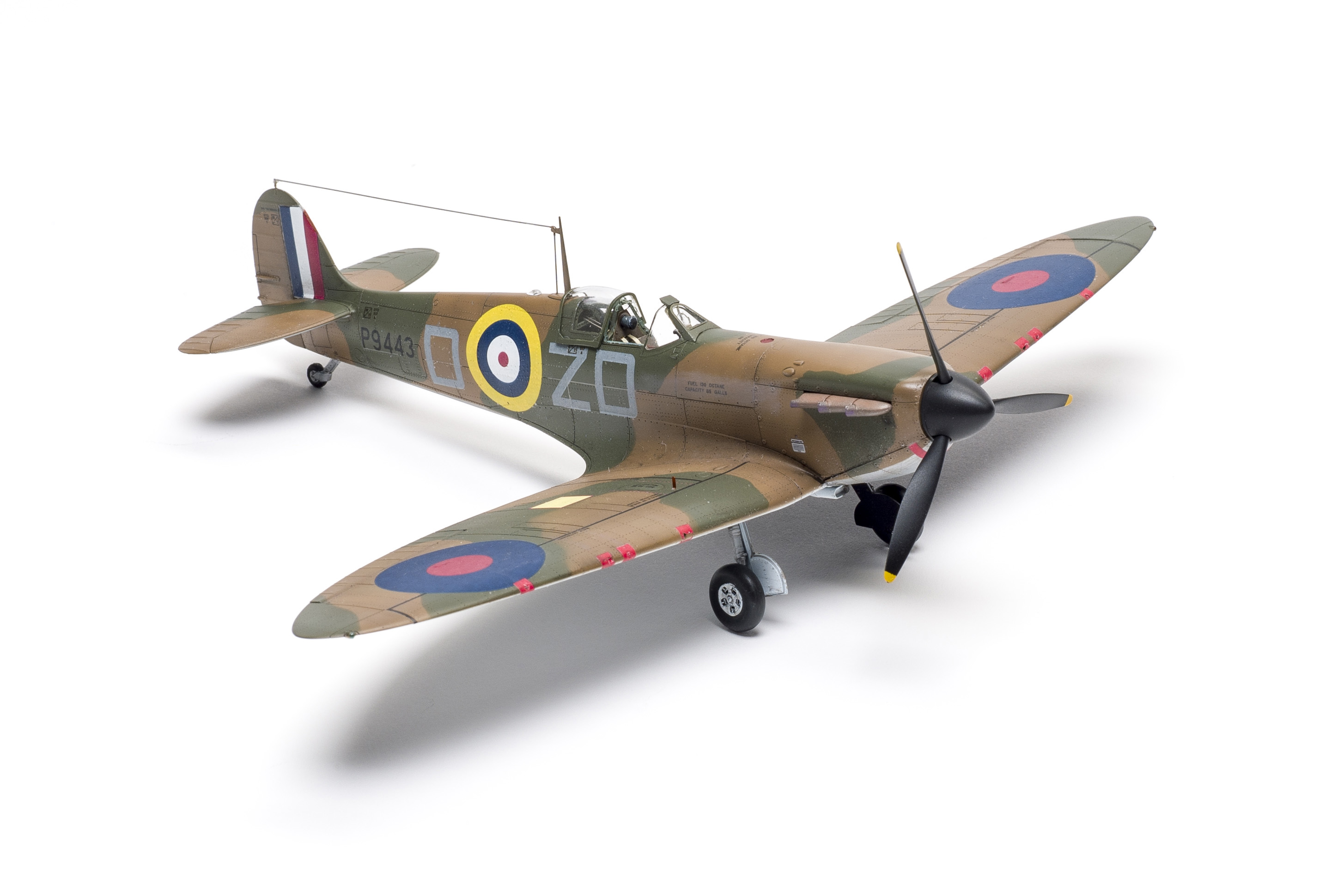

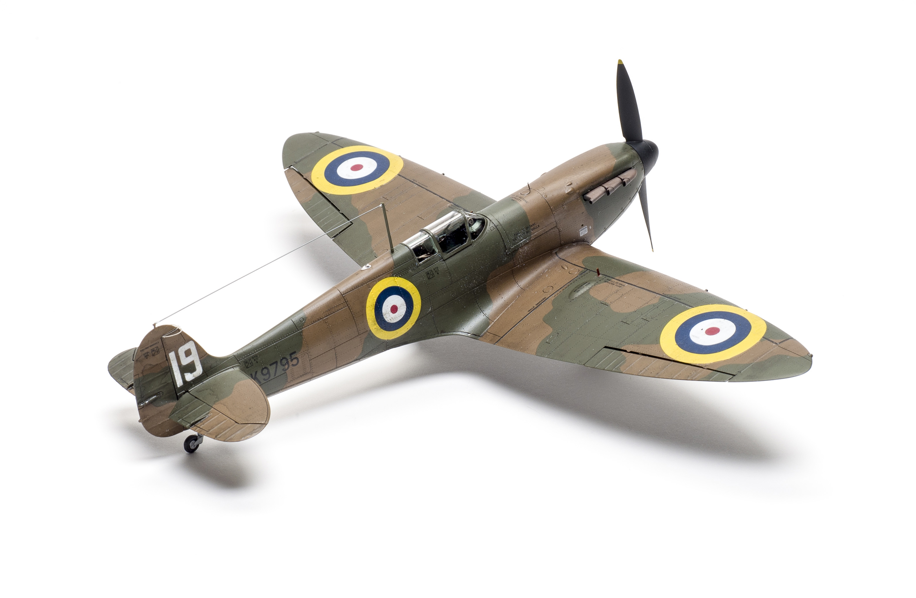

The stencils went down beautifully. Next came the early four-color roundels for pre-war option A, and, unfortunately, they proved to be thick, stiff, stubborn, and impervious to decal solutions — even Walthers Solvaset had no effect. I used a hairdryer on high to melt them into place — which worked — but I also watched as the antenna mast melted and bent to the side. Fortunately, leftover parts in this dual combo came to the rescue with a replacement. The roundels and ID letters of the second airframe went down with no such problems.

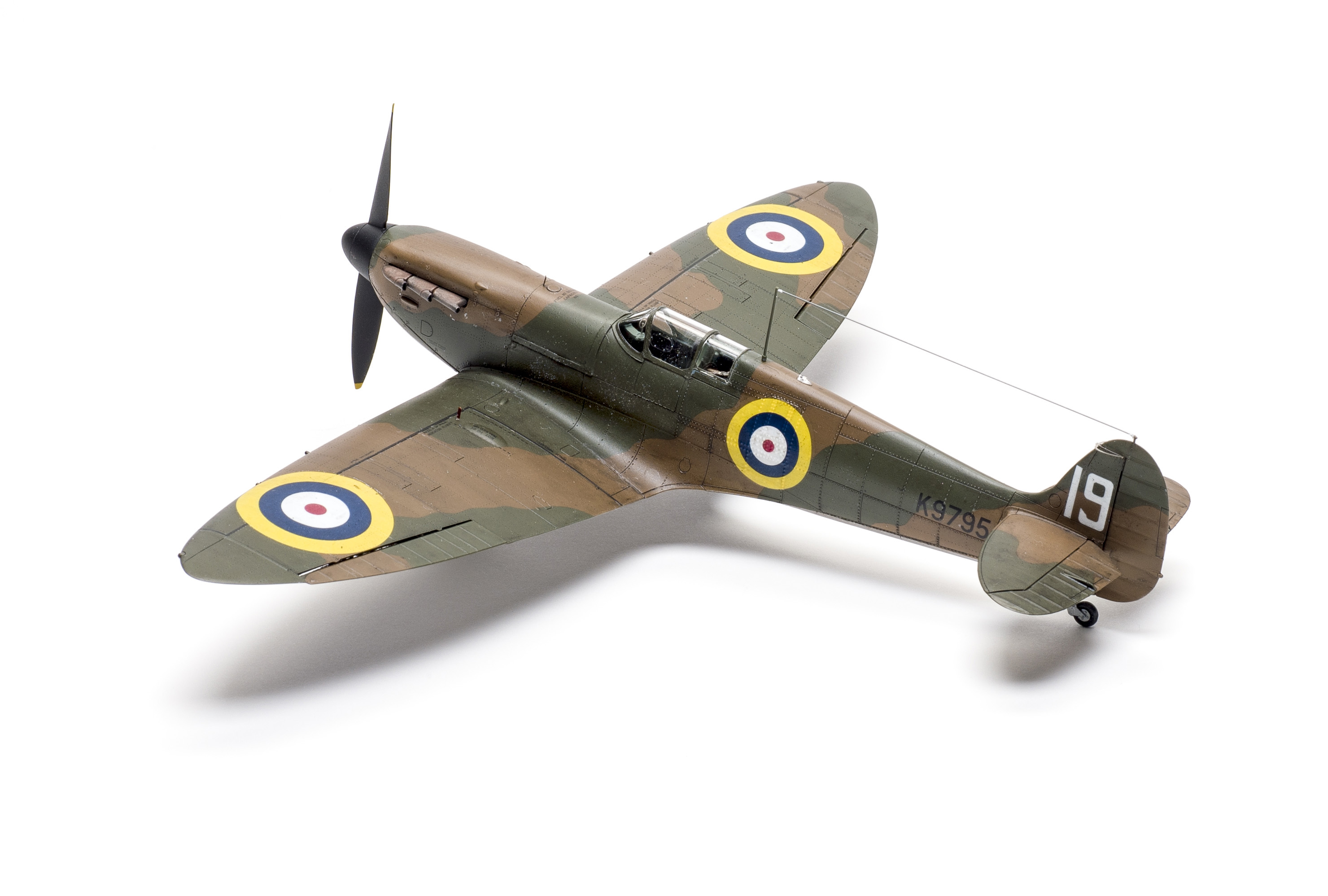

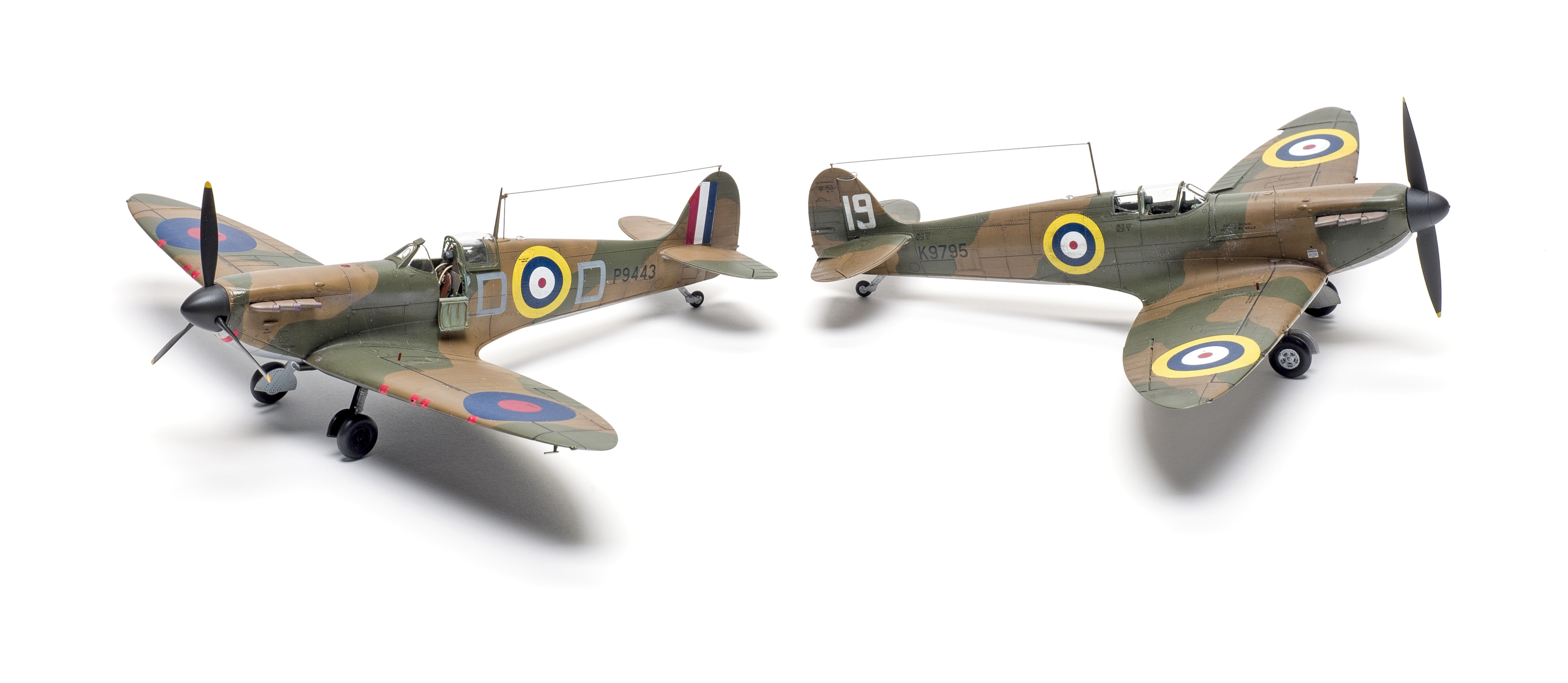

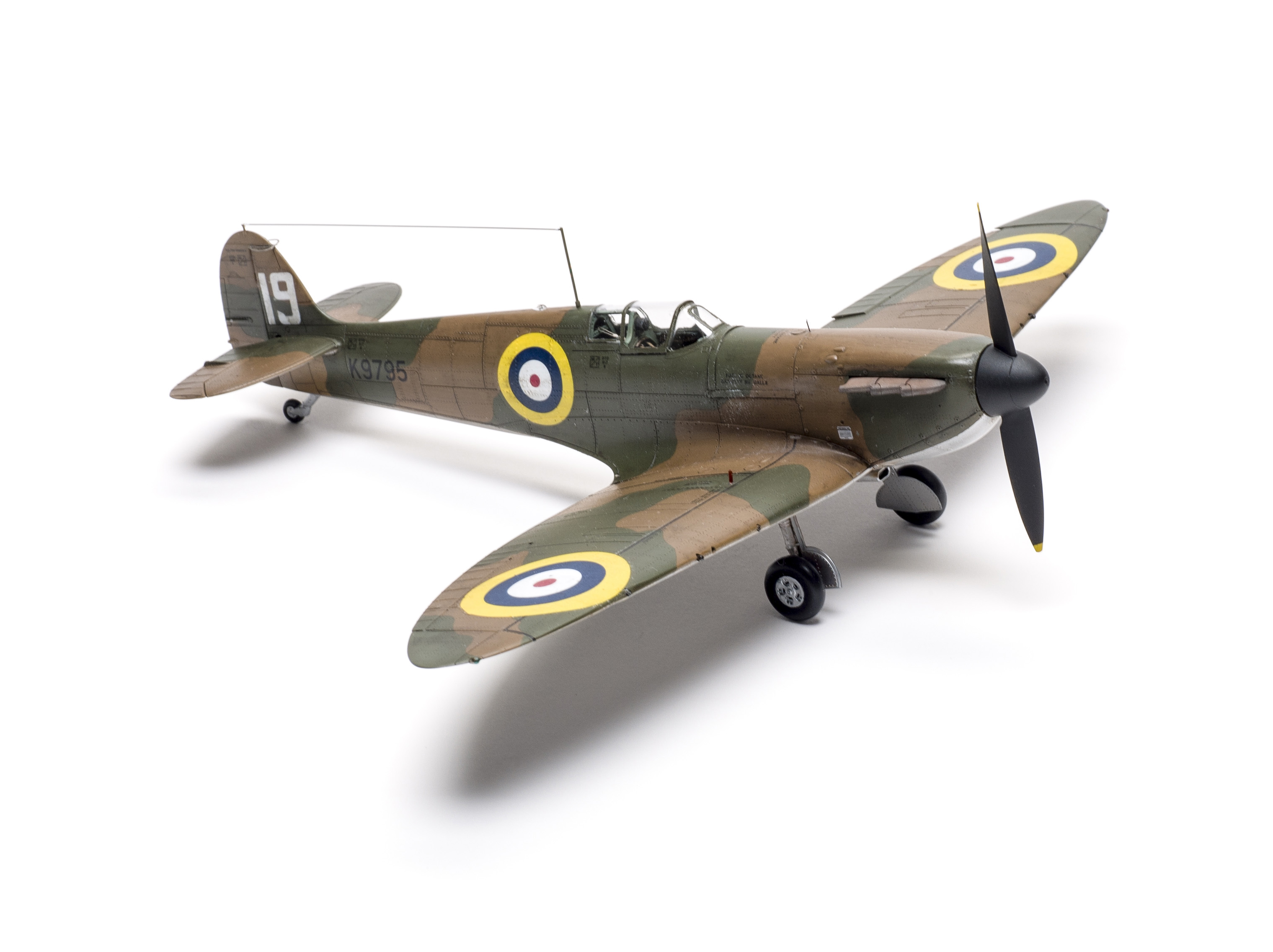

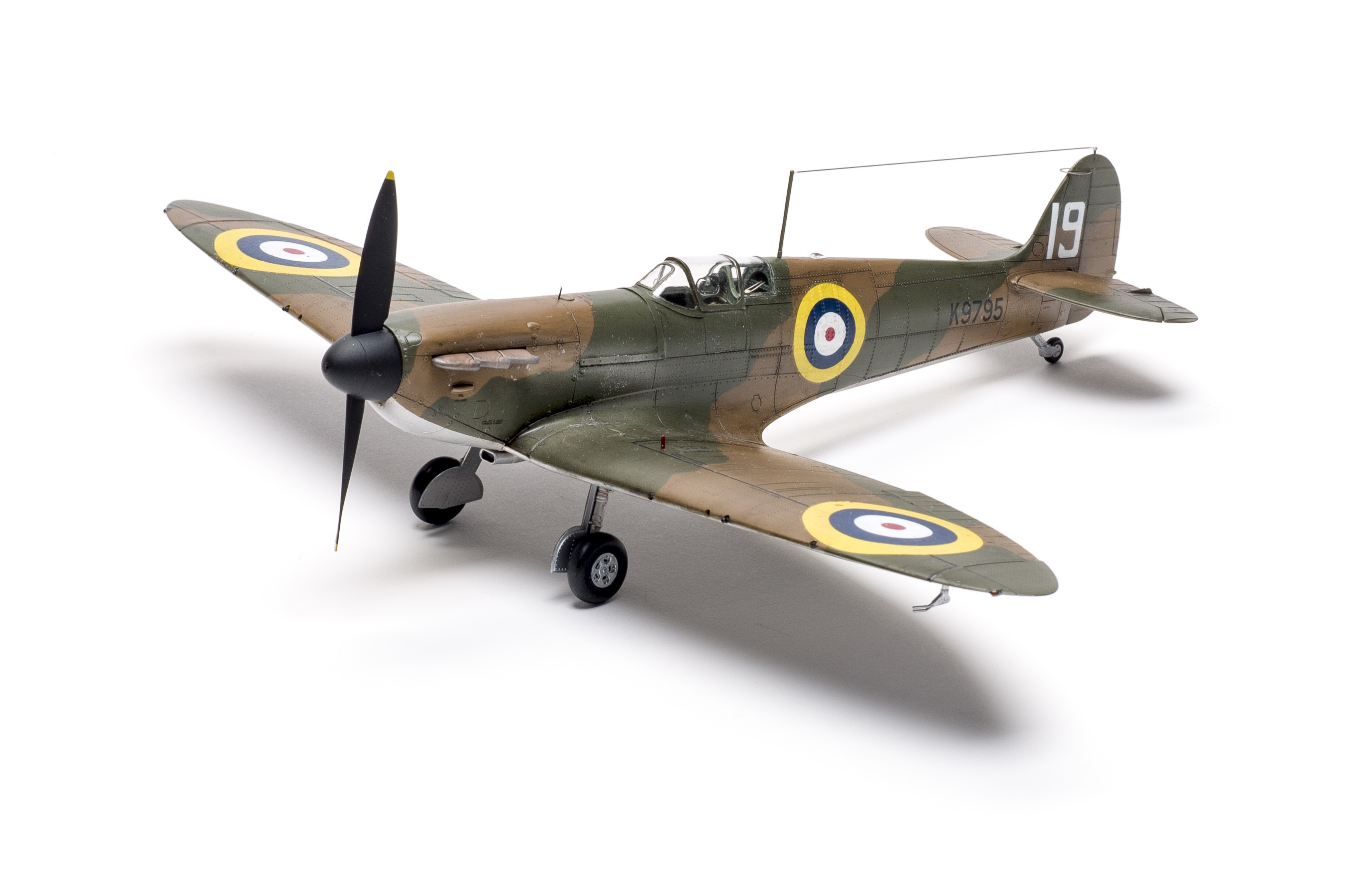

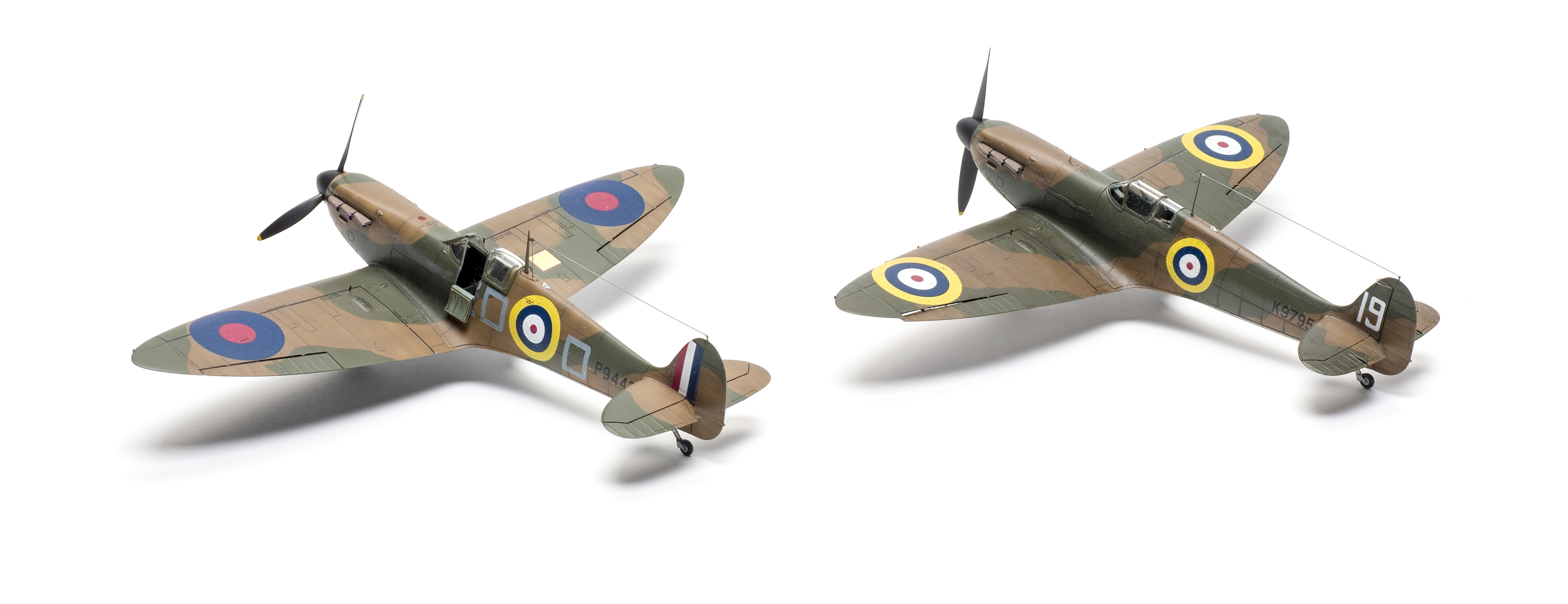

A sludge wash, flat coat, final assembly and Bob’s your uncle,  I had two spitfires ready for action. Construction of airframe the pre-war airframe (Option A) took 15 hours with another 10 for paint and decals. I spent a few more hours on the Option F, a fighter flown by RAF ace Douglas Bader, with an open cockpit.
