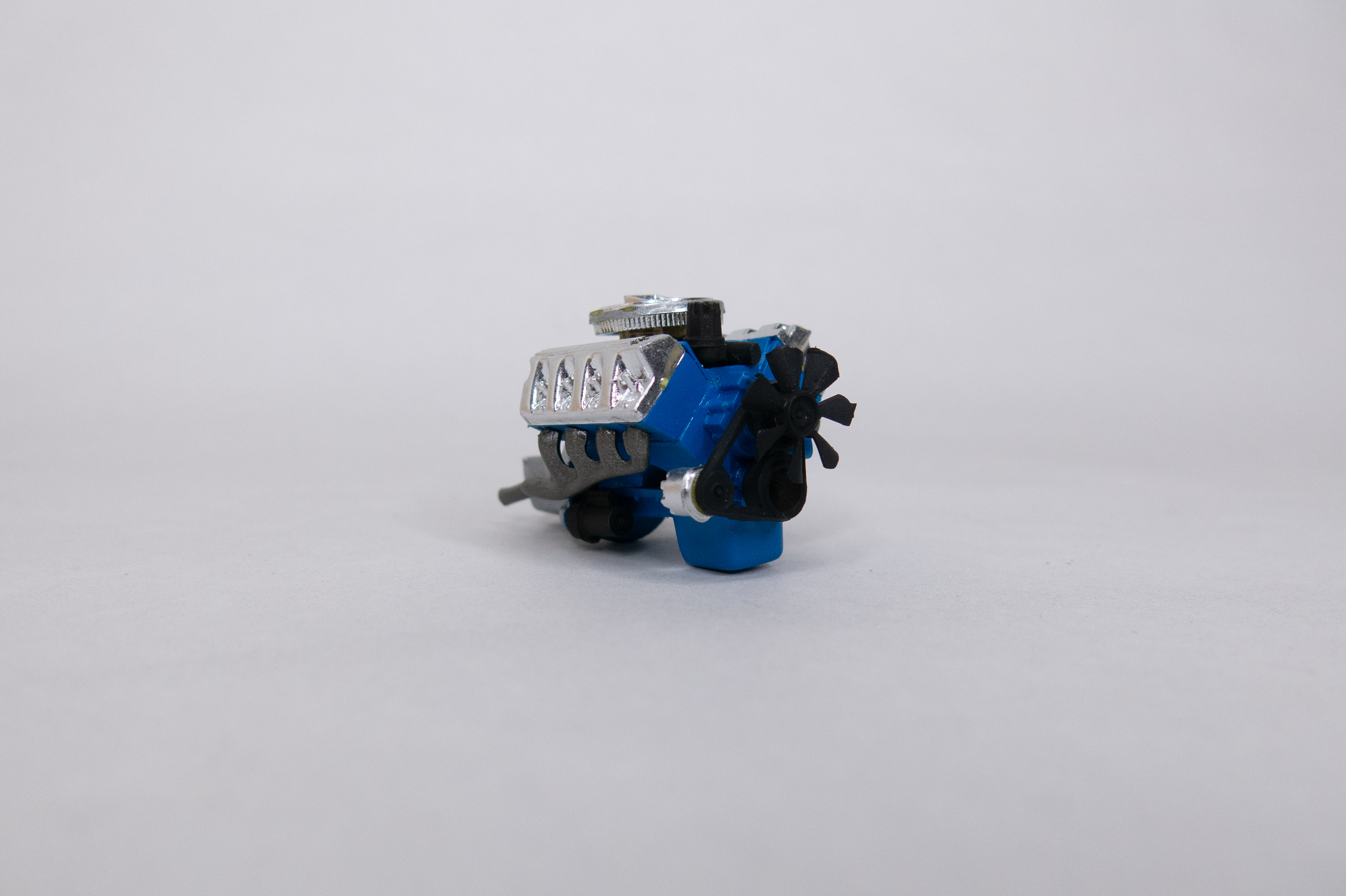

The included 18-part 429 engine matches past Galaxie police-car versions and is fairly nondescript. As is typical with promo models, a hole pierces the oil pan to accommodate the metal axle. An optional block plate for the chassis depicts the lower part of the engine and is what I used on my model. However, I did build the engine for you to see.

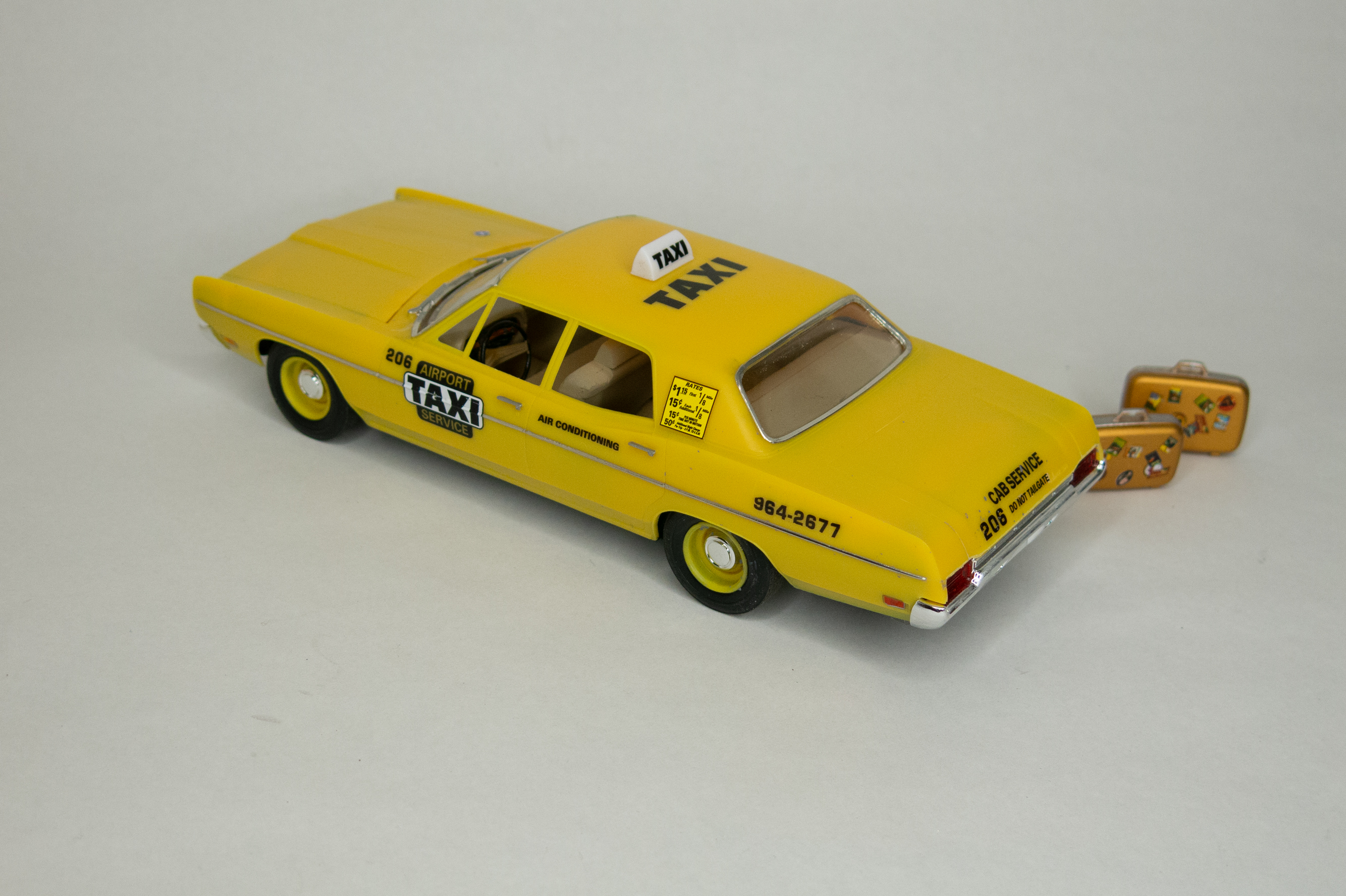

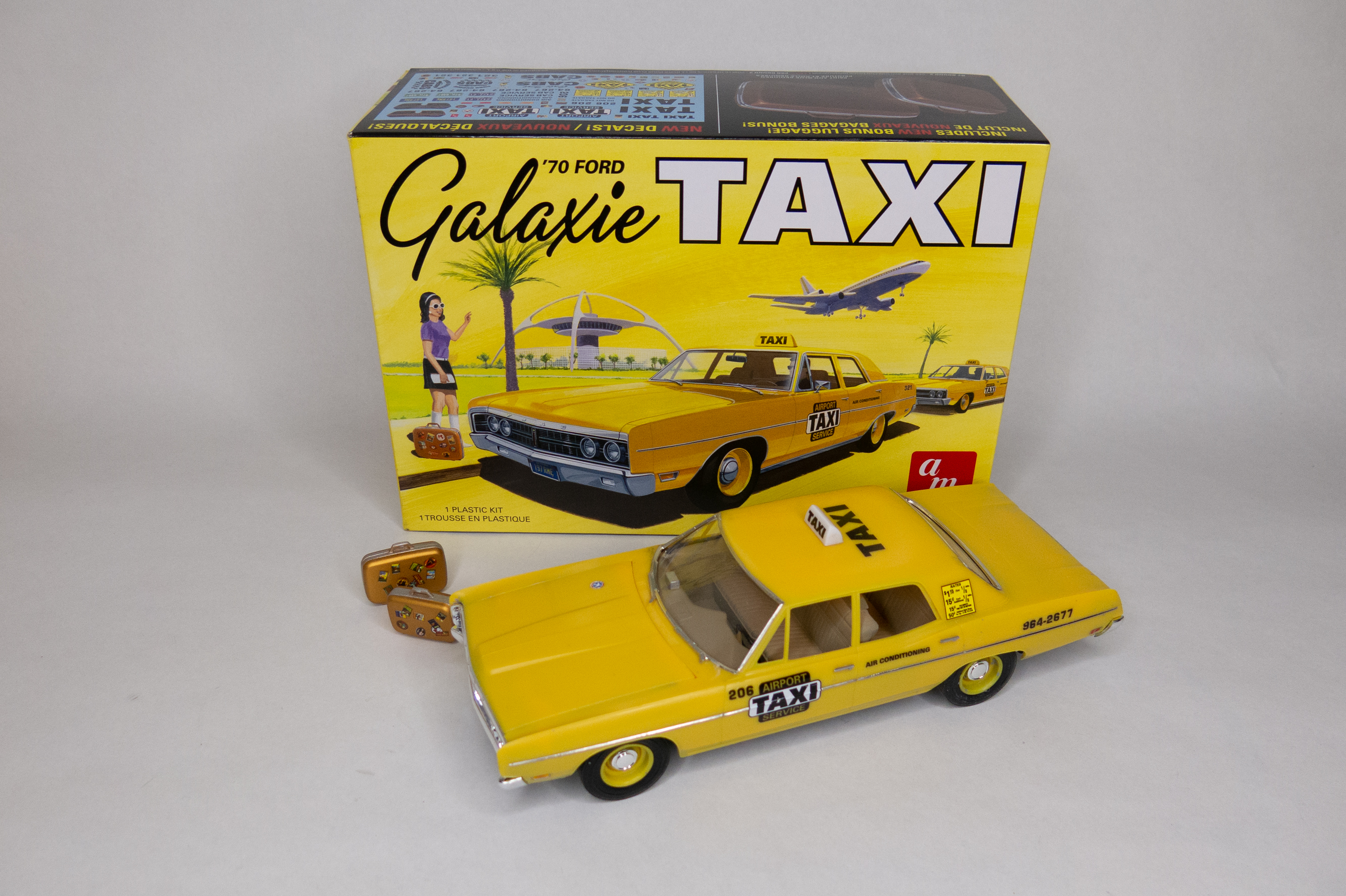

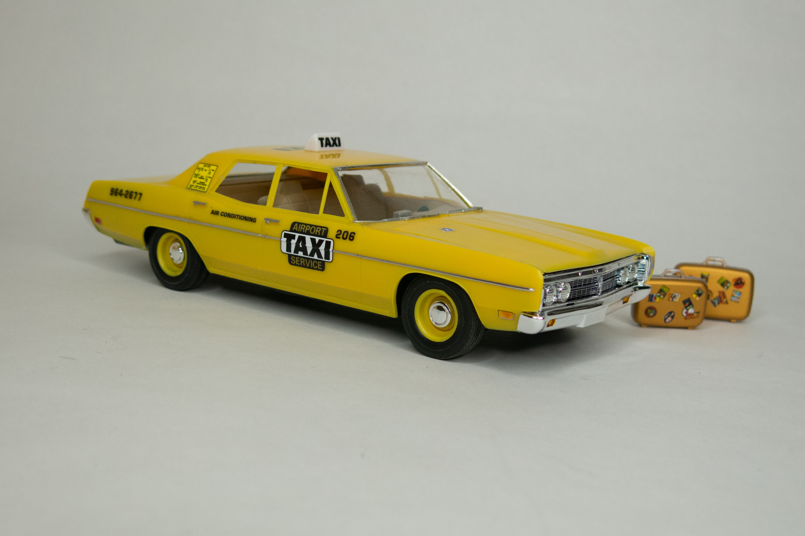

The Galaxie body came molded in yellow clear of swirl marks and only minimal flash. What the heck? I treated it NOVUS No. 2 plastic polish for a nice overall shine and left it as is. However, the plastic is translucent, so I shot the inside of the body with gray primer. I permanently attached the hood (without the engine inside), and brought up the brightwork with Bare-Metal Foil. The decals look the part and go down quite well.
The one-piece glass and interior fit without any issues, and the chrome front and rear panels lined up nicely between the body and chassis. And just like the old-school promos, four screws hold it all in place. All that left were the taillights and the taxi sign on the roof. On my sample, the attaching point for the sideview mirror on the sprue was chromed over, so I do not believe it was ever on tree.
But we’re not done! The kit provides luggage you can build. I painted the bags burnt orange with Molotow Liquid Chrome around edges and plastered them with travel stickers from the decal sheet.
