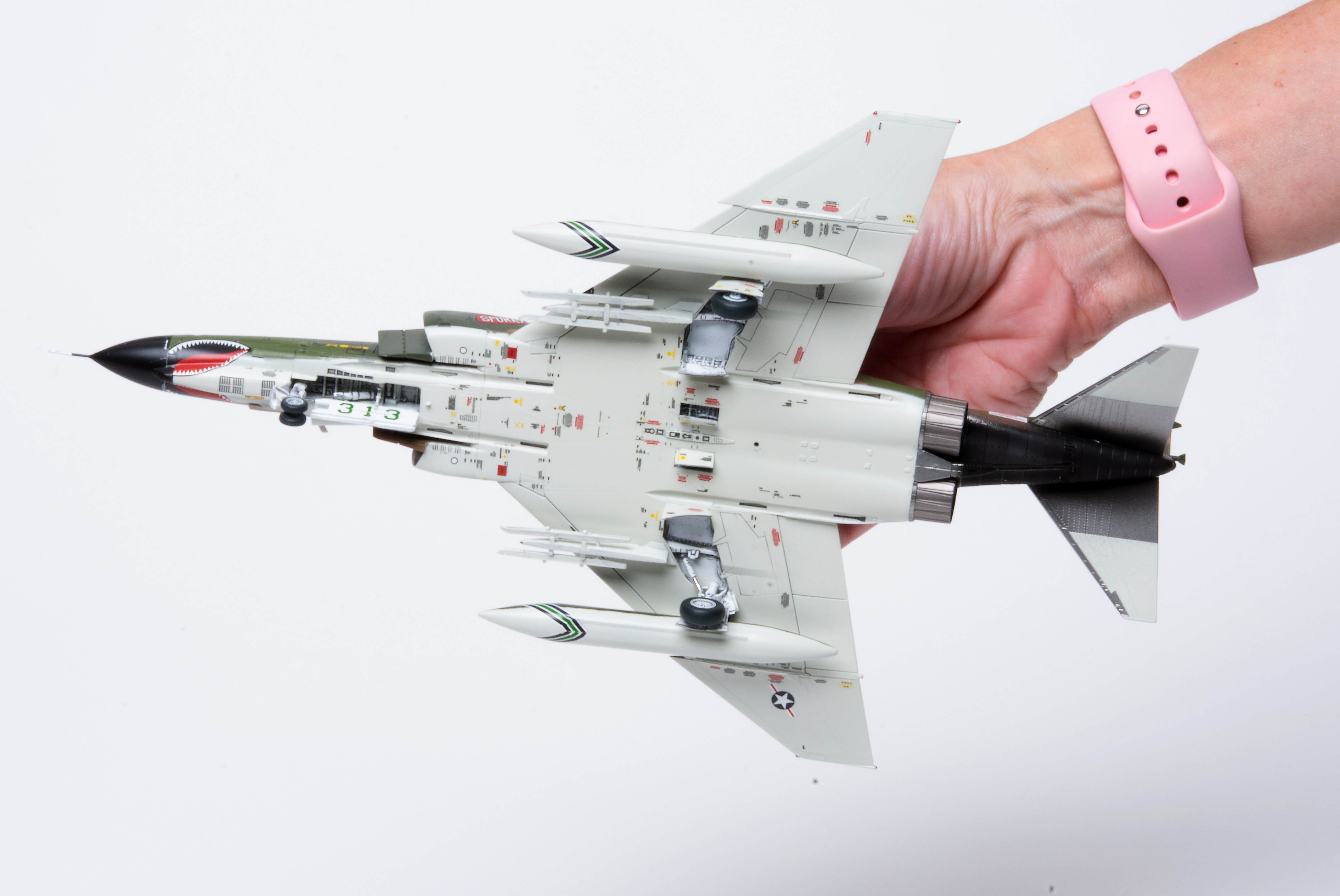

The kit provides equipment cooling hatches near the centerline of the belly and a detailed equipment bay. The deeply scribed ailerons could be drooped easily for a more dynamic and realistic model. While the radome is separate, watch out when painting: The aft 3mm of the part should be camouflaged, the rest is black. I had to repaint mine.
You get both short and the later long gun muzzles to fit under the nose. The kit provides a pair of underwing tanks and a choice of two centerline tanks. Note: The later F-15-style tank is not used on this early F-4E. Inboard weapon pylons are supplied along with two styles of missile rails. The tiny pins and holes to attach the rails to the pylons are not sturdy, so be careful.
Parts fit overall was excellent and I used no filler, but I had to sand the mating surface along the fuselage spine. Also, the always-difficult intake-to-fuselage seams — never easy on Phantoms — required a little sanding.

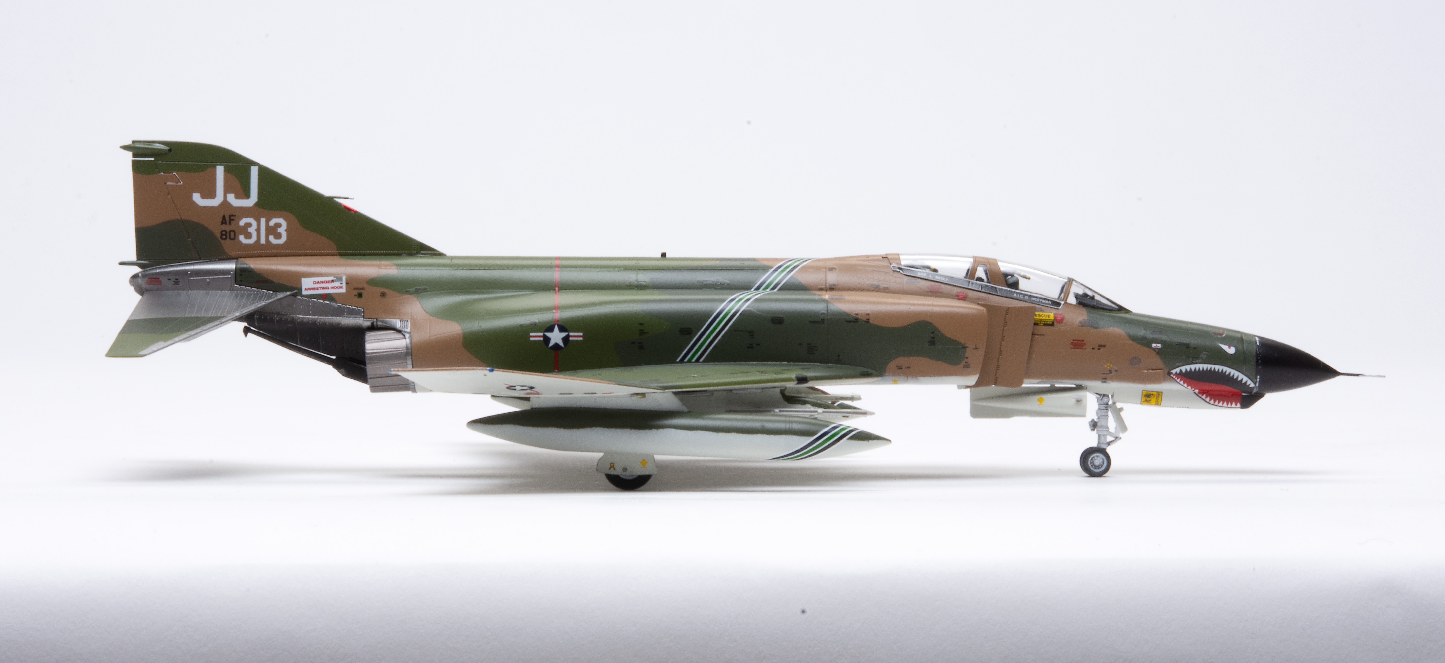

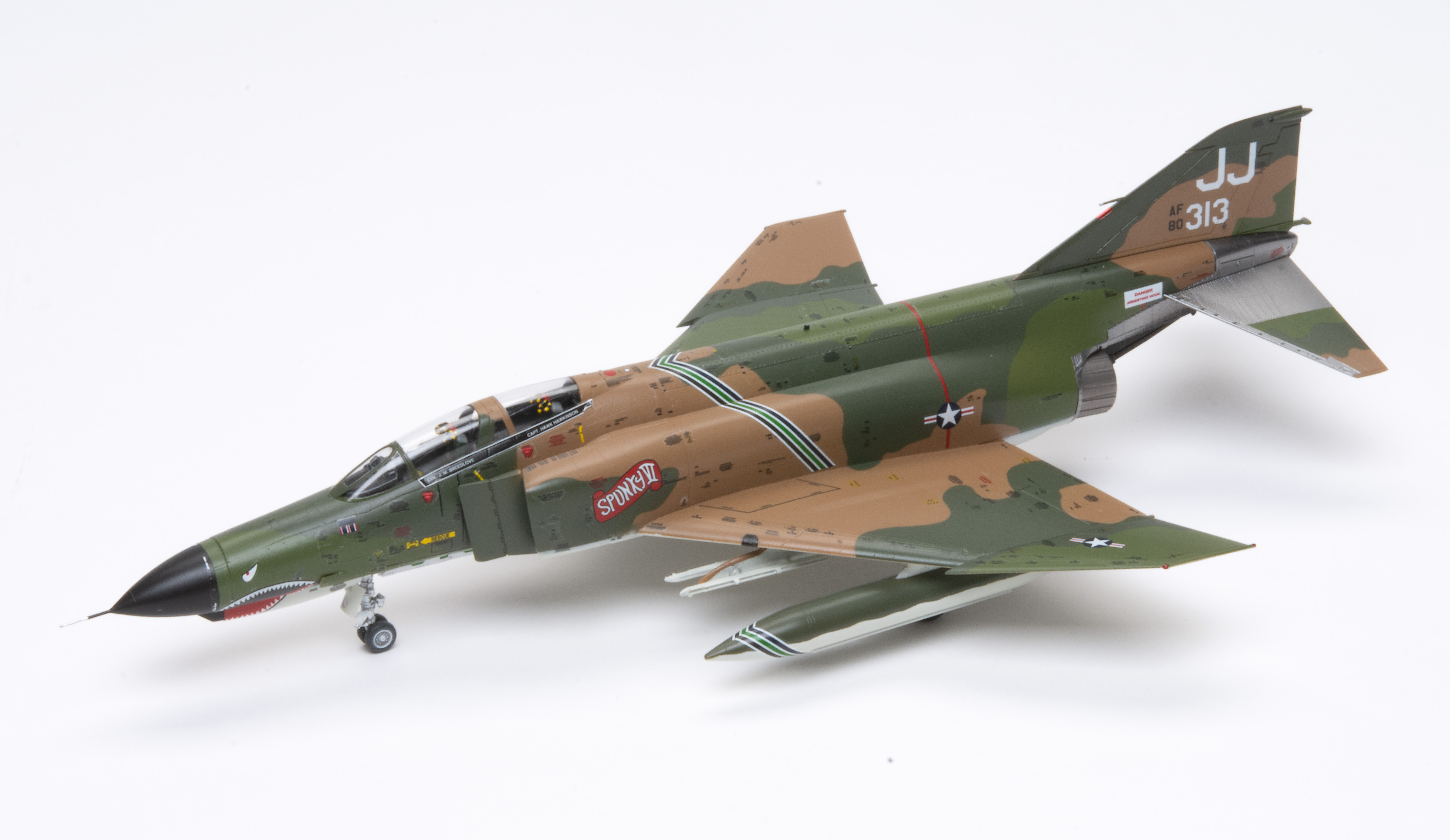

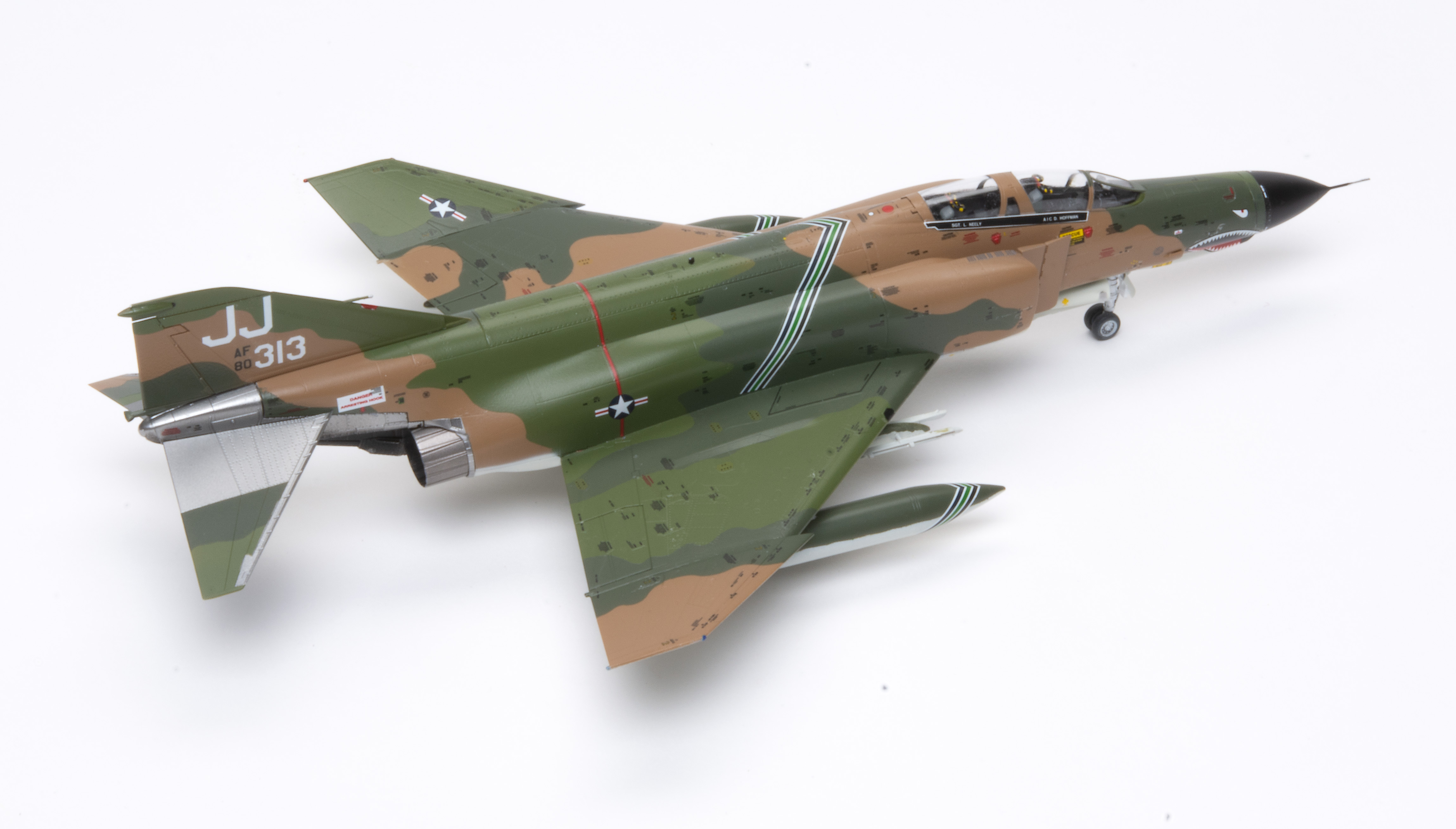

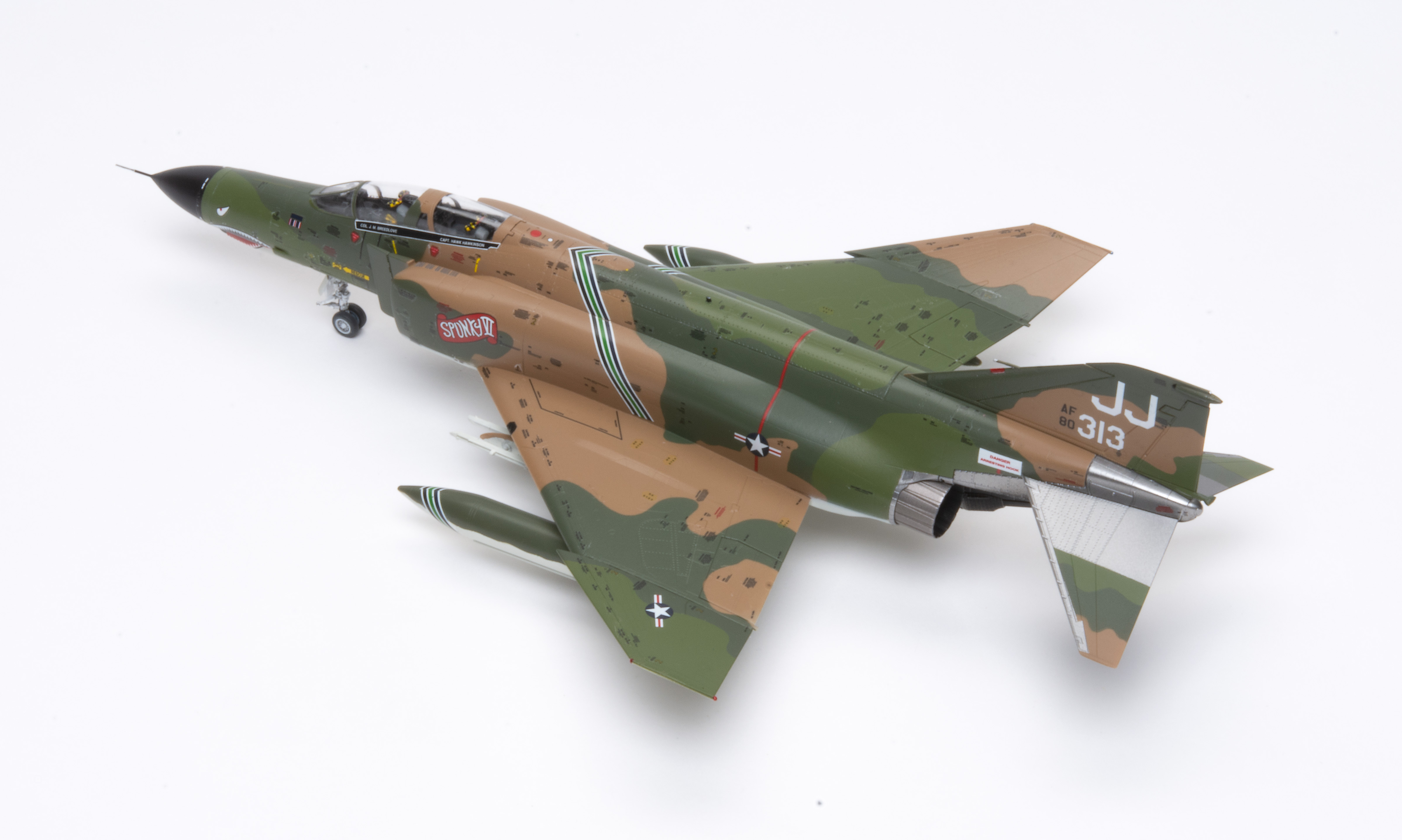

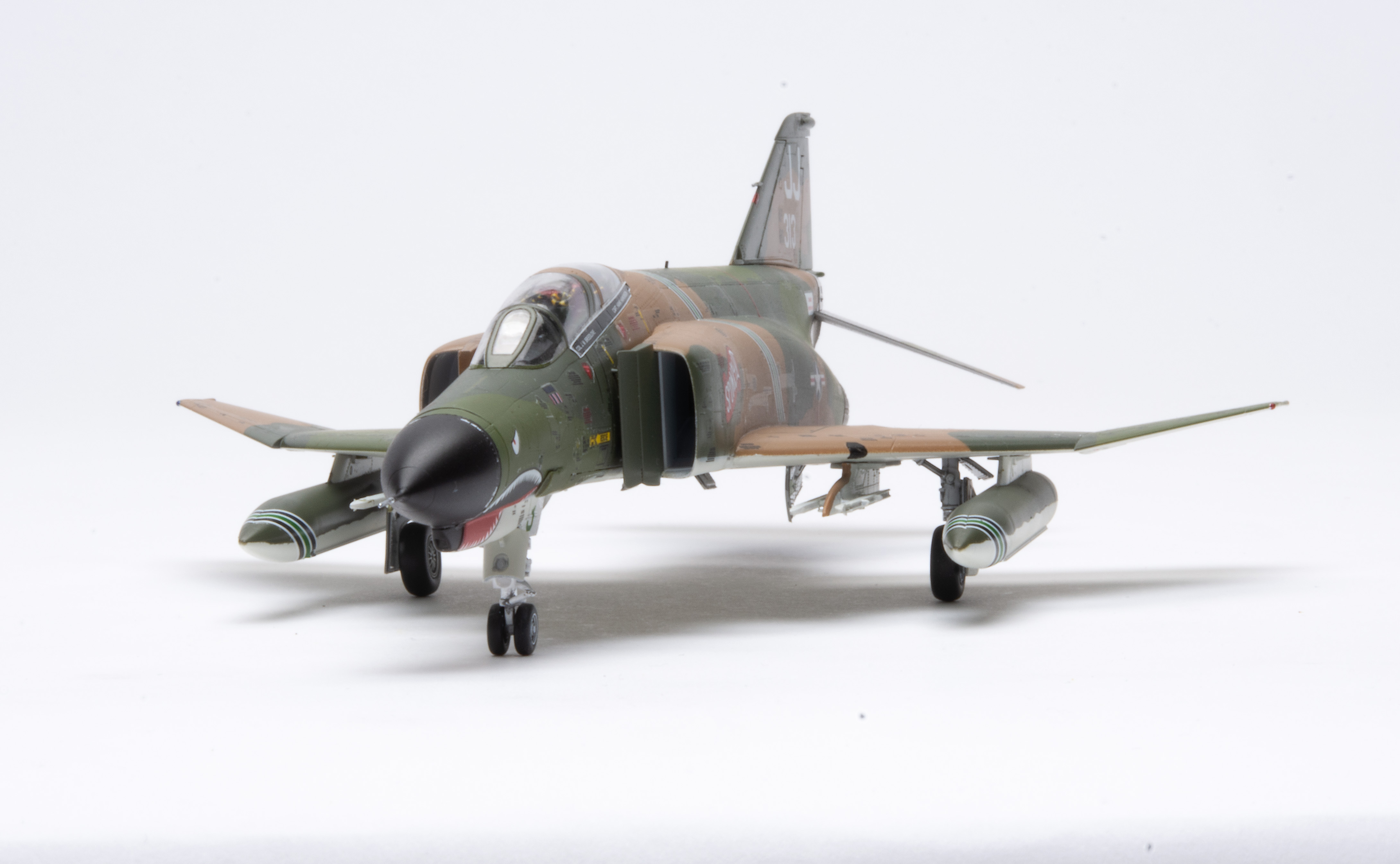

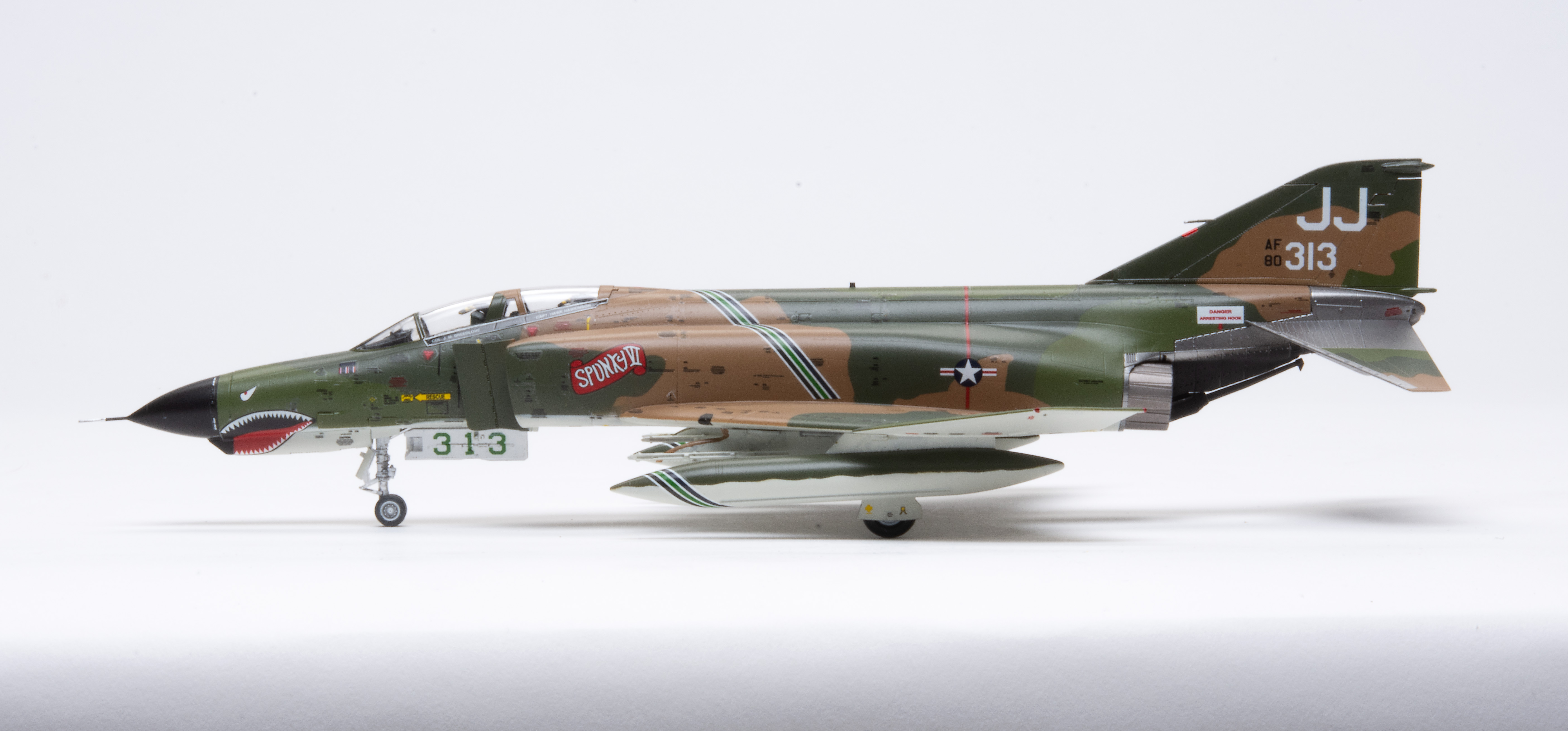

Putting all the subassemblies together was trouble free and no gaps showed up, even between the wing and fuselage. I chose the closed canopy option and it fit perfectly! I painted my model with Mr. Color lacquers using vinyl masks from LF Models for the SEA camouflage (No. M7263). The separate fin made painting easier.
The decals provide markings for two shark-mouthed F-4Es, one from the 34th Tactical Fighter Squadron, 388th Tactical Fighter Wing, the other 4th TFS, 366th TFW. There are more than 100 decals on the beautifully printed sheet, so prepare for an extended session. Fortunately, many of the tiny stencils are grouped, so you can apply two or three, or up to six stencils with one decal. Still, it took several hours to get them all down. They’re a bit thick; I recommend using hot water and a hair dryer.
You won’t find ordnance in this kit, and that, after a great build, disappointed me. Fine Molds produces a couple of ordnance sets available separately — U.S. army Aircraft Missile Set 2: ’60s-’70s (No. FP44) and U.S. Army Aircraft Bomb Set: ’60s (No.FP45).
I spent 31 hours on my Phantom, the lion’s share devoted to painting and decaling. I think the model looks terrific, although I could have done a better job adding the radome after I repainted the camo on the aft end. The shark mouths cover most of my mistake, so I’m good. Fine Molds’ kits are the best Phantom IIs in 1/72 scale, so, if you can find them, enjoy!
