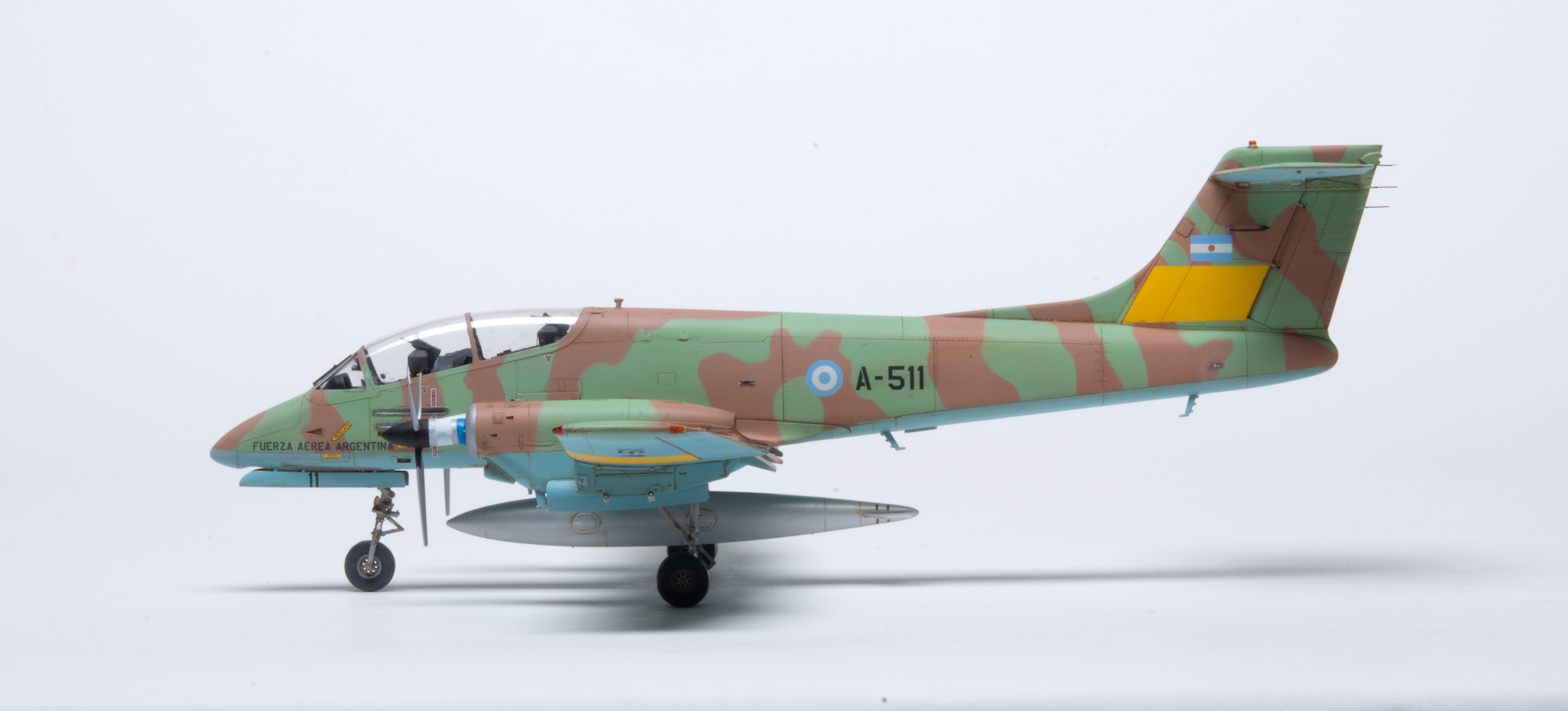

The fuselage halves fit together beautifully and sanding almost eliminated the seam. I used a little superglue to fill a couple of areas. Add weight to the nose if you don’t want a tail sitter; the more the better—there’s a lot of plane in back.

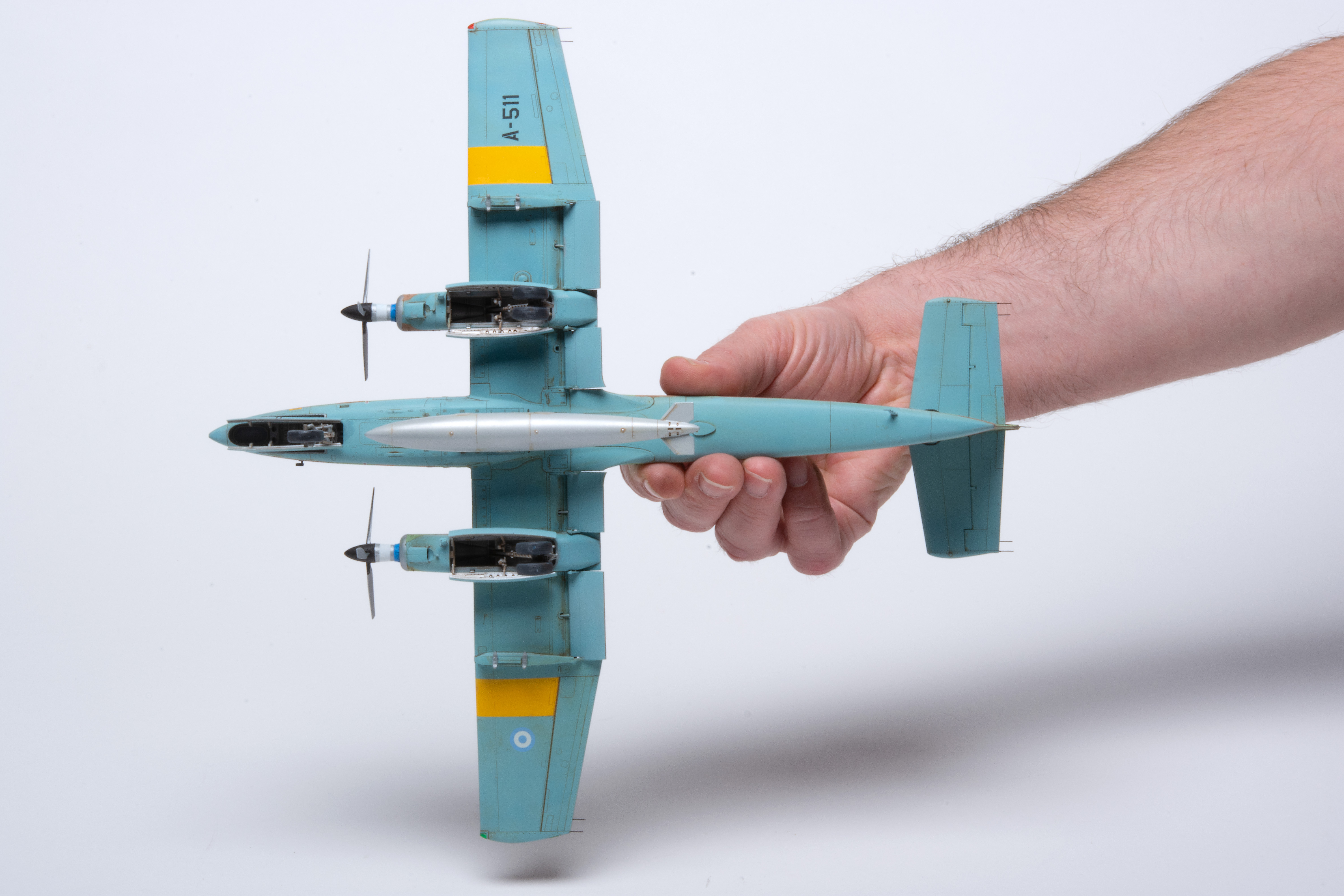

The lower half of the wings incorporates a large section of the belly, joins on panel lines, and sets the angle of the wing. The upper wings and engine nacelles with the main gear bays went together without a hitch. I added the wing pylons but left off the landing light lenses and ordnance brackets for painting.
The separate fuselage section that fits behind the cockpit joins on panel lines. Good! However, it seemed a scooch narrower than the fuselage around it. Not so good. I centered it as best I could and carefully sanded the edges to minimize the lip.
I left the flaps, antennas, lights, and cannon shell ejector ports off for painting, but I attached the perfect fitting windshield and canopy and masked the frames.

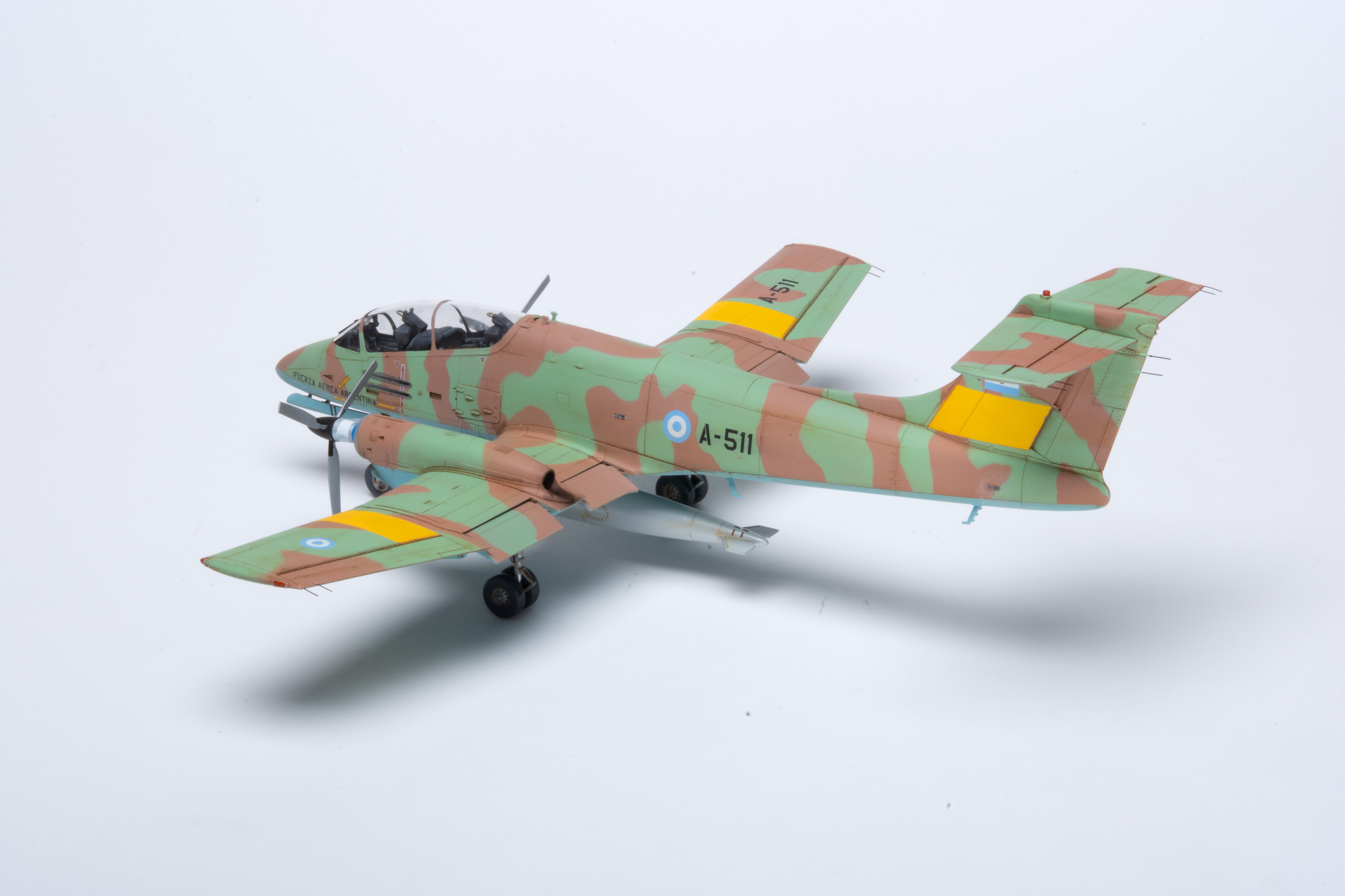

Wanting to display an Argentine IA 58A next to my Falklands War Sea Harrier, I painted it the Pucará-specific pale green, tan, and blue from Hataka’s Argentine lacquer set. The thin decals laid down over a layer of clear gloss, but the black-and-white placement diagrams are so small it was difficult to locate or even see some of the smaller stencils.
After detail painting and a coat of clear flat, final assembly was a snap. Step 9 reverses the numbers for the main gear doors. Fortunately, it is obvious which one goes where. Be careful clipping the main gear doors from the parts tree because it is hard to tell where the locators end and the attachment point begins. On the upside, those locators provide a positive join and set the angle.
The sturdy nose gear doors are difficult to maneuver into the holes under the bay’s lip around the gear legs. Those legs provide the model a sturdy footing and the tires are weighted. The mains are keyed to place the flat spot on the ground, but the nose wheel rotates freely, and the flat spot is almost too subtle.
The flaps almost snap in place without glue, but the actuators can break easily during handling. The lights are some of the best-fitting small clear parts I’ve used. All I did was ensure the sprue attachment points were eliminated.
I was planning to fit the big centerline fuel tank and the TERs, but the separate bomb holders are tiny. After losing two in short order, I left the wing pylons empty.
Finally, and with much trepidation, I added the PE static discharge wicks. I was convinced these tiny parts would either bend irreparably during handling or launch from the tweezers as I went to place them. In the end, I got all of them on and painted.
I am not sure how long I spent building Kinetic’s 1/48 scale Pucará — I kept getting sidetracked by other projects. But I enjoyed working on it. The good detail and fits compensated for the lack of color callouts and ordnance, and it’s great to finally have a model of this aircraft whose exotic profile I saw in grainy TV news coverage from the Falklands war nearly 40 years ago. I recommend it for anyone with moderate experience.
