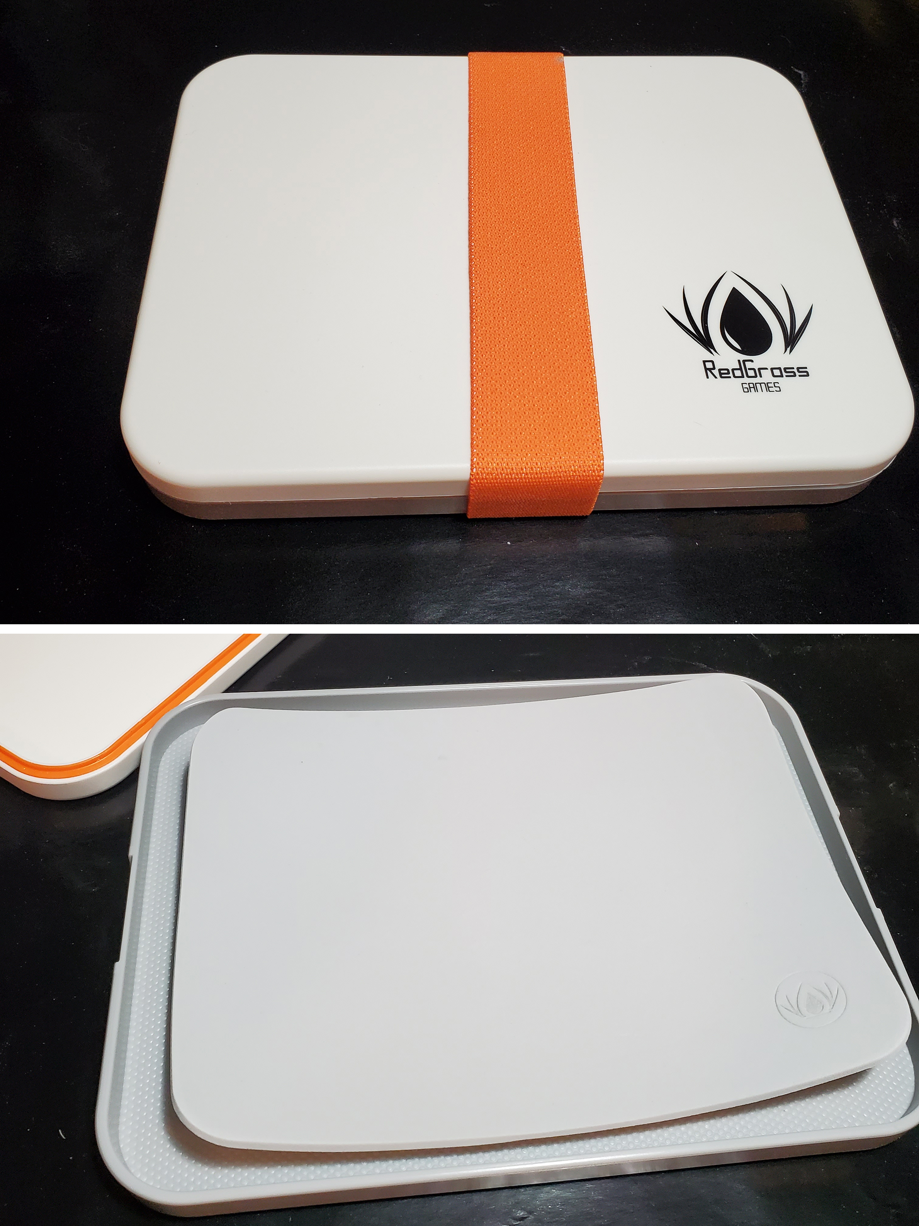

A wet palette consists of a container with a tight lid to prevent air drying between sessions, foam inserts that keep the paint moist, and hydration paper — parchment-like paper that doesn’t absorb water.

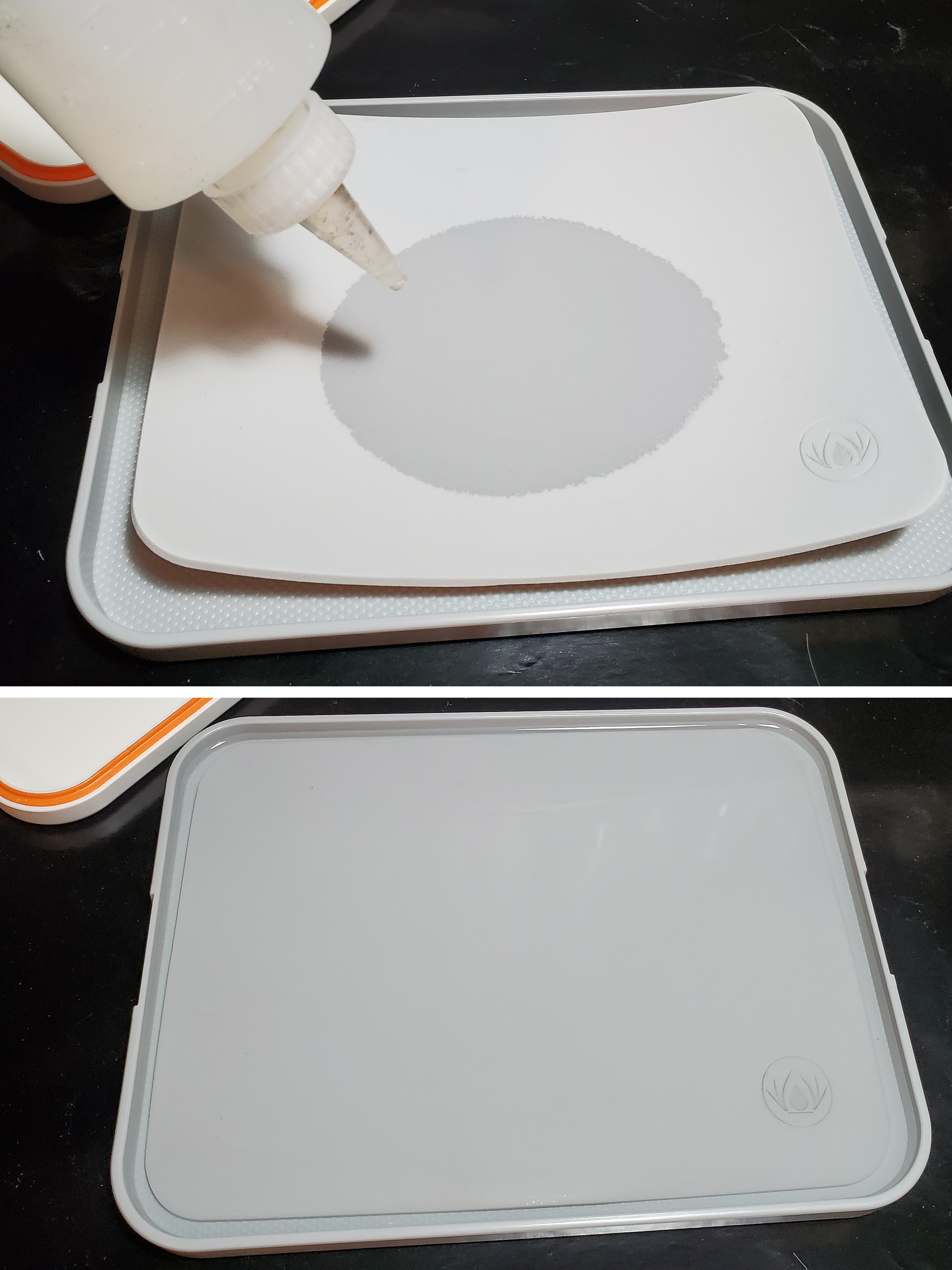

Place the foam inside the container and add water until it completely submerges the foam, which will expand in size.
FSDSNAP043_03
Drain the excess water from the container until only a small amount is left on the bottom. Make sure not to leave too much water, otherwise it will overflow the paper and make your paints bleed into each other.

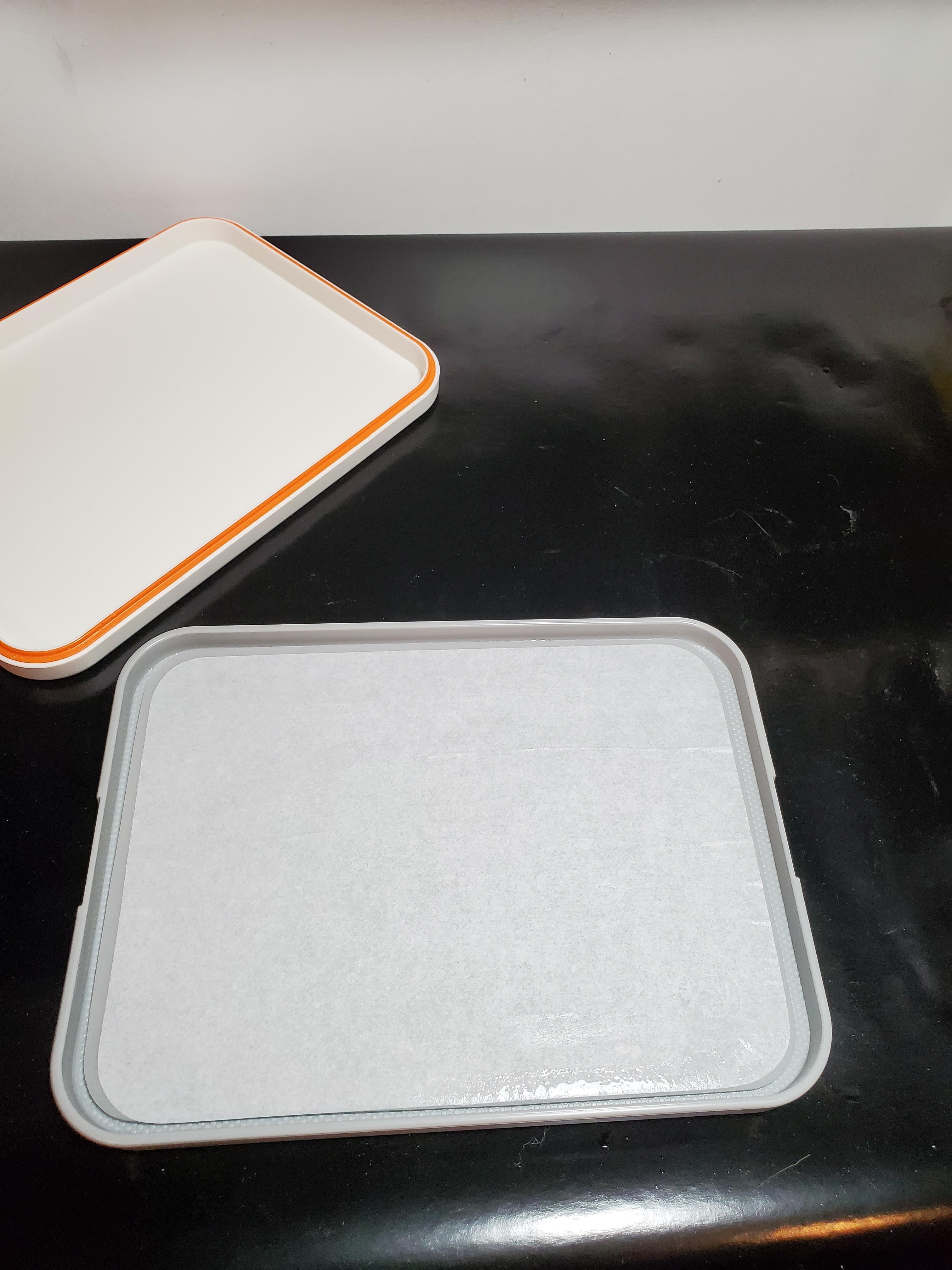

Place the hydration paper on the top of the foam, smoothing it out with your fingers to get rid of wrinkles.
