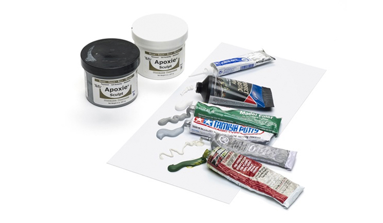

Obviously kits consist of individual parts. But the object of finishing them is to make them look like a solid object. The best way to do that is to eliminate gaps between the pieces. Sanding will take care of minor problems. However, if the parts don’t quite meet or are mismatched, filler may be needed.
Putties remain the go-to for this kind of work. But there are several types and they can be useful in different ways. Let’s look at three main types and how to use them.

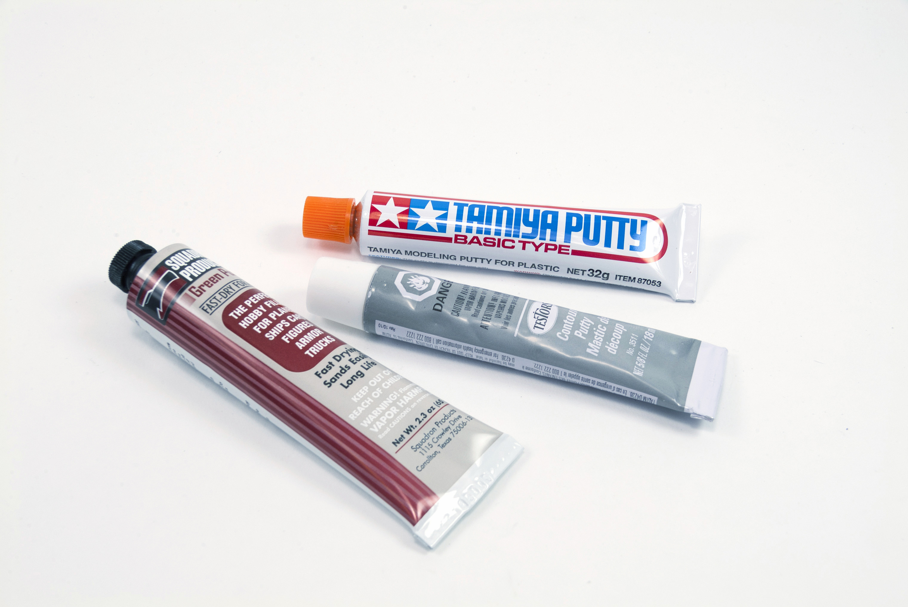

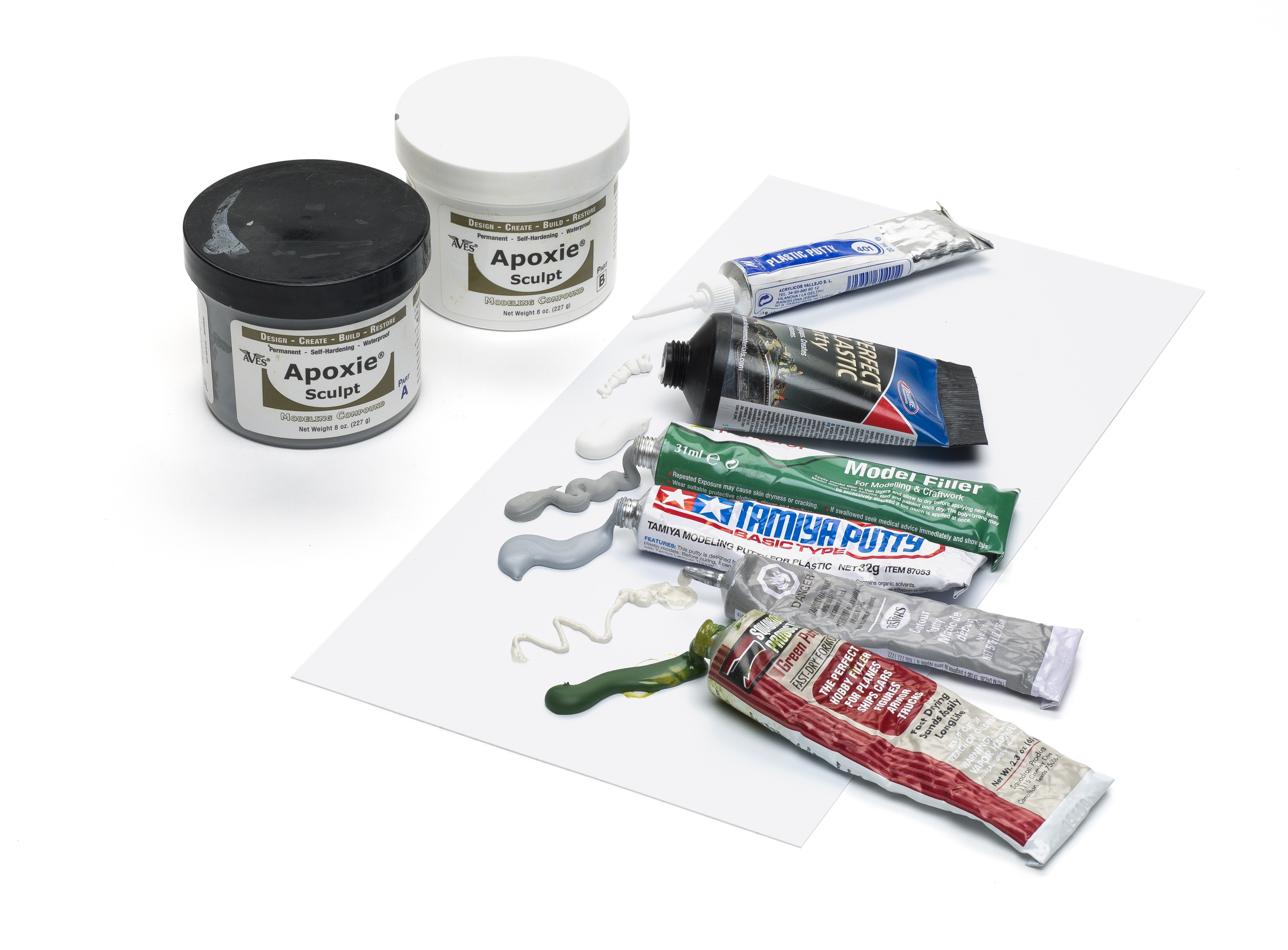

Old-school putties, Squadron Green, Testors Contour, and Tamiya Basic Type are the standard fillers for most modeling applications.
Solvent-based putty
Stinky and sticky, these putties contain organic solvents like toluene and acetone. Like plastic cement these solvents can melt styrene, so they adhere well. They’ve been the gold standard for filling gaps pretty much since modeling became a serious hobby and are still widely available today. Most model or paint companies sell a version in a metal tube like toothpaste. (Don’t confuse them: Putty’s good for gaps in plastic, not for cavities in teeth!)

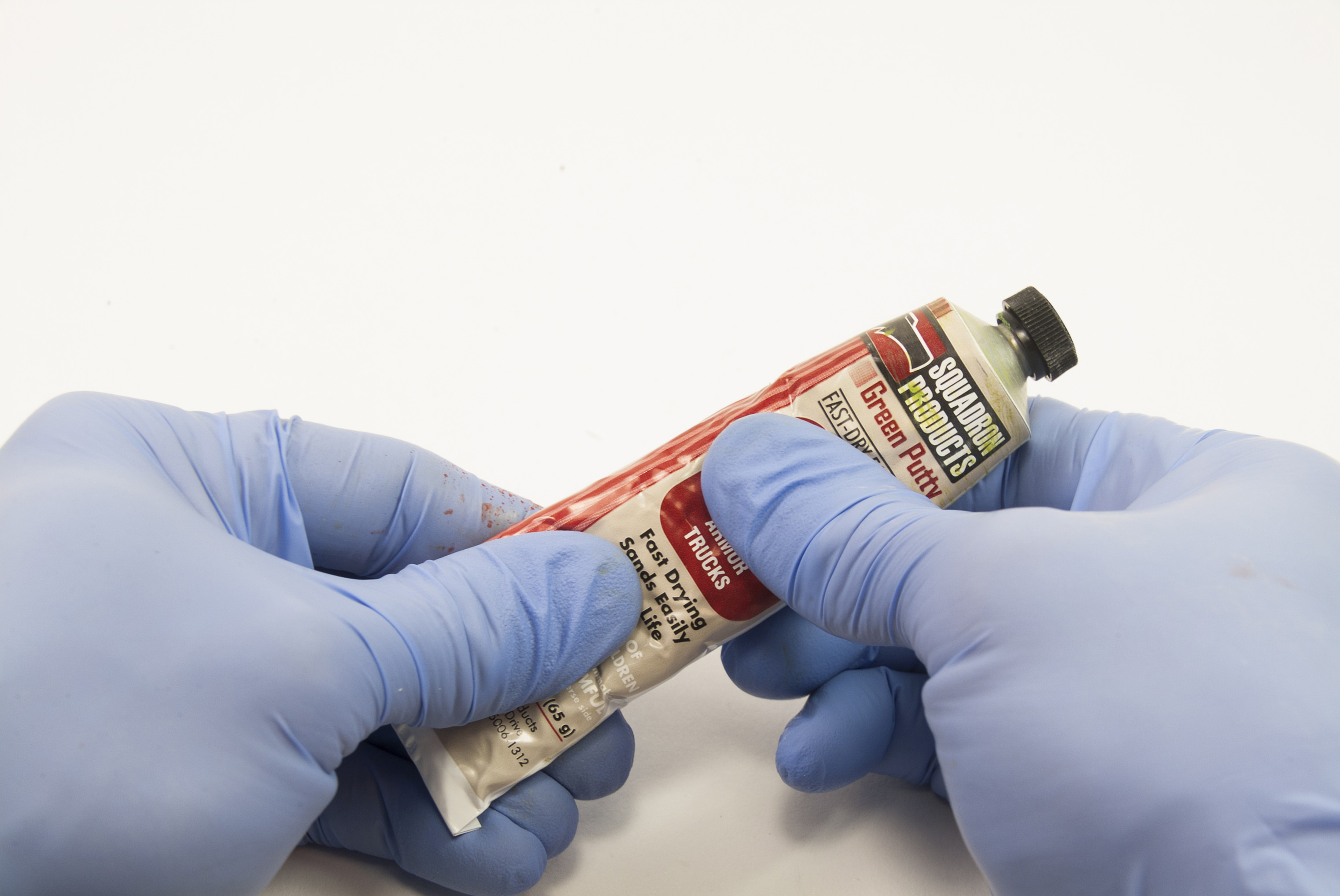

Just like paint that’s been sitting around for a while, the chemicals in solvent-based putties need to be mixed before use. Massage the tube to mix the ingredients.
Before using solvent putties, especially if they’ve been sitting around, massage the tube to mix the chemicals, which can separate as paint does.

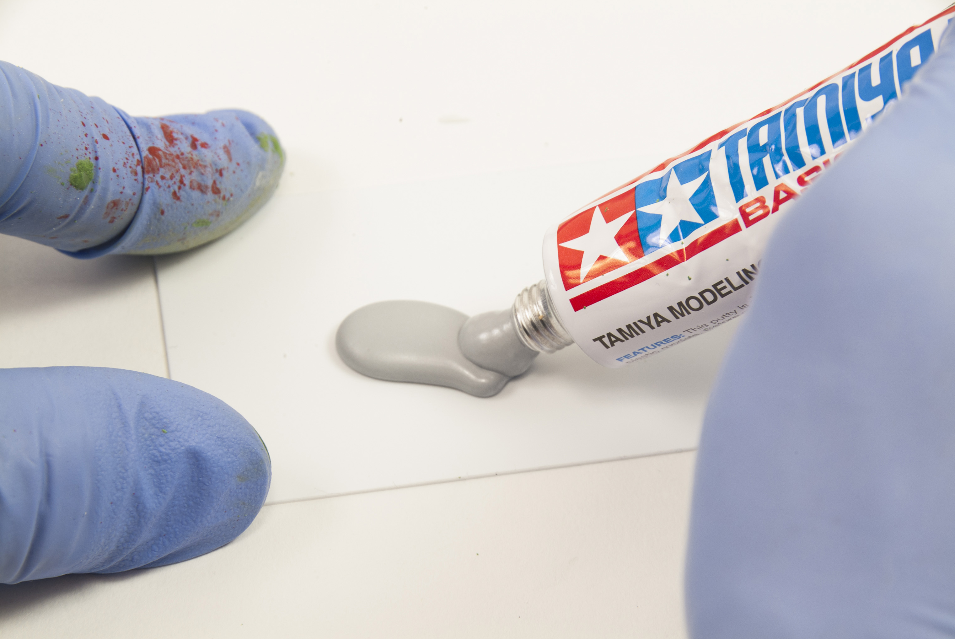

Tamiya’s basic putty is gray, which matches most plastic and is easy to hide under paint. Wildly divergent colors make it easy to see the filler on gray plastic.
Squeeze some of the putty onto a scrap of styrene or a glass palette.

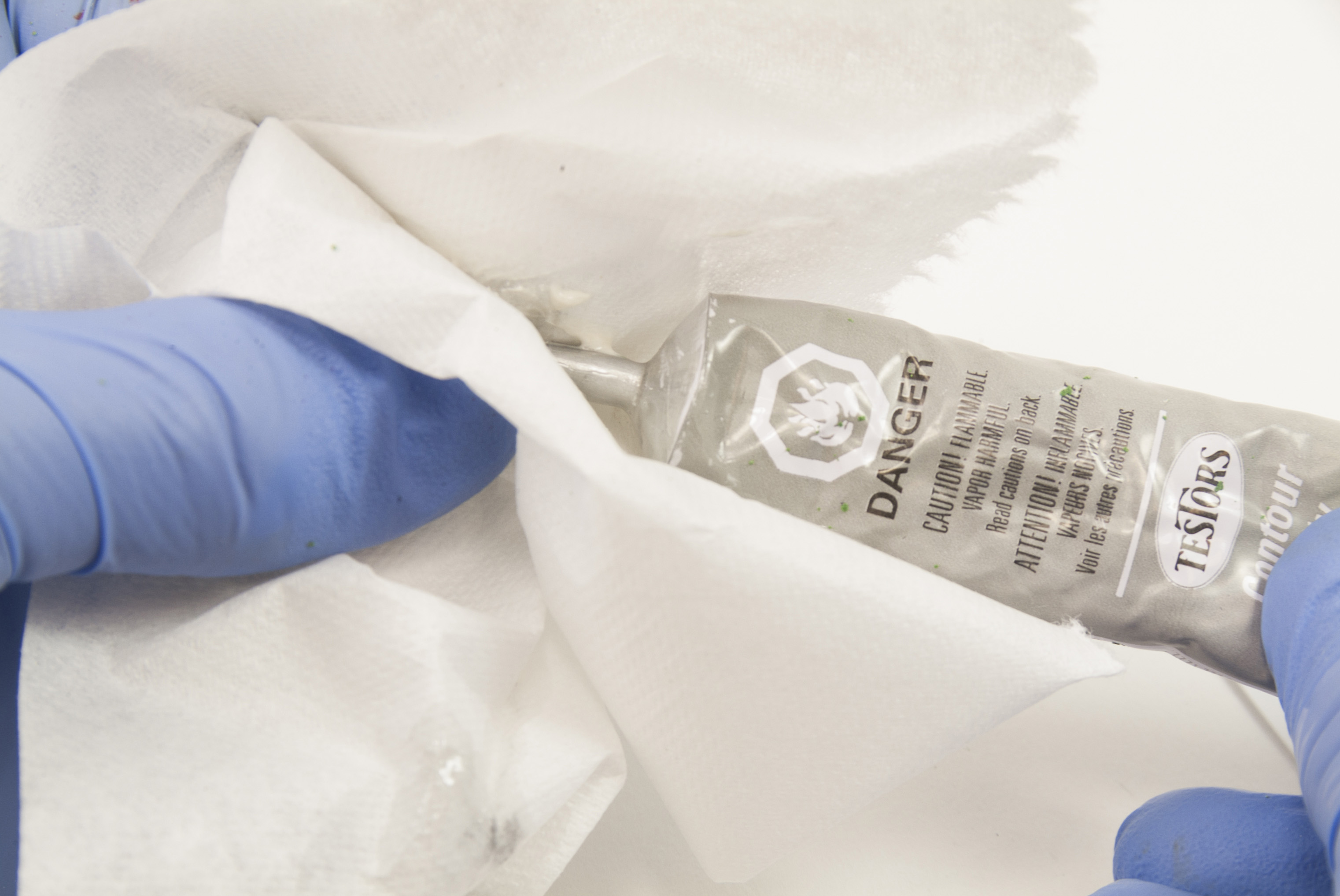

Keep the nozzle clean to extend the life of the putty in the tube.
Replace the lid immediately after, wiping putty from the opening; dry putty can prevent the lid from closing properly allowing the tube’s contents to dry prematurely.

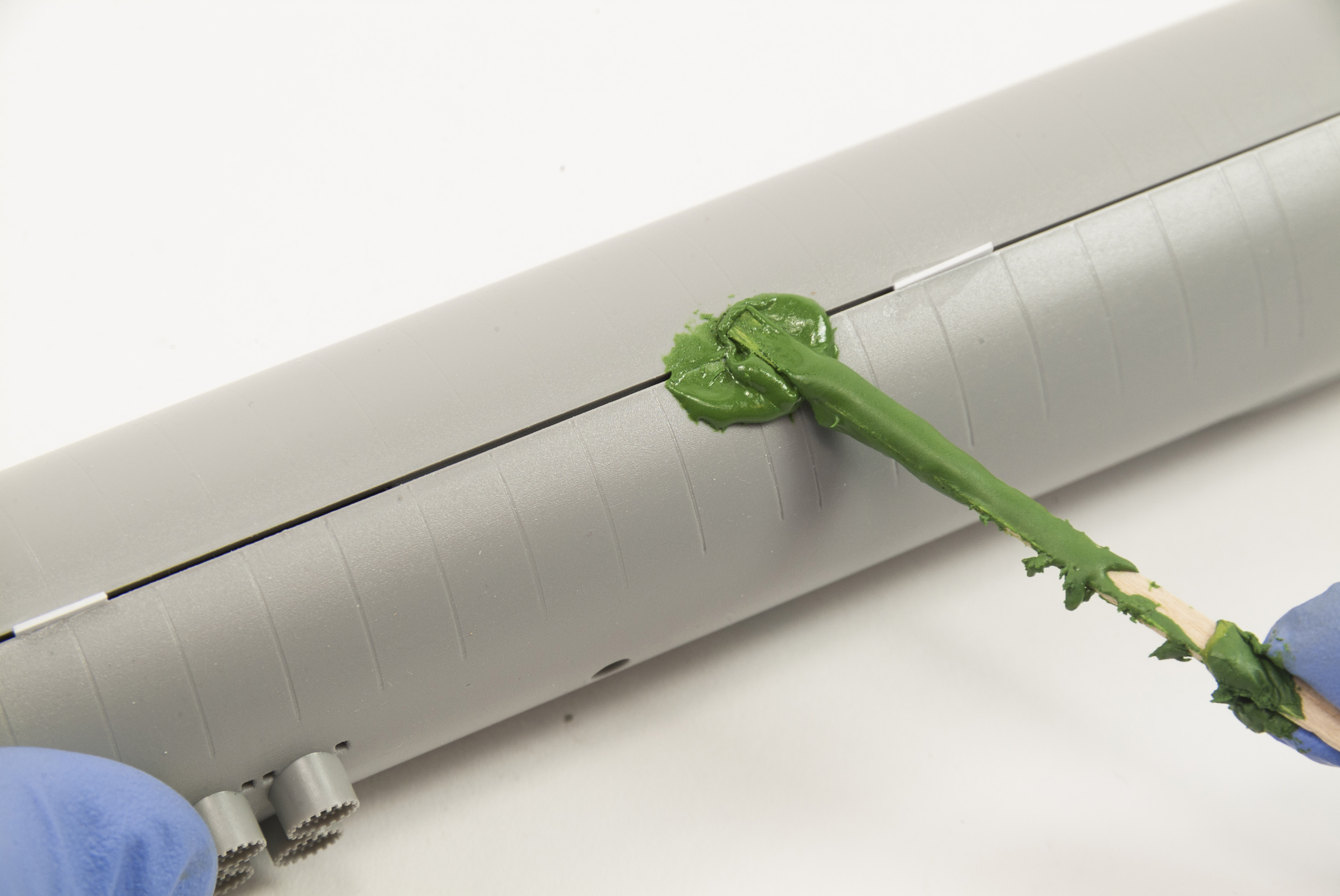

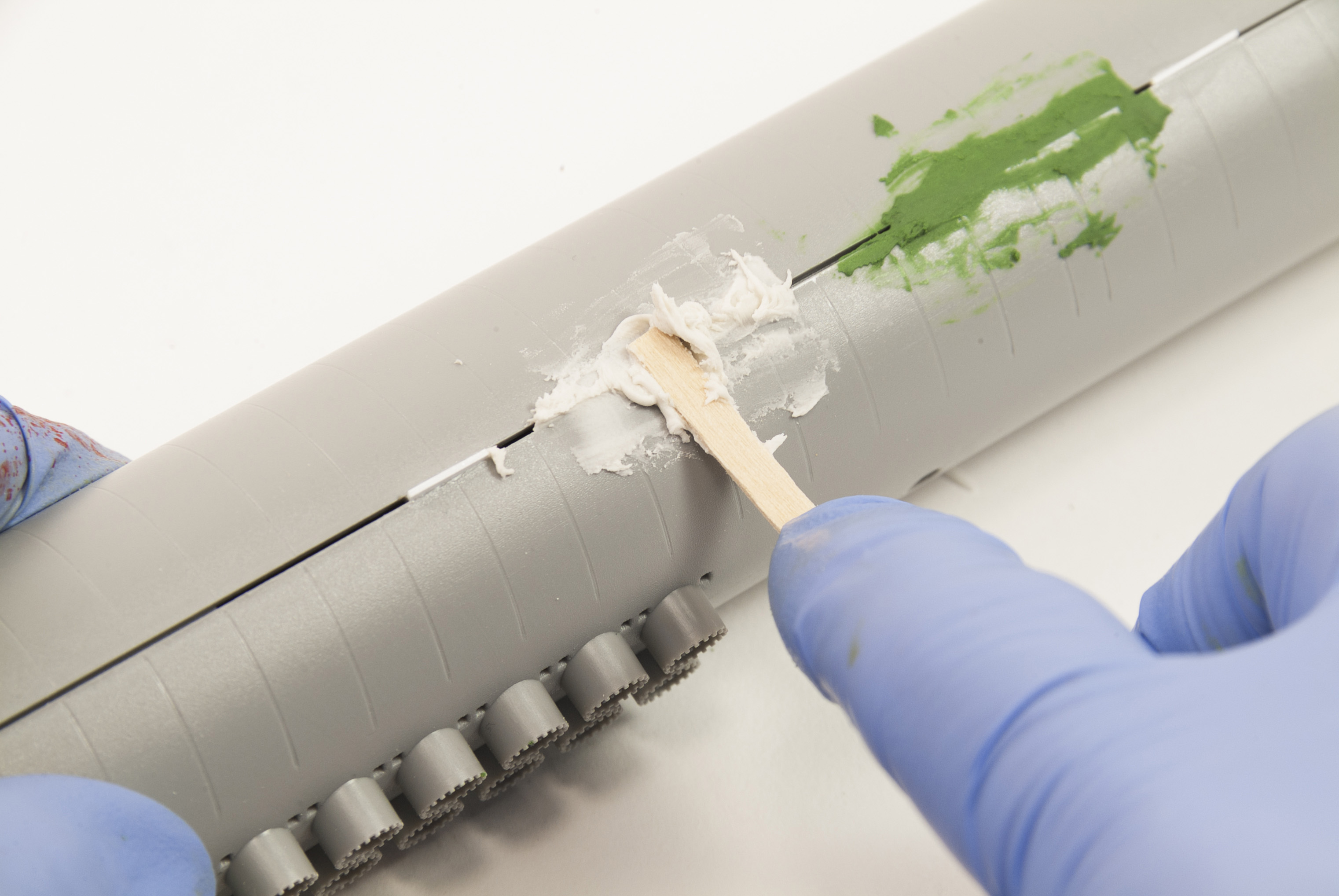

I use disposable wooden coffee stirrers to apply putty.
Apply the putty to the seam to be filled with a flat object.
FSMBB0317_06
Putty needs to get down into gaps to fill them, so I push it through with the stirrer.
Apply more than is needed to fill the gap, as most solvent-based fillers shrink as they dry.
FSMBB0317_07

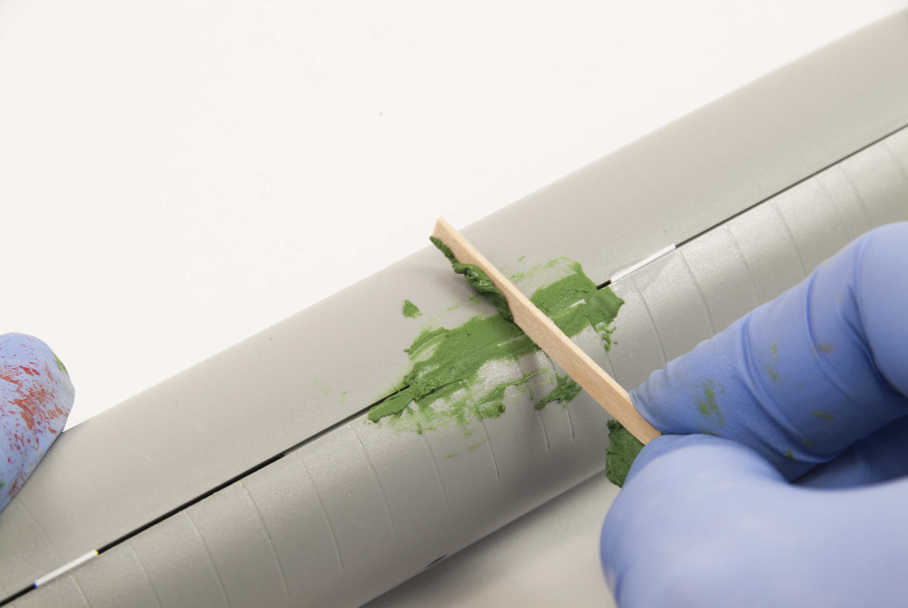

The edge of the stick is ideal for scraping excess putty from around the gap.
You can minimize sanding by scraping some of the excess away while the putty is wet. But leave some on either side and never scrape it flush.
Most solvent-based putty requires several hours to set hard in preparation for sanding; I usually leave it overnight.

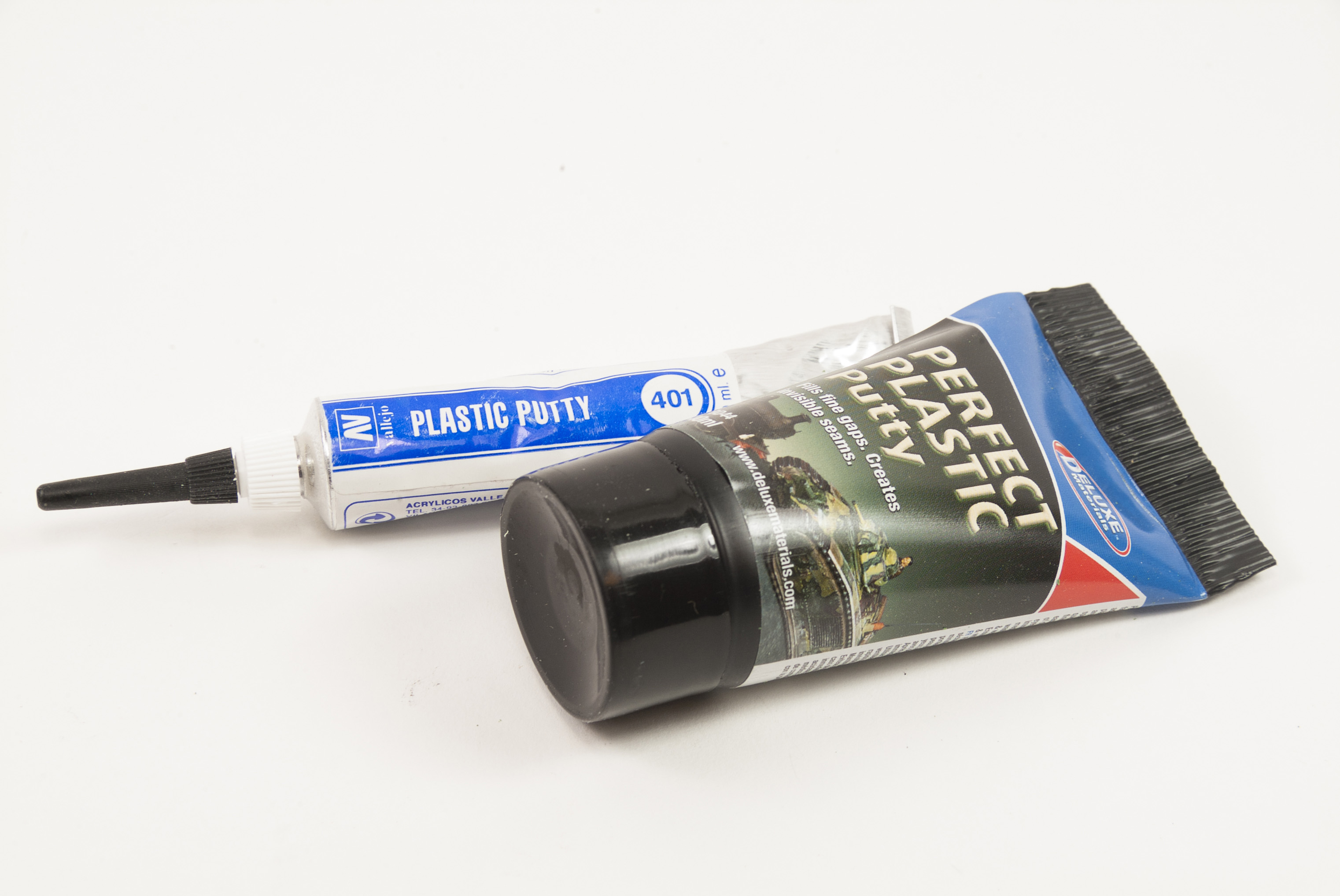

Deluxe Materials Perfect Plastic Putty and Acrylicos Vallejo Plastic Putty are popular with modelers.

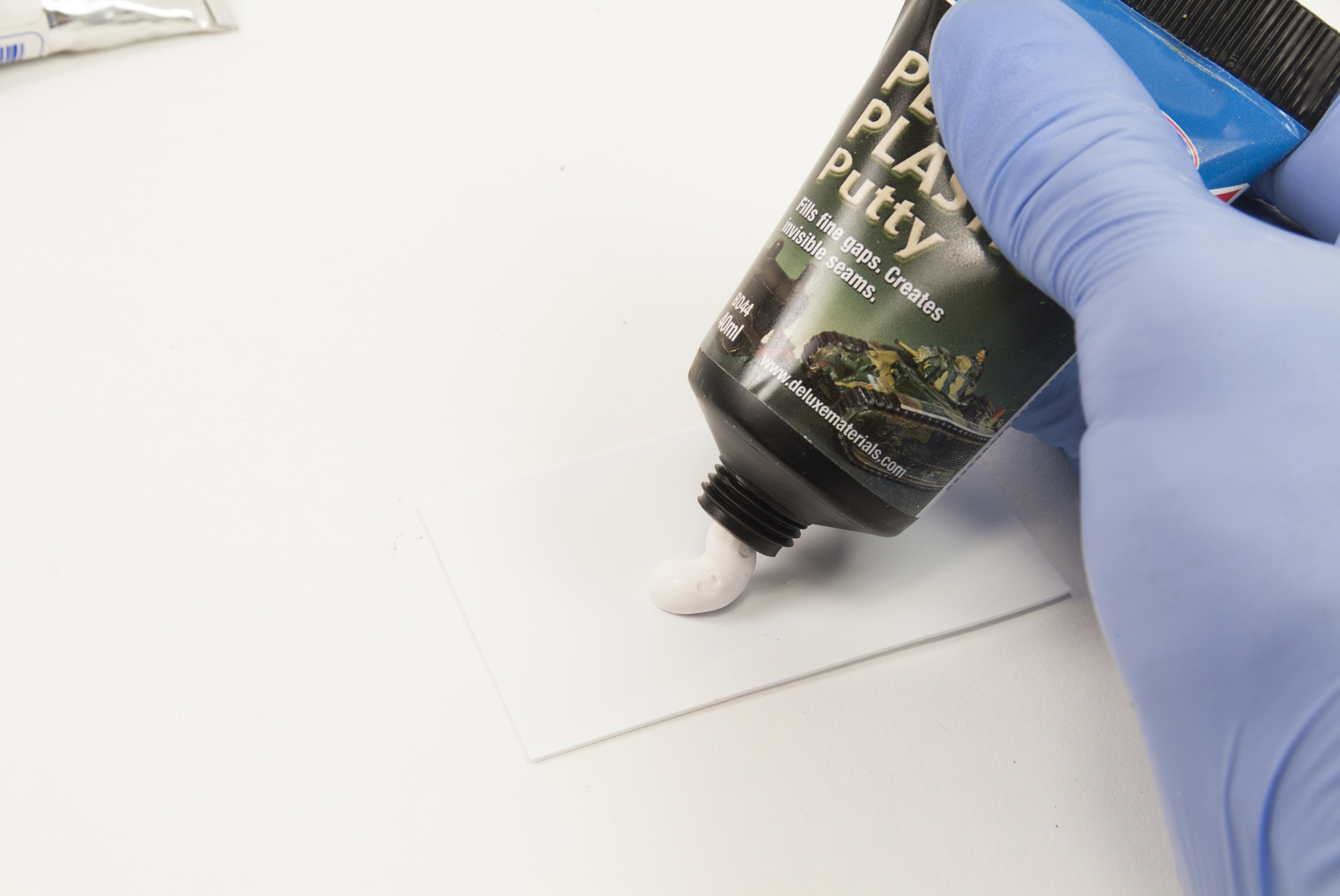

Water-based putties are a little thinner than solvent-based fillers, and they don’t shrink as they dry.
Unlike their solvent-based cousins, these putties have little odor, can be handled with fewer precautions, and rarely need mixing before use. The consistency of toothpaste, they apply in much the same way as others.

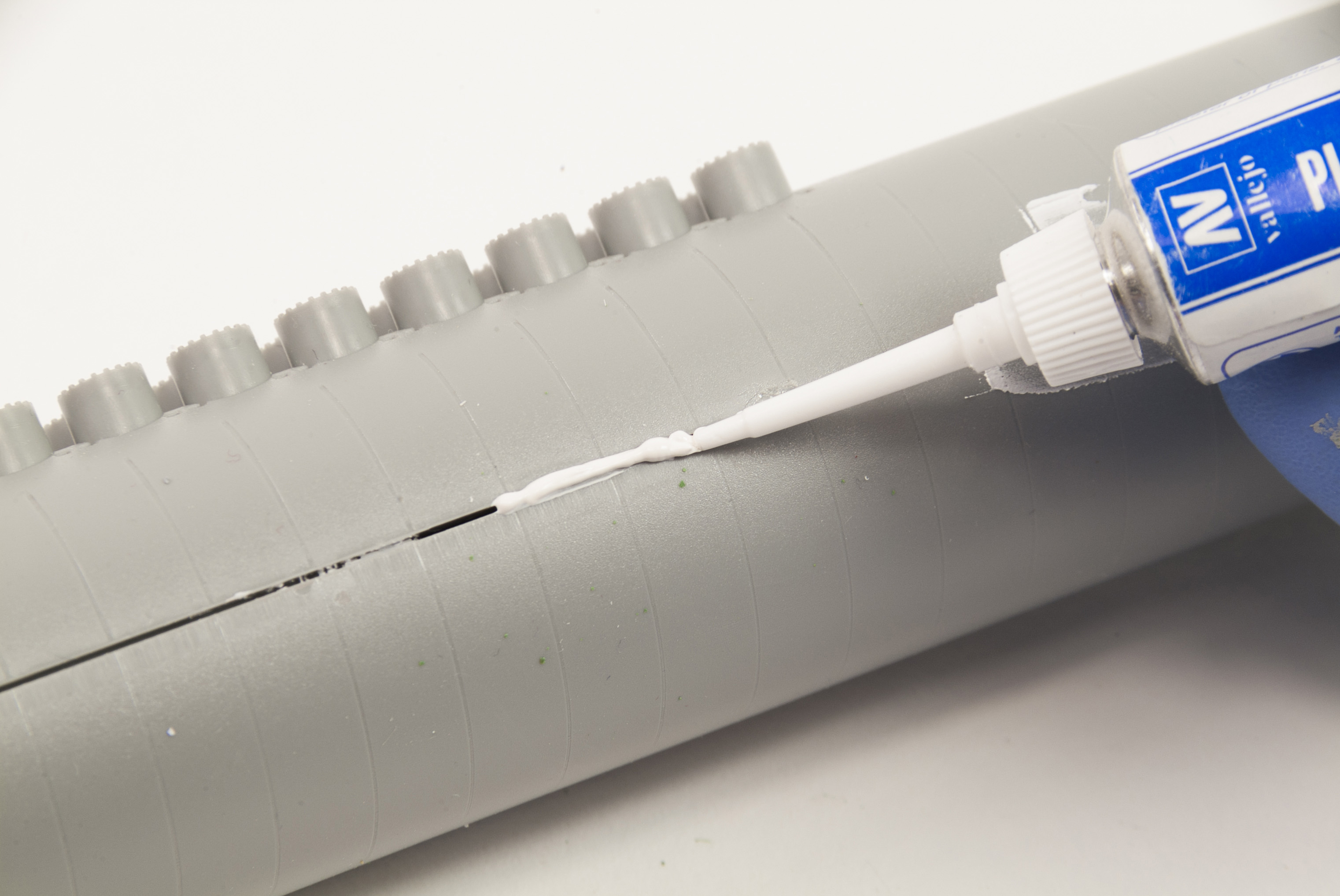

Low viscosity makes it possible to squeeze water-based putties through fine tips, so they can be applied directly to tight spots.
But there is no need to apply excess; they don’t shrink as they dry. You can use a flat tool to spoon them over a gap. Or, because of the thin consistency, you can squeeze them directly into a seam.

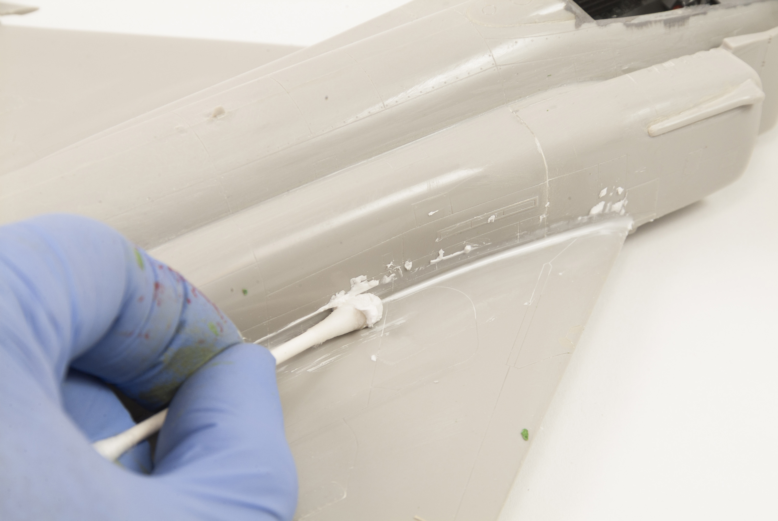

After applying Perfect Plastic Putty to the wing root of a Phantom, I remove the excess and smooth the finish with a damp cotton swab.
Excess can be removed with a wet finger or cotton swab, which makes water-based putties useful for seams like wing roots. After applying putty, run a damp (not wet) cotton swab along the seam.

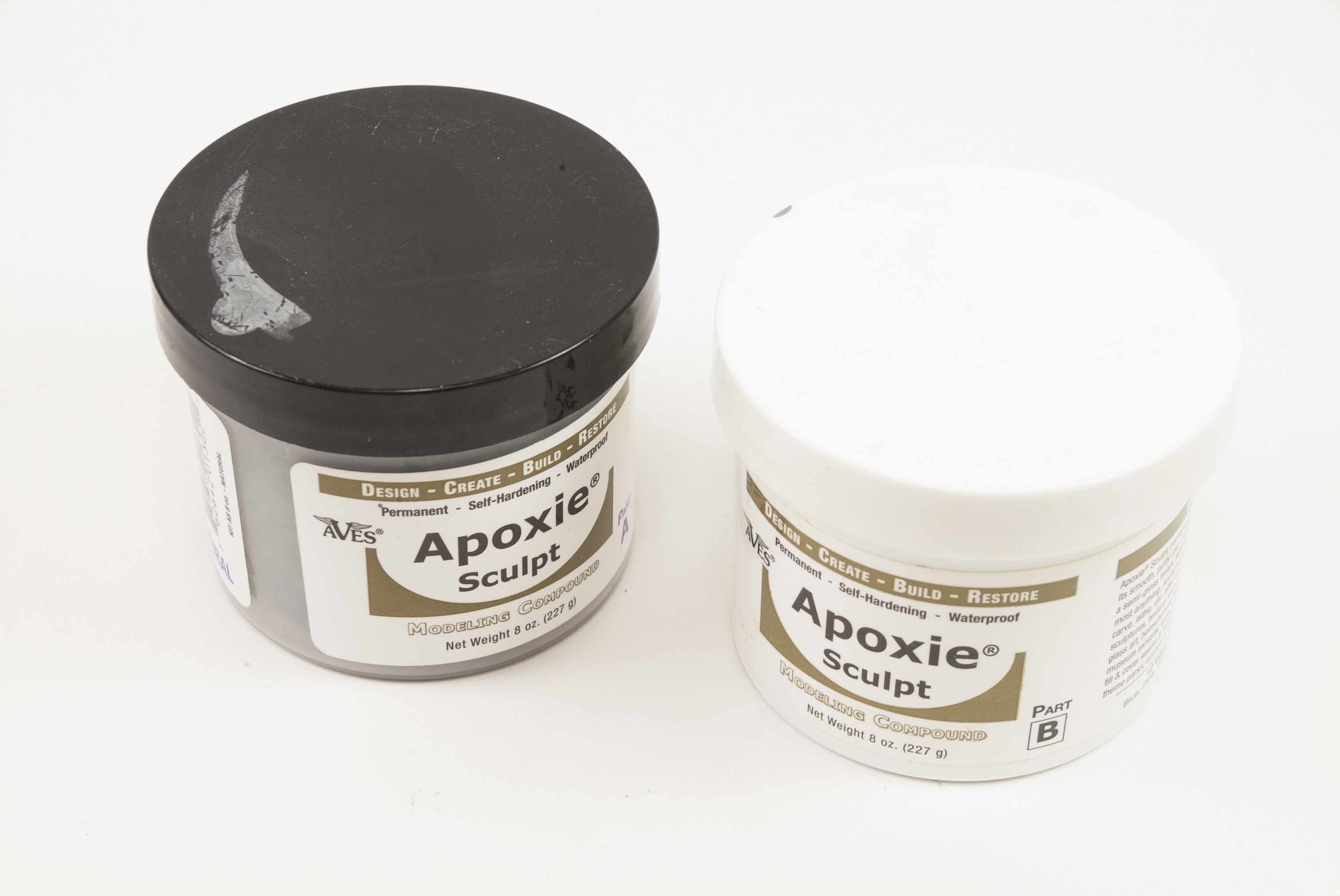

Apoxie Sculpt provides plastic containers for each part. Avoid contaminating either container as you scoop them out.

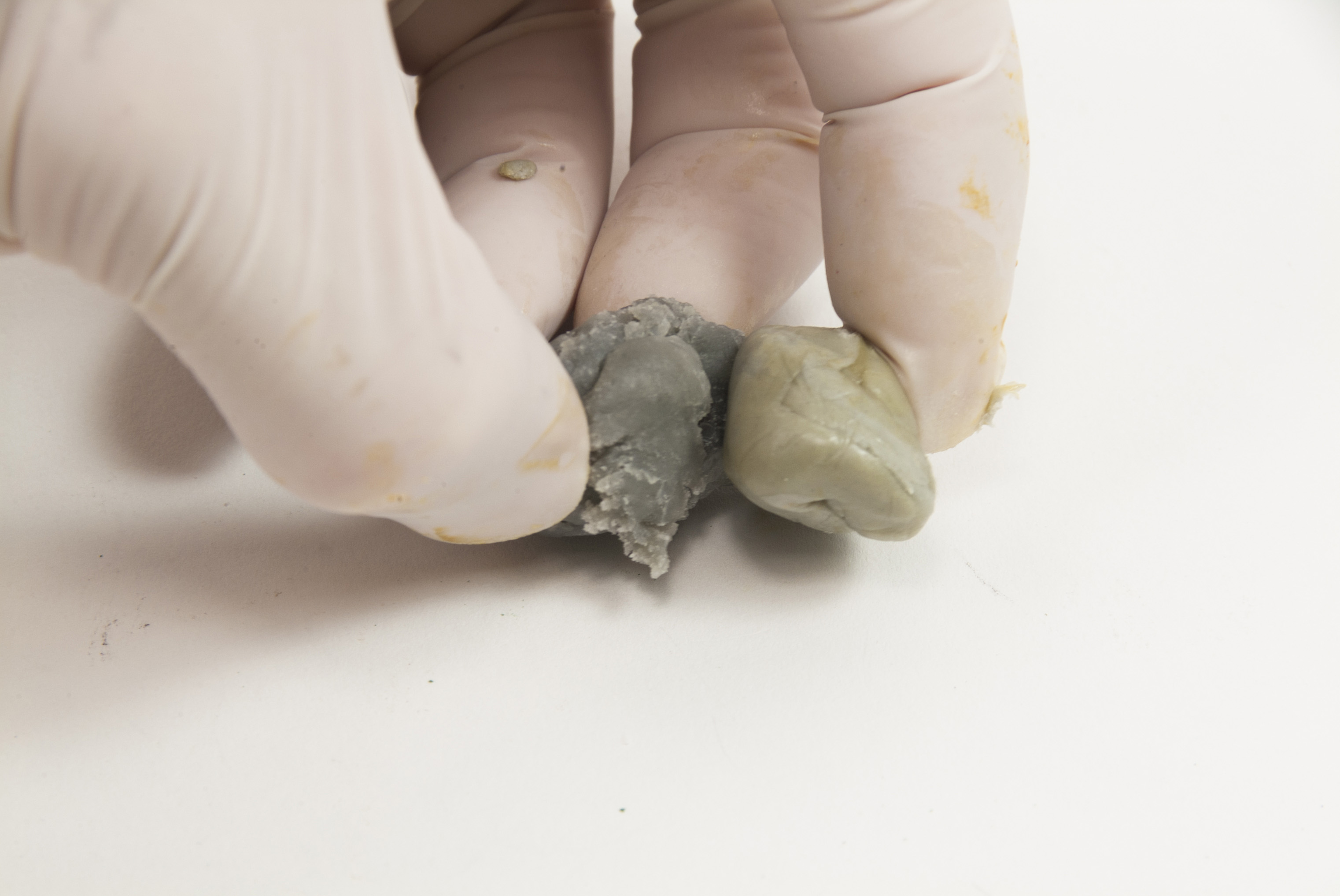

Get the parts as equal as possible to ensure the epoxy putty sets properly.
Take equal amounts of each part using a clean tool for each; avoid contaminating one with the other and kicking off the reaction inside the container.

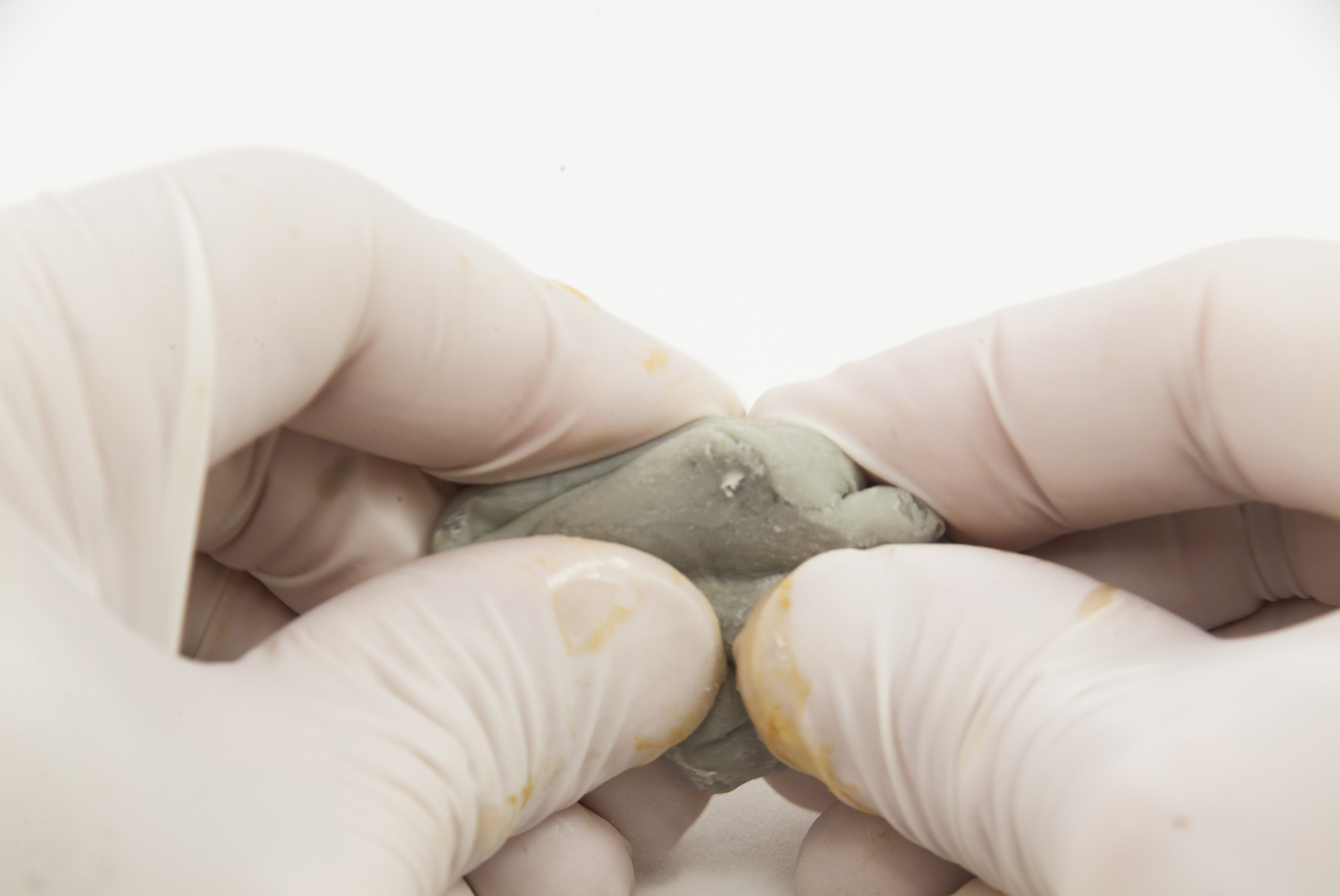

Knead the components together until the color is uniform. Inadequately mixed putty won’t set.
Knead the parts together until the color is uniform — unlike a good steak or cake, you don’t want marbling! You don’t need to wear gloves for this process, but it will keep your hands clean. If you choose not to wear them, wash your hands after mixing to minimize stickiness.

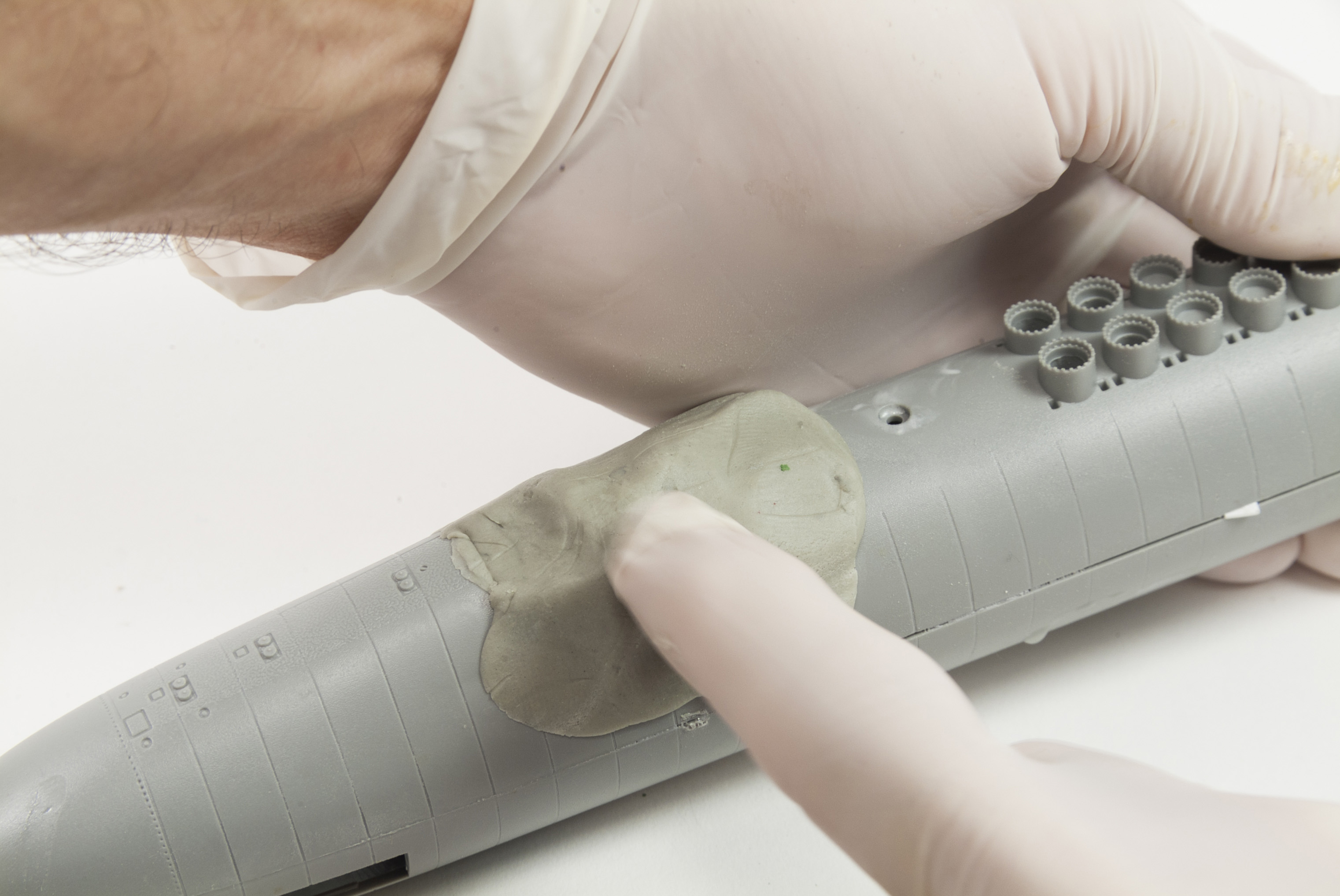

I push the putty into a gap on a submarine hull, but the filler can be sculpted on creatures or clothing for figures.
Take a little of the putty and push it into the gap.
FSMBB0317_17

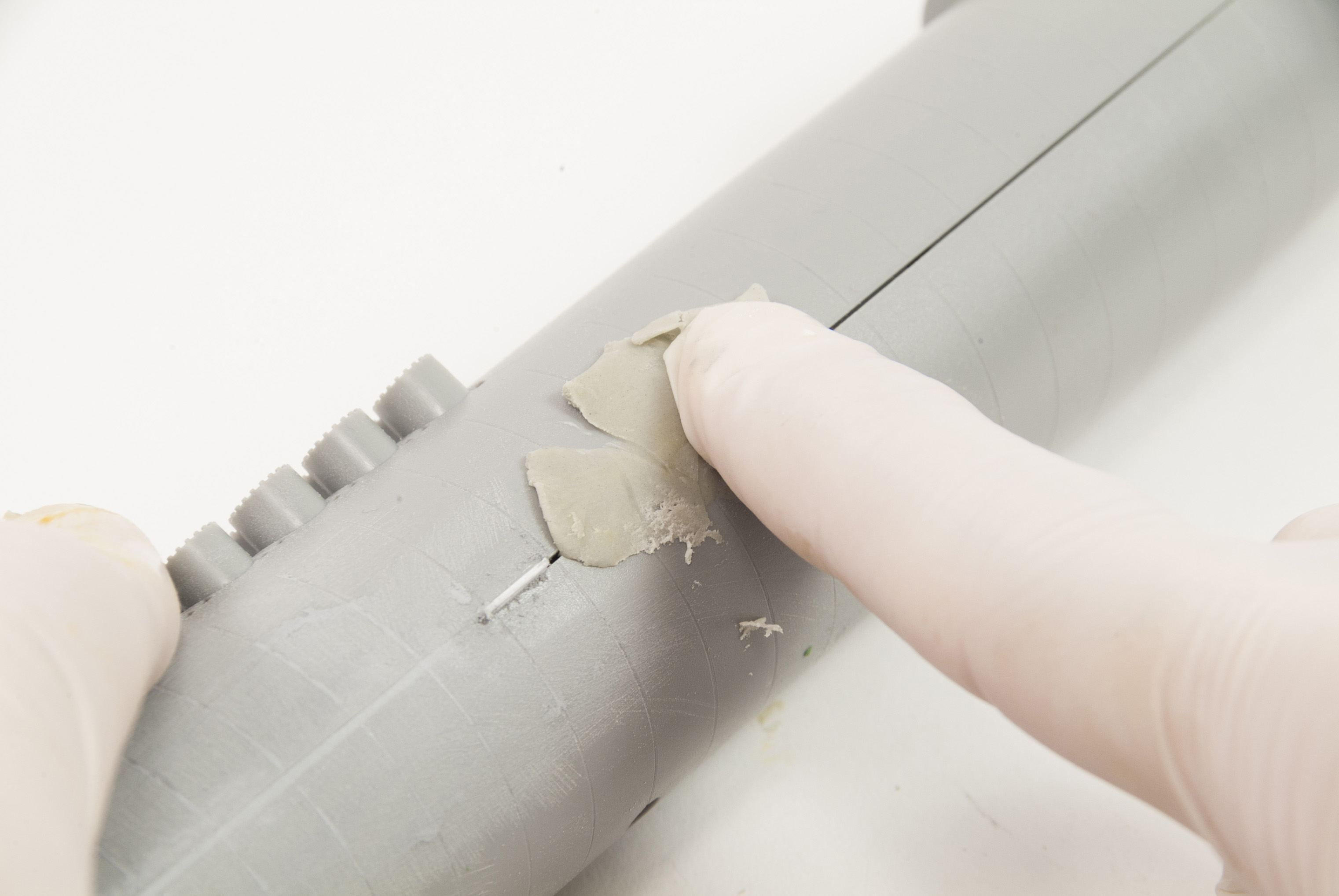

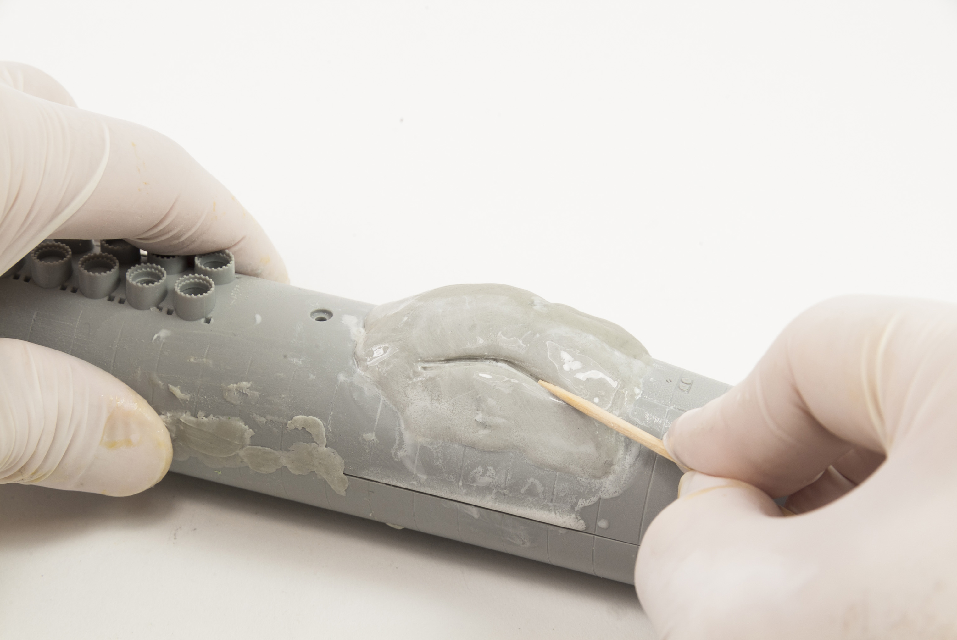

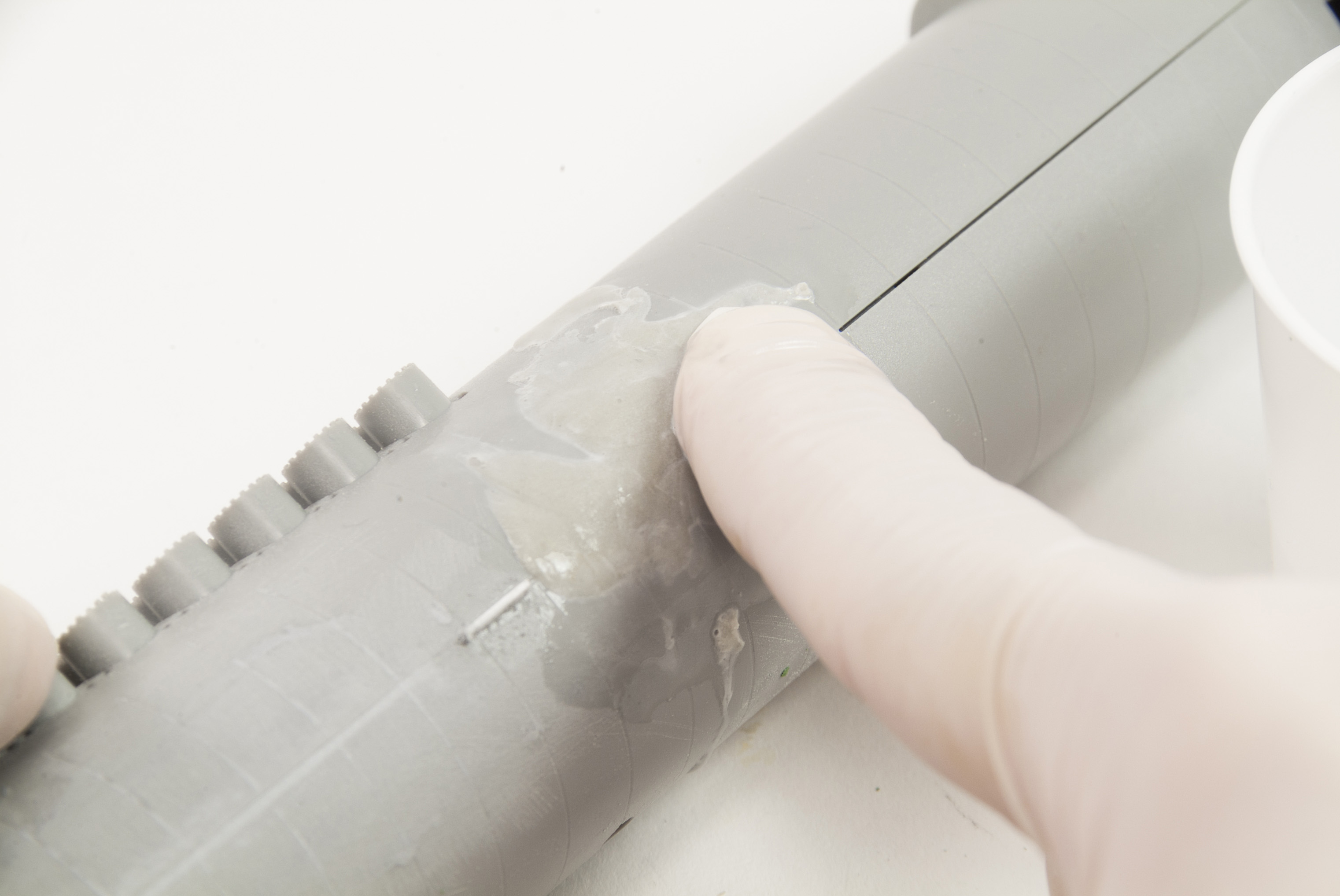

A little water on a finger will smooth the surface of the putty and blend the edges into the surface.
Epoxy putty adheres well enough, but it can be helpful to rough up the surfaces to ensure it stays put. Wet your finger to smooth and shape the putty. It will take several hours to set, giving you plenty of working time. Epoxy putty works for standard gap-filling, but it comes into its own on figures where the ease of blending and sculpting can be used to replace or enhance organic detail.

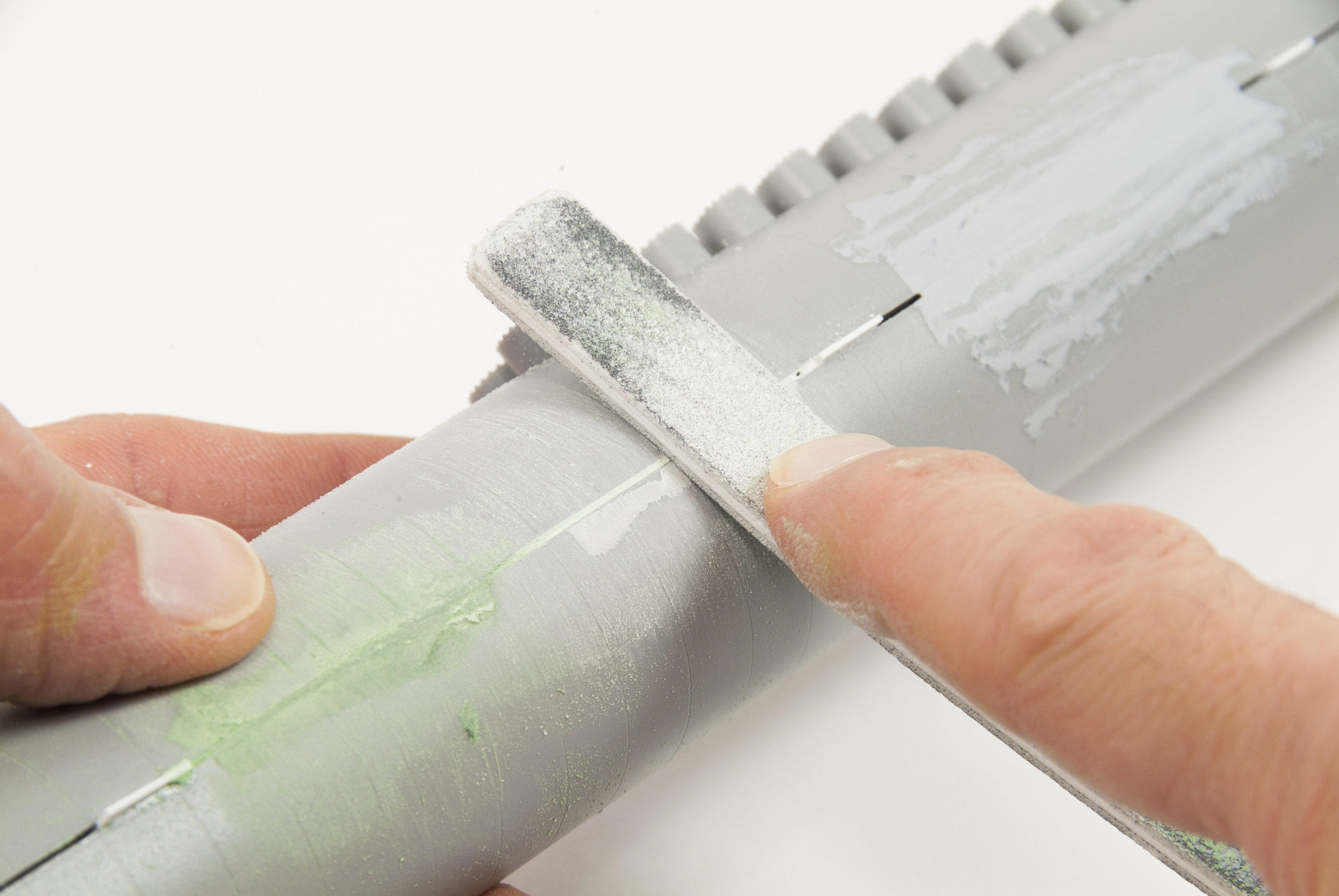

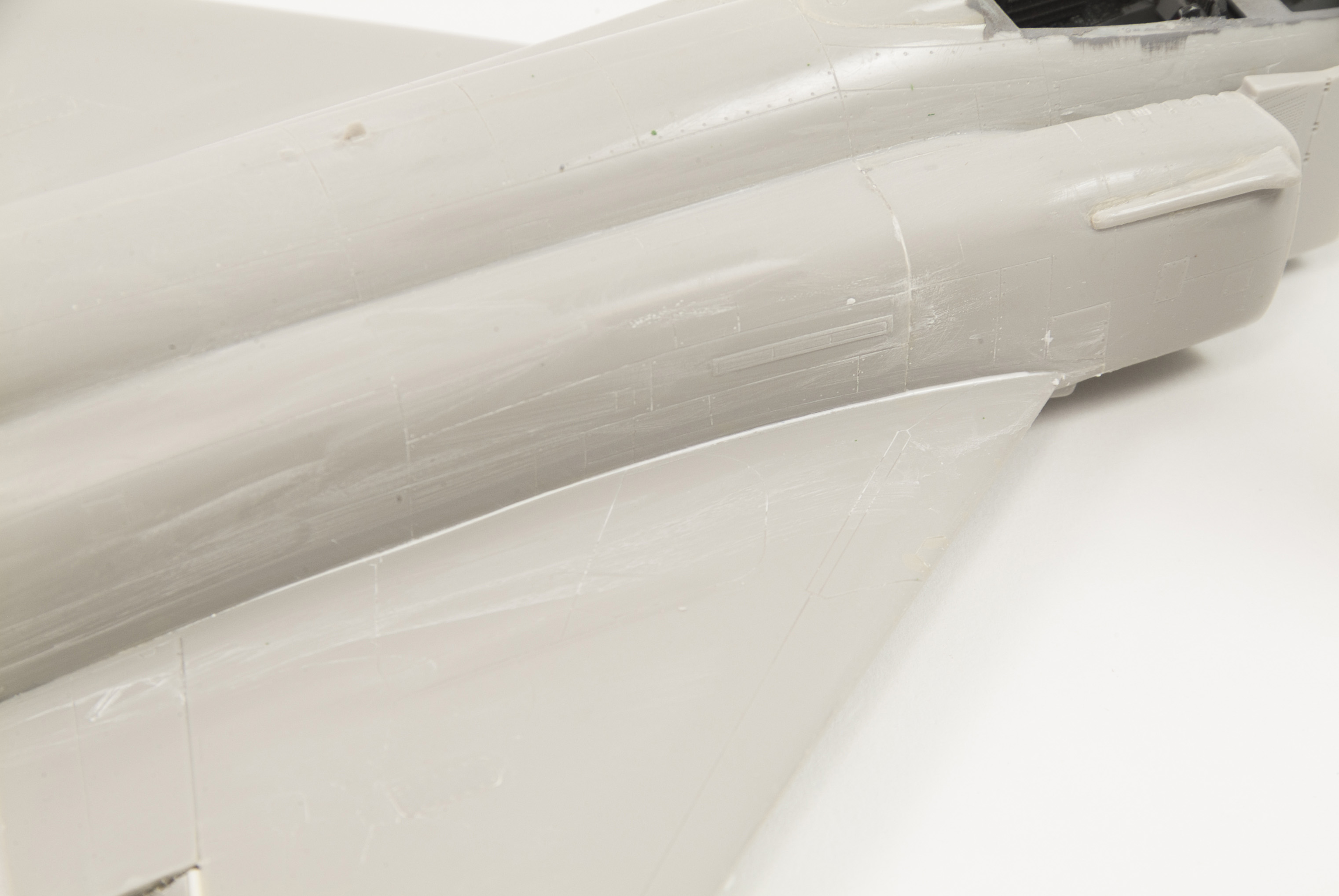

Solvent- and water-based putties can be easily sanded once dry. Epoxy putty is harder and takes more elbow grease to smooth.
Sanding and painting
Once putty is dry, it can be sanded smooth. Sand with the shape to properly blend the filler and plastic. If shrinkage created a shortfall, add more putty, let it dry, and sand again. Wear a respirator and eye protection when sanding putty; the dust is an irritant.

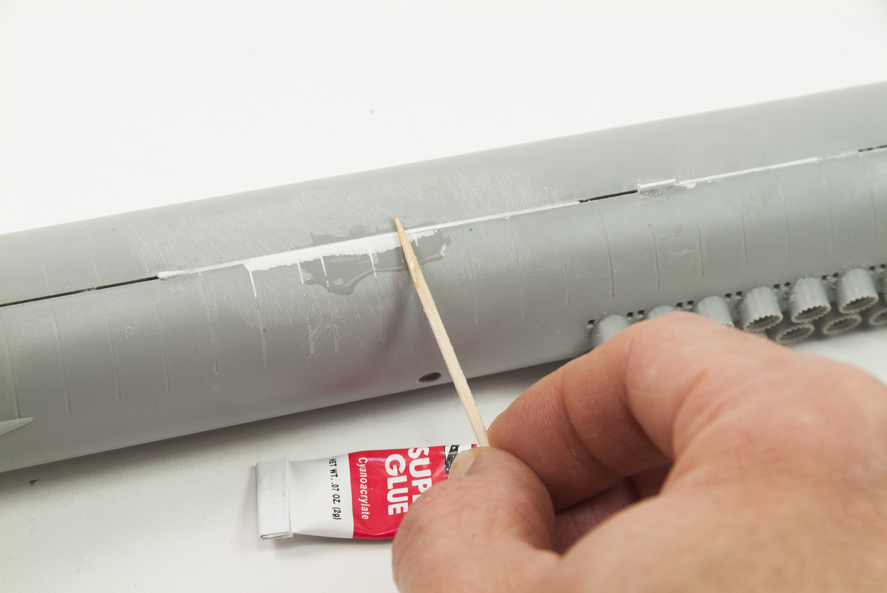

Thin super glue dries as hard as plastic; I run a little over large areas of filler to seal the surface for painting.
In most cases, putty mimics styrene and disappears under paint. But large fills may absorb paint differently. I seal these areas with a little super glue, then sand them smooth.
