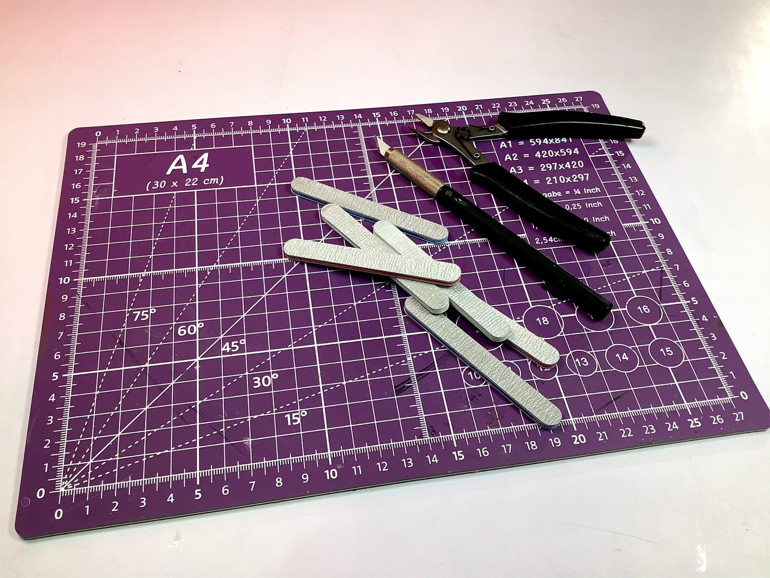

Next, to build Gundam model kits, you’ll need some basic tools: nippers or side cutters, a hobby knife, and a variety of sanding sticks in grits from coarse to extra fine.
Experienced Gunpla modelers recommend you have both a double-bladed and a single-bladed nipper — the first for for the initial cut from the sprue and the second for a more precise cut. However, a single-bladed nipper can be an expensive tool, and isn’t strictly necessary, so let’s stick with a double-bladed nipper for this kit.
A cutting mat isn’t a requirement, but it’s a good idea to prevent damaging your work surface.

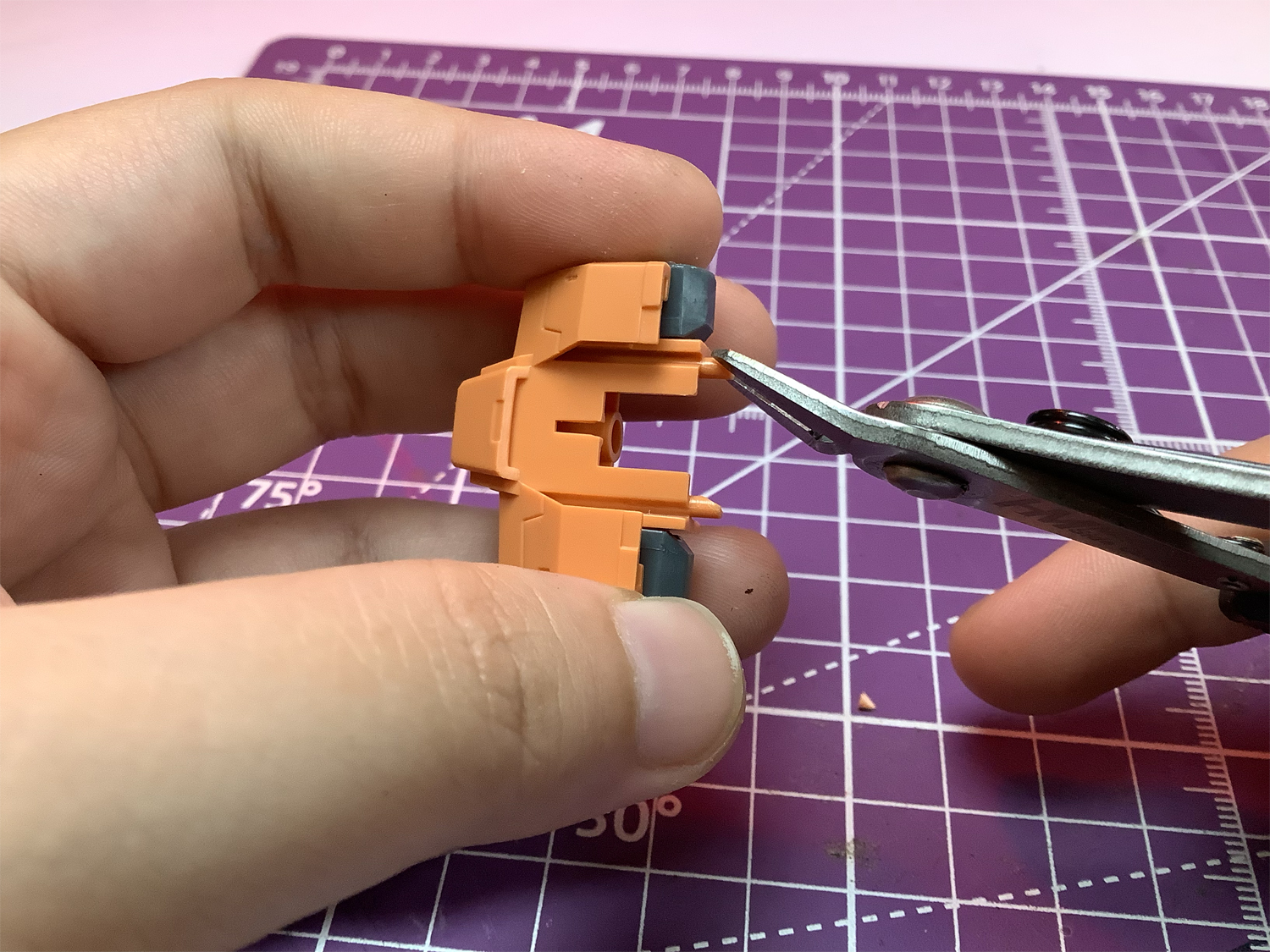

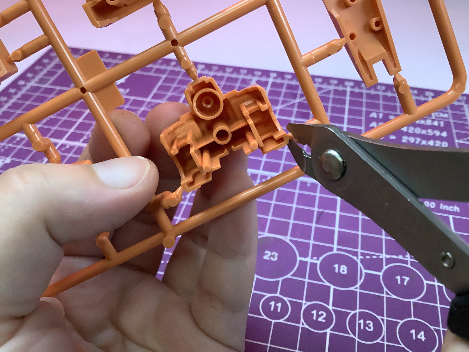

When removing parts from sprues in Gundam model kits, make sure to cut away from the part and never try to cut as close as possible. Otherwise, you’ll run the risk of gouging the part itself or creating white marks, which come from pinched or stressed plastic. When cutting the Gunpla parts, leave a couple of millimeters between the nipper and the part.

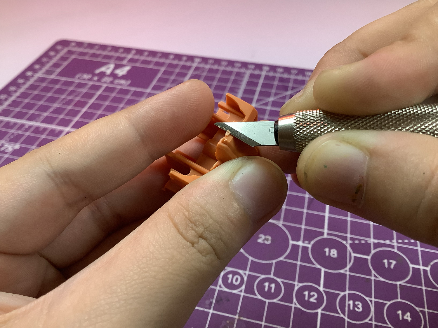

With a new blade in your hobby knife, slowly shave away the nub you left on the part when you removed it from the sprue. Don’t try to take it off in one go because you’ll risk gouging the Gundam plastic model part or creating stress marks. Take it slow, removing thin layers until it is almost gone.
Also, find a comfortable way to hold the knife and BE CAREFUL. Hobby knives are extremely sharp.

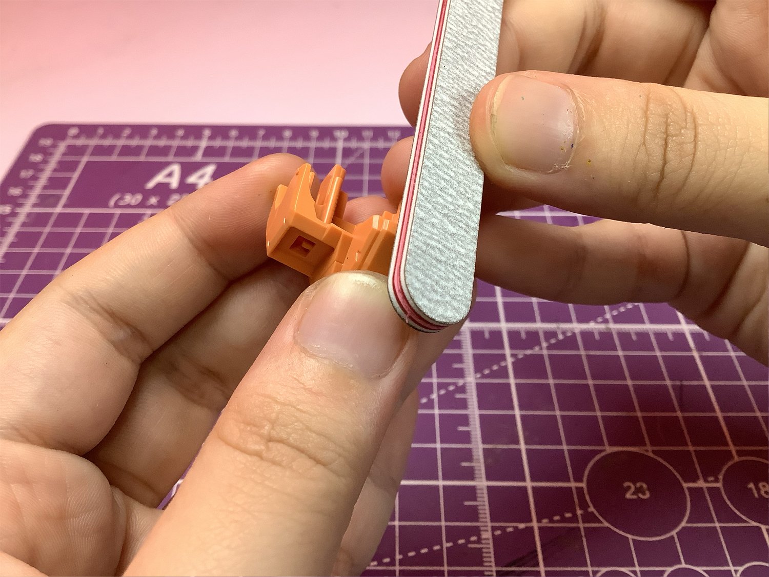

Finally, to finish removing the sprue nub on the Gunpla part, rub it away with progressively finer sanding sticks. Since this Gundam mobile suit won’t be painted, you’ll want to get the plastic as smooth as possible, working up through 2500- or 4000-grit will work fine.
But if you were going to paint Gundam model kits, you can stop at 1000 grit to give the primer something a little better to stick to.
It may seem strange but removing sprue nubs varies in difficulty depending on the color of the plastic. White plastic is the easiest to work and sand to hide nubs. Be more careful with darker colors in Gundam model kits because they tend to be more brittle and prone to stress.

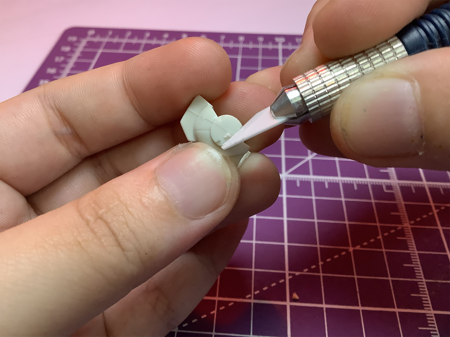

Aside from runner nubs, you might also encounter mold lines on Gundam plastic model parts. These are produced where molds meet when the sprue is made. Here, I’m removing a mold seam with a ceramic scraper, but you can also use the edge of your hobby knife. Clean up any rough spots with standing sticks just like with sprue nubs.

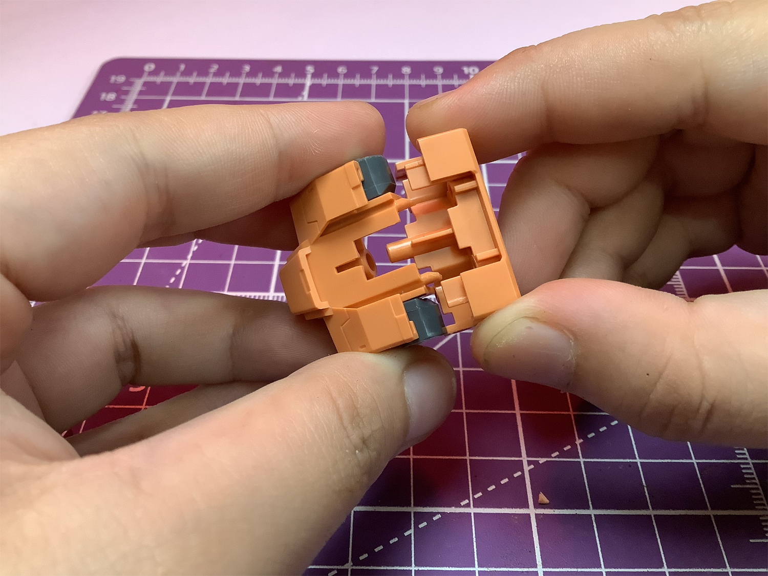

Once all nub marks are removed from your Gunpla parts, it’s time to assemble! If you plan on painting or disassembling your Gundam plastic model in the future, slightly cutting the male pegs at a 45-degree angle makes the process easier. Then just follow the instructions until you’ve completed building!

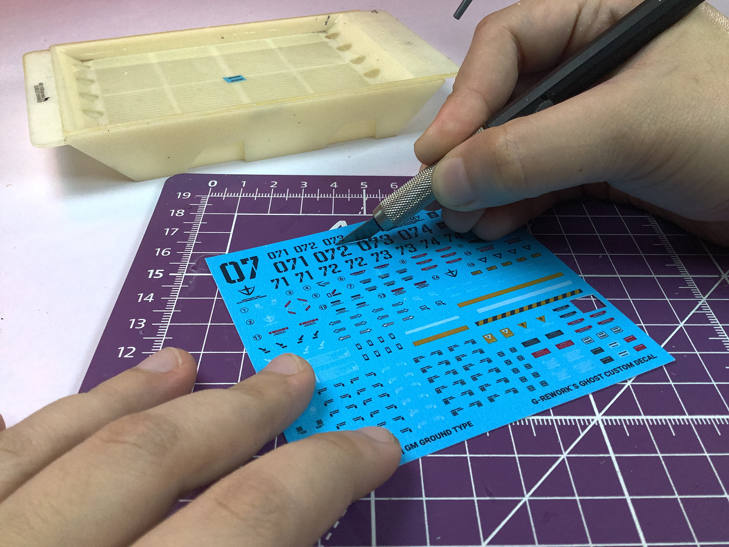

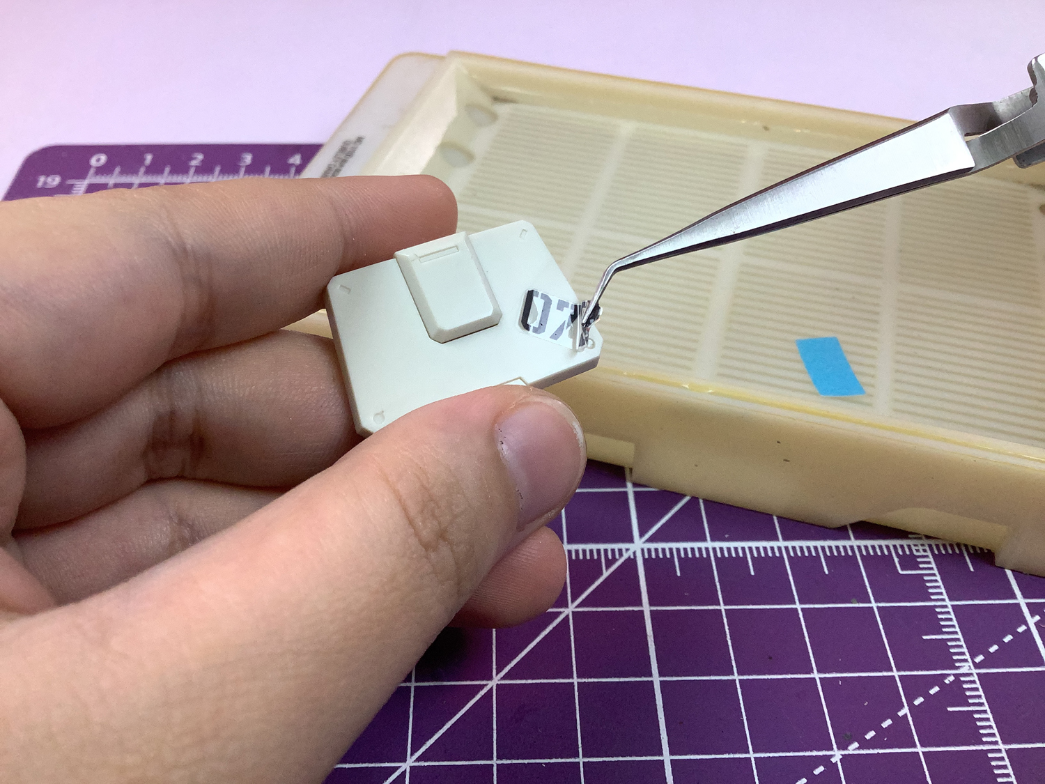

To place waterslide decals on a Gundam plastic model, you’ll need a bowl or saucer filled with warm (not hot) water for you to submerge the decals. You can add white vinegar to the water (up to a 2:3 ratio) because it acts as a natural decal softener to help the film settle on curved or uneven surfaces. Cut out the decal with a sharp hobby knife or pair of scissors and drop it into the water.
FSDGM1222_14
Some decals take longer than others to loosen from the backing paper, but usually no more than 30 seconds. Pull the decal out of the water with tweezers, slide it off the backing paper and onto the part.

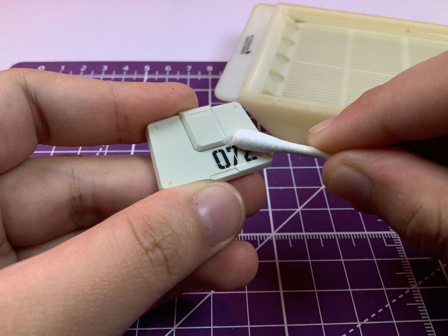

Make sure the decal is aligned where you want it on your Gundam model kit and then gently roll a cotton swab across the decal to remove excess water.

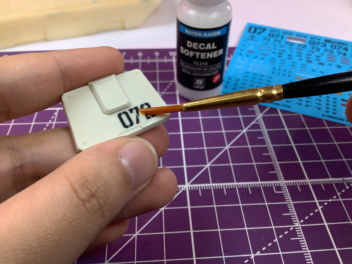

Once the decal is down and you’re sure it won’t accidentally move, brush decal softener onto the marking. It will help the decal settle and look like it’s painted on the surface of the Gundam plastic model.

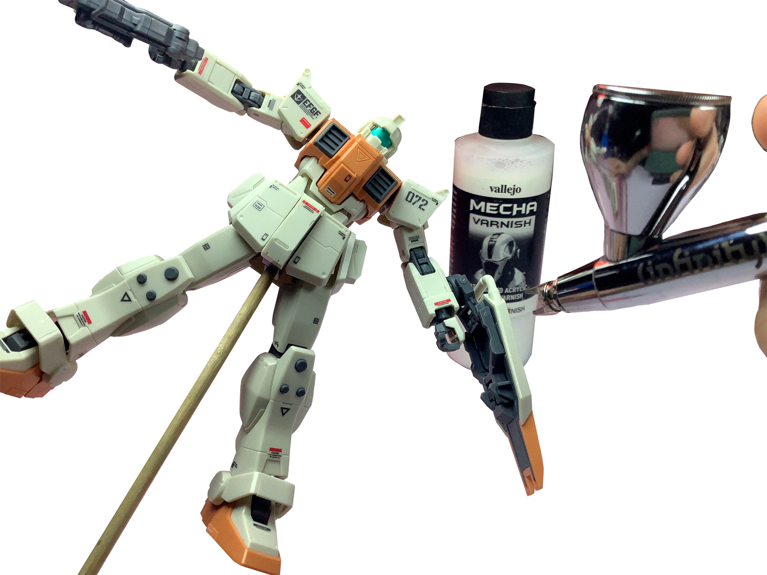

Tamiya Panel Line Accent can dissolve bare plastic, so you’ll need a protective layer. Before applying the panel line color, spray your Gunpla with a coat of acrylic gloss clear.  You can use either a spray can or an airbrush. The clear varnish will seal the decals and creates a smooth finish for the panel line color to flow along.
No need to disassemble your Gundam model kit, just spread the limbs and spray on the clear coat.

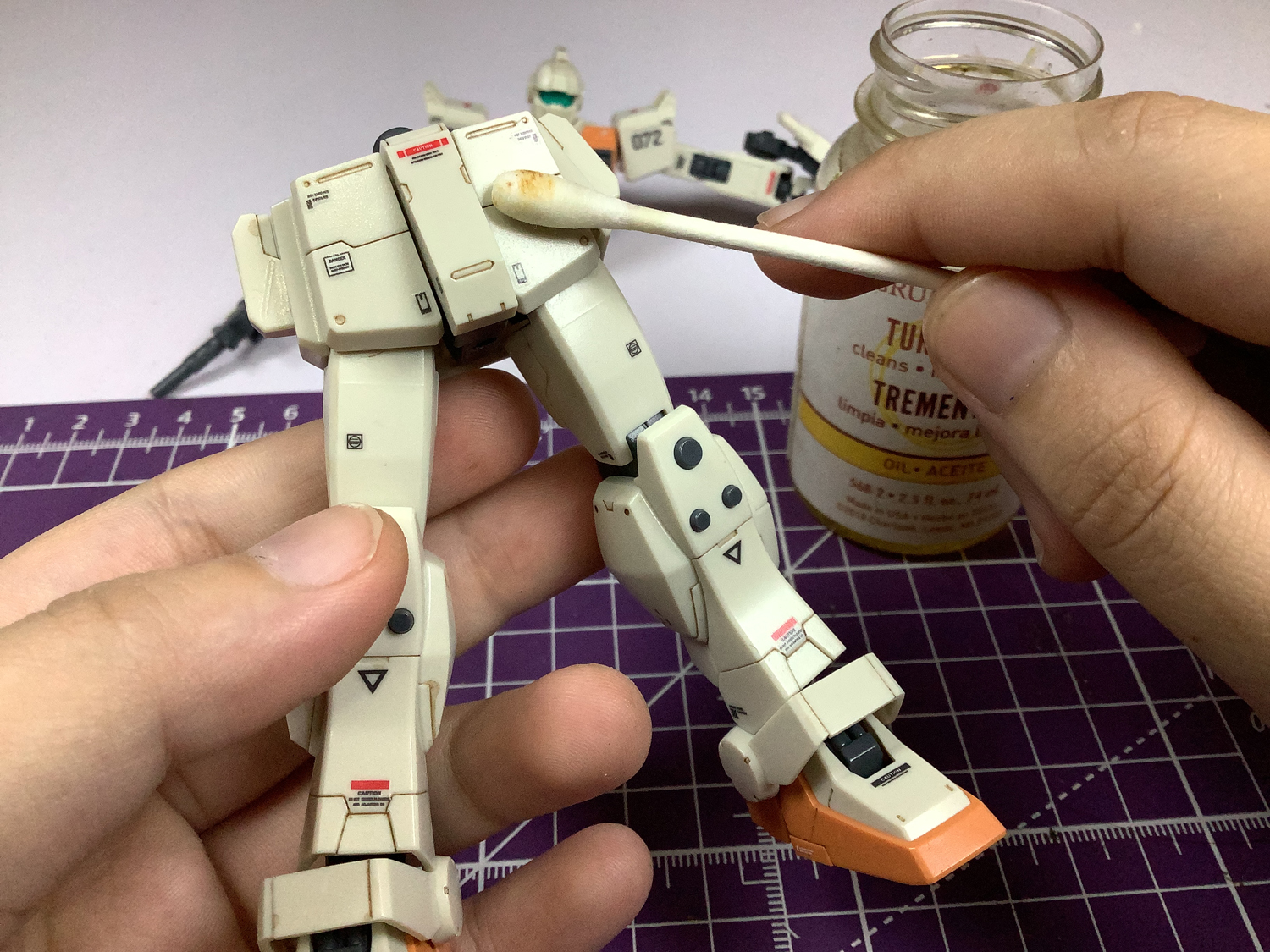

After letting the panel line color dry for a couple of seconds, dampen a cotton swab with the cleaner of your choice (mentioned in above) and wipe away any excess panel liner. Note: The swab does not have to be soaked with thinner; just enough to do the job.

And lastly, spray a topcoat of clear varnish over your Gunpla. The topcoat ensures the decals and panel lines on your Gundam model kits will not rub off or smudge and protects the model during handling.
For this, you’ll want to use either a clear acrylic or enamel paint. Lacquer could react with the Tamiya Panel Line Accent. You can choose a gloss, satin, or flat sheen—whatever you prefer.
