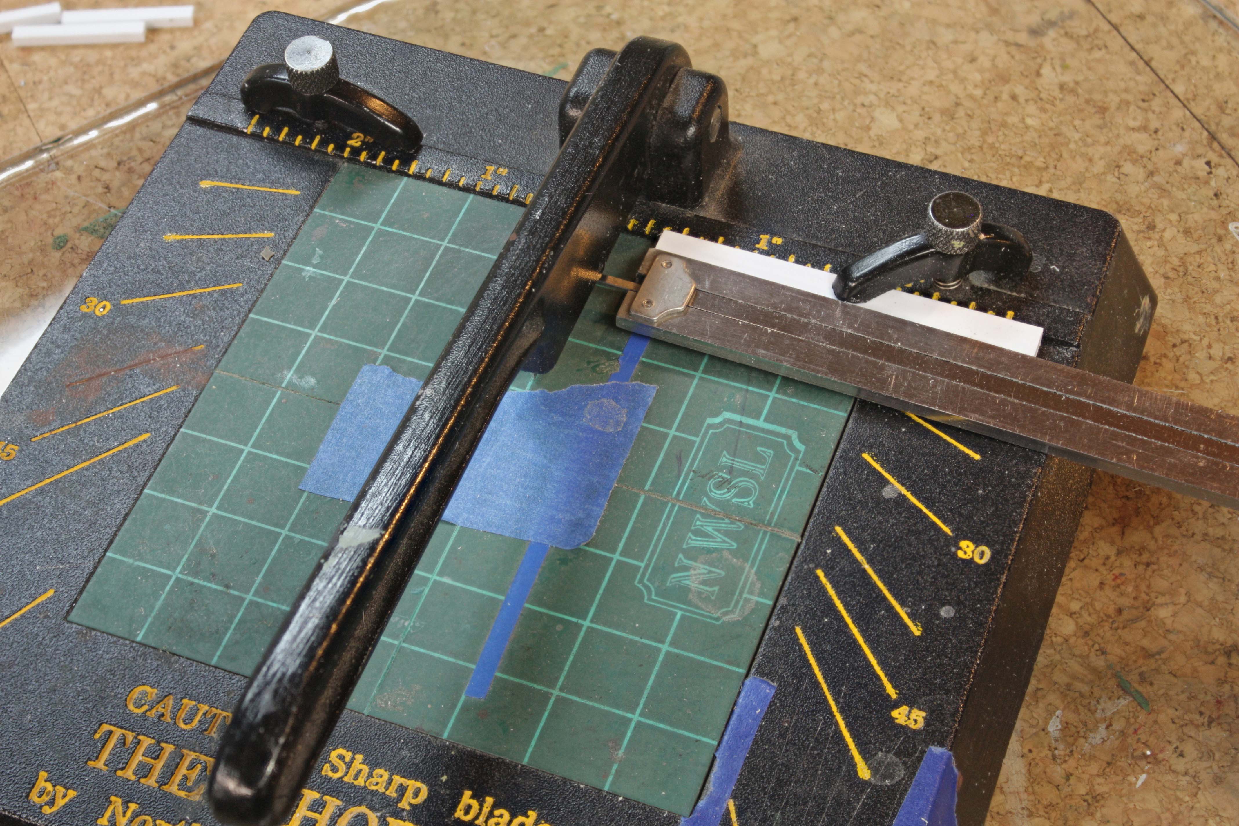

Digital calipers help in several ways.
Digital calipers are extremely handy and  inexpensive. Most people think of them as a way to get accurate measurements using the digital readout, but I’ve found them even more useful in capturing and transferring precise measurements using inside and outside measuring points.
There’s also another often-overlooked feature — a precise depth gauge. This is the metal probe that sticks out of the end whenever the jaws are moved. I’ve found that after taking an inside or outside distance measure, I can easily transfer that measure to my NorthWest Shoreline Chopper by placing the depth-gauge point on the Chopper’s cutting razor and positioning a convenient stop to coincide exactly with the end of the blade.
Fortunately, you can use the caliper as a stop because the ends have metal plates on both sides that hold the caliper prod on the Chopper’s surface. If you’re cutting thin stock, it could slip under the caliper due to these metal plates.
The resulting cuts will be extremely accurate.
