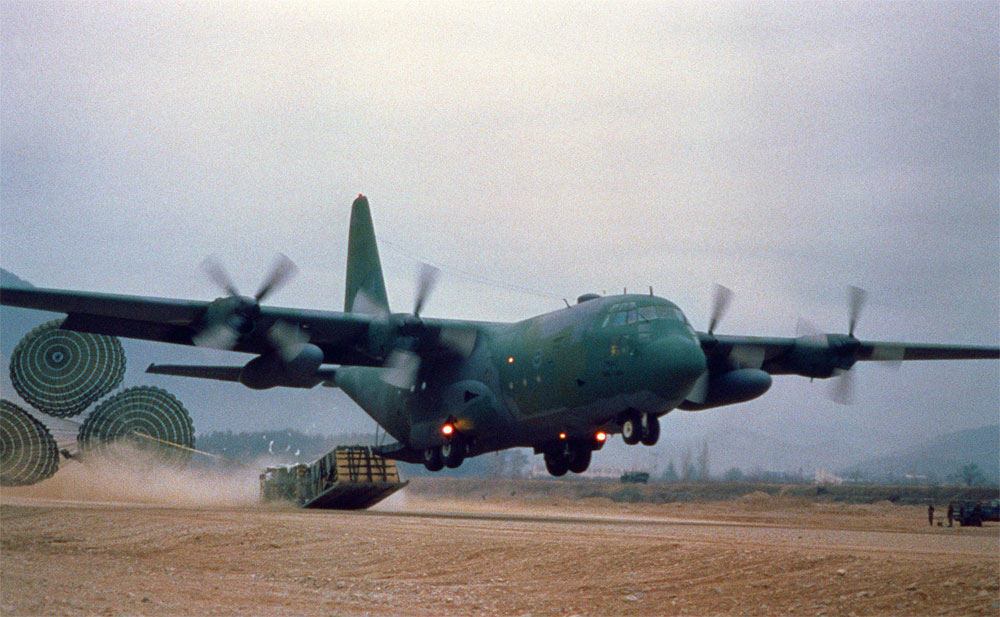

A C-130 Hercules makes a Low-Altitude Parachute Extraction System (LAPES) supply drop at Jo Ju Air Strip during the joint Korean-U.S. Exercise Team Spirit '89. U.S. Air Force photo.

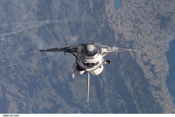

Space shuttle Discovery seen from the International Space Station during a mission in July 2005. NASA photo.

  • a C-130, C-141, or C-17 doing a LAPES (low altitude parachute extraction system) with the vehicle and parachute just clearing the ramp

  • the space shuttle in orbit

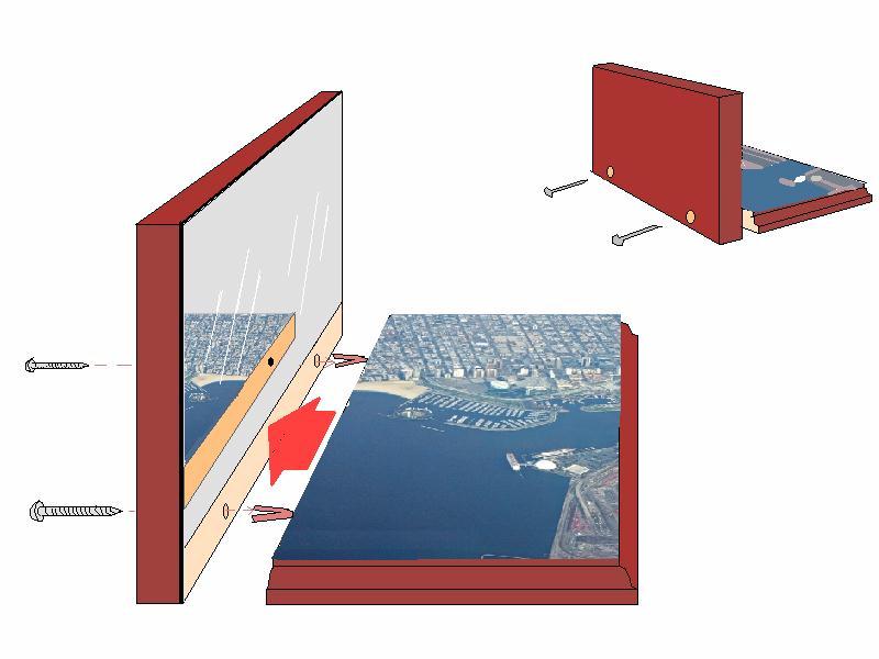

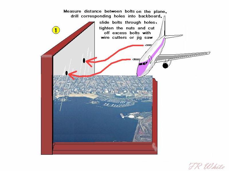

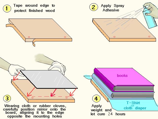

Steps for attaching the front-surface mirror to the backboard.

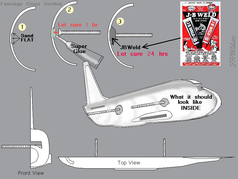

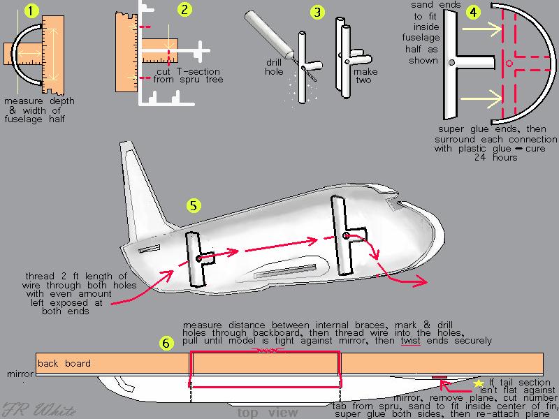

Steps for gluing bolts inside the fuselage.
Alternate method of attaching fuselage to board using bits of sprue and wire.

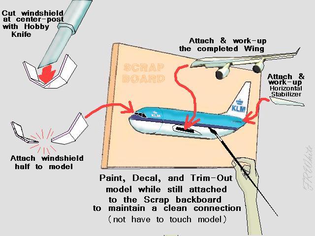

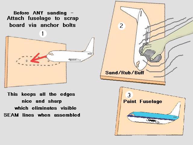

Attach fuselage to scrap wood for painting and finishing.
Paint and decal the model, then add the wings. etc.

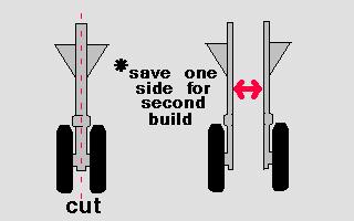

If you are modeling the aircraft with the gear down, be sure to cut the nose gear in half.

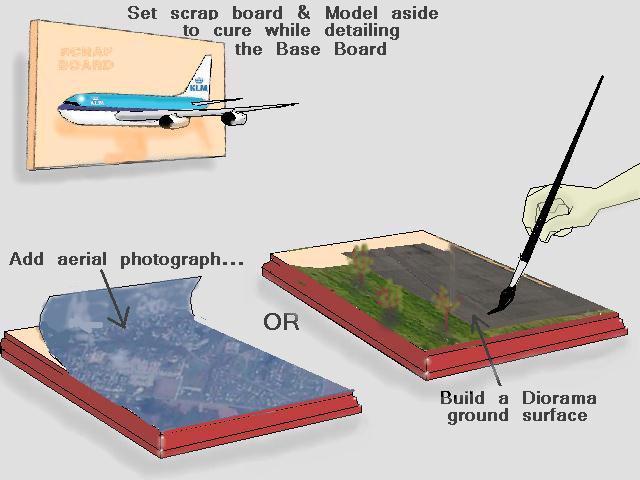

You can either build a scene on the base or add an aerial photograph.
Bolt the base and backboard together.
Then mount the model to the mirror.
