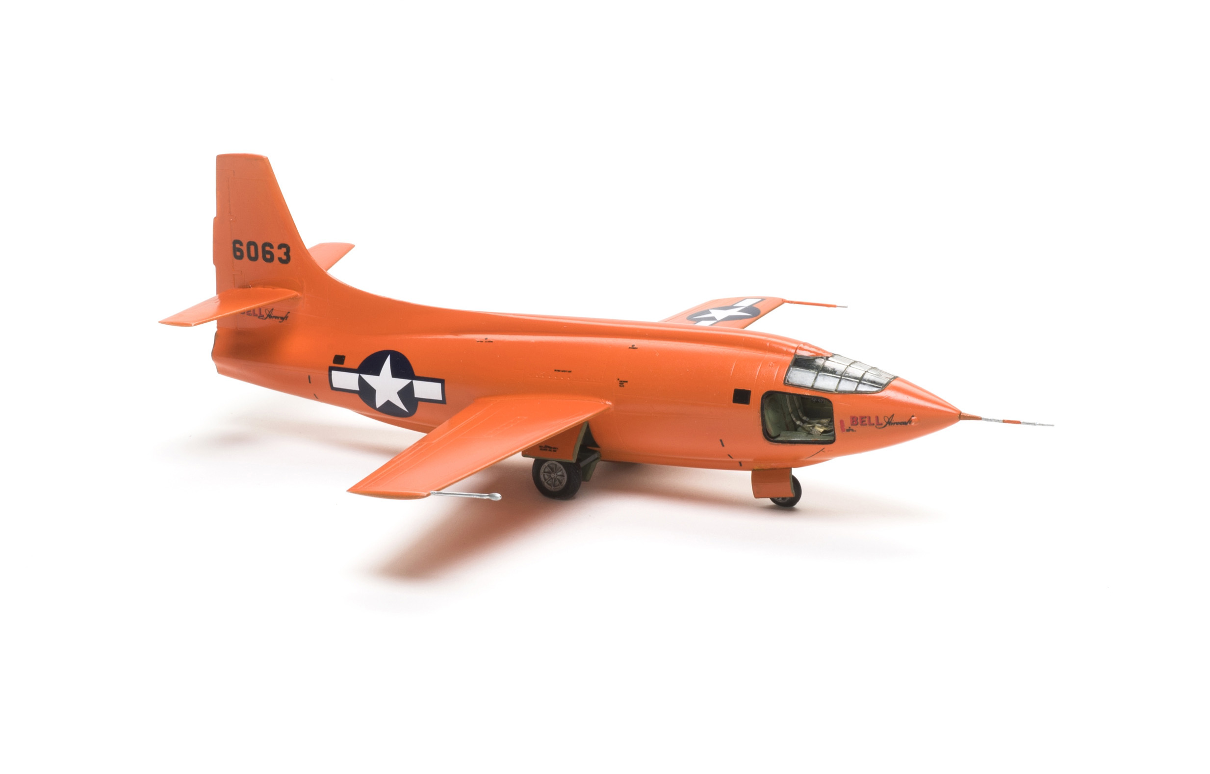

Eduard’s 1/48 scale X-1 Mach Buster is not a complex build. Proper parts preparation and basic techniques will easily yield a good-looking model.

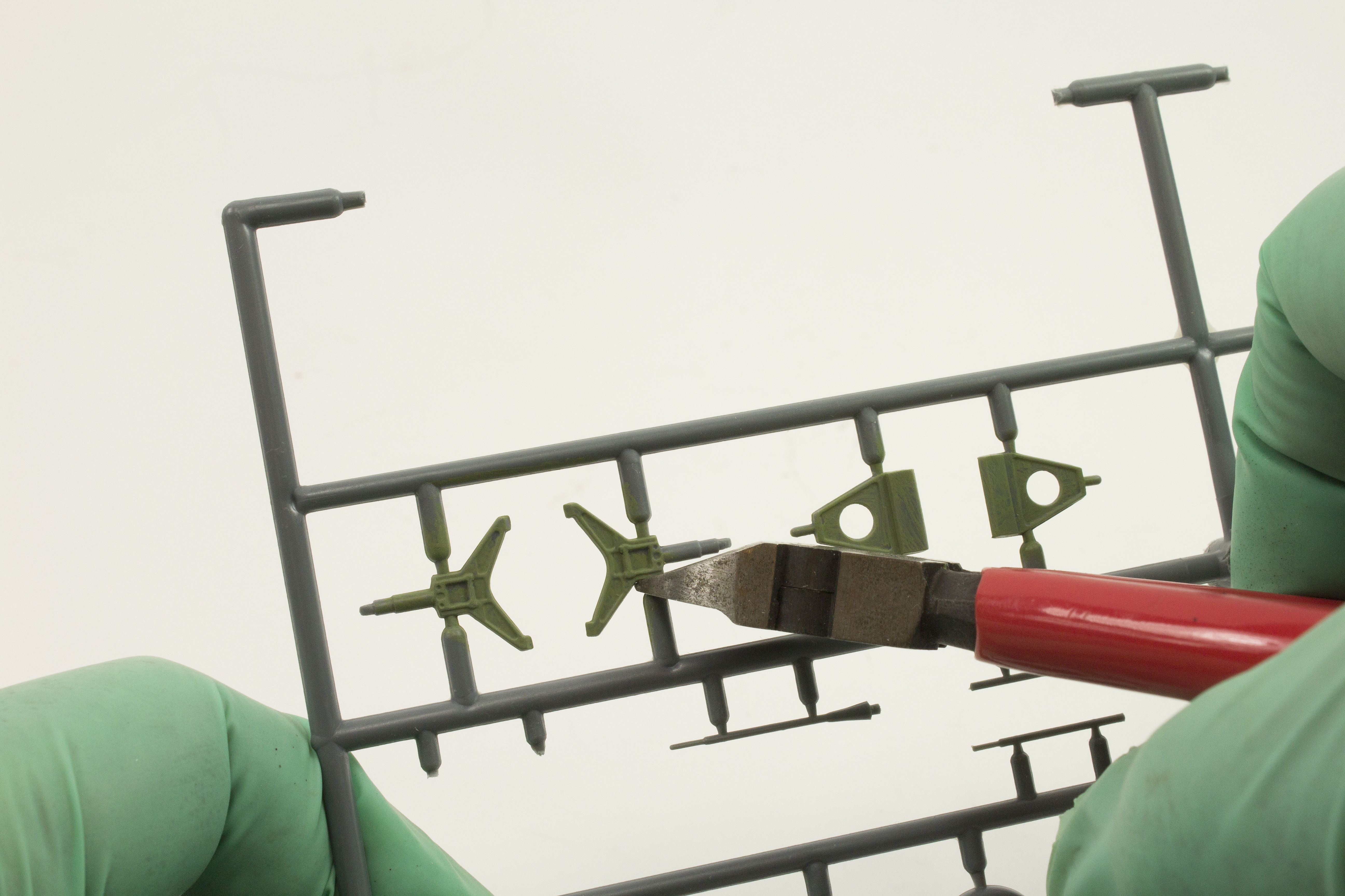

1) Don’t twist parts off the sprue. Clip as close as you can without damaging the part. Xuron sprue cutters are available from FSM: Visit Kalmbachhobbystore.com/Modeling Tools.

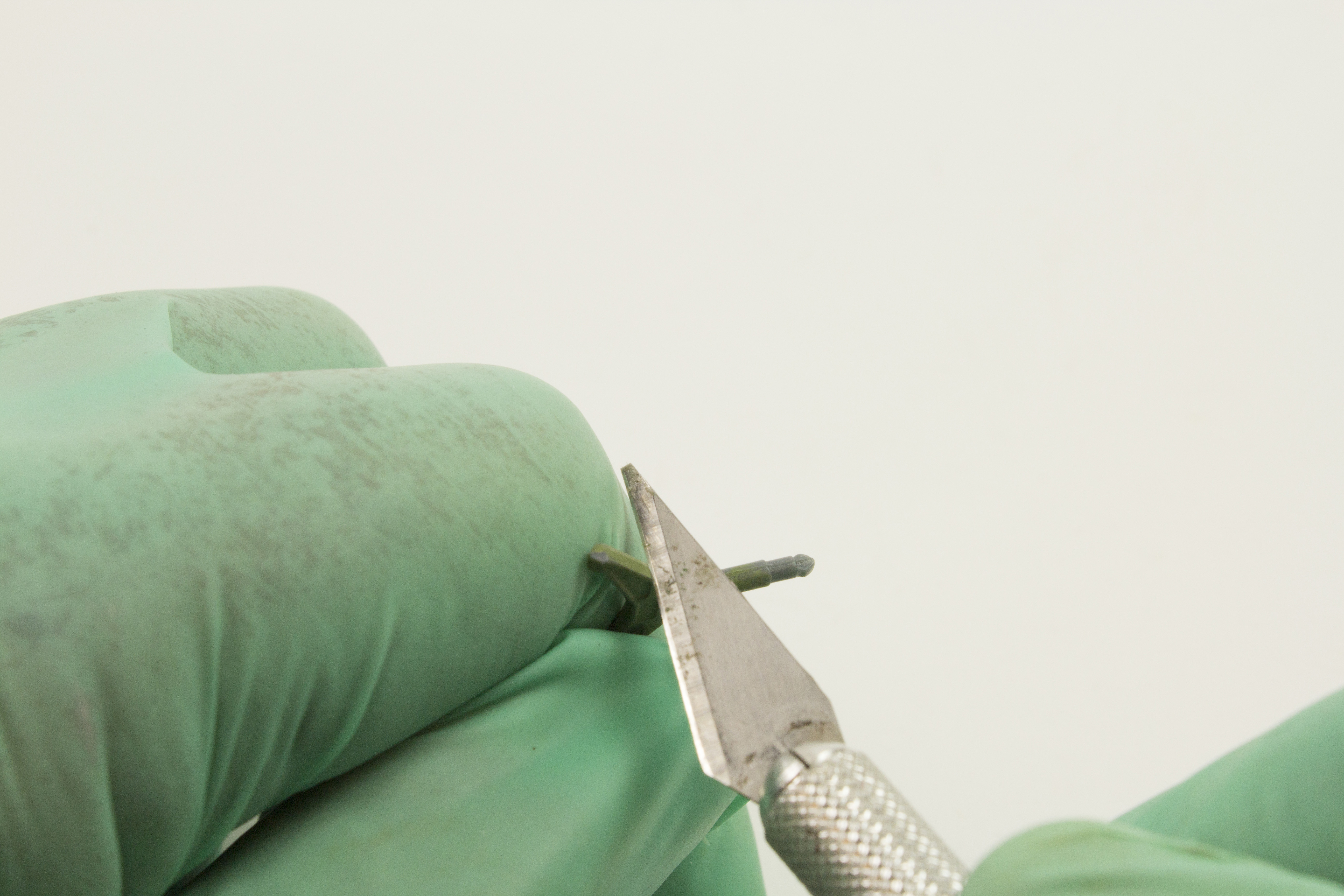

2) Mold lines are usually easily removed by dragging a hobby knife across them. Be careful not to take a divot or damage the part; sand and smooth if necessary.

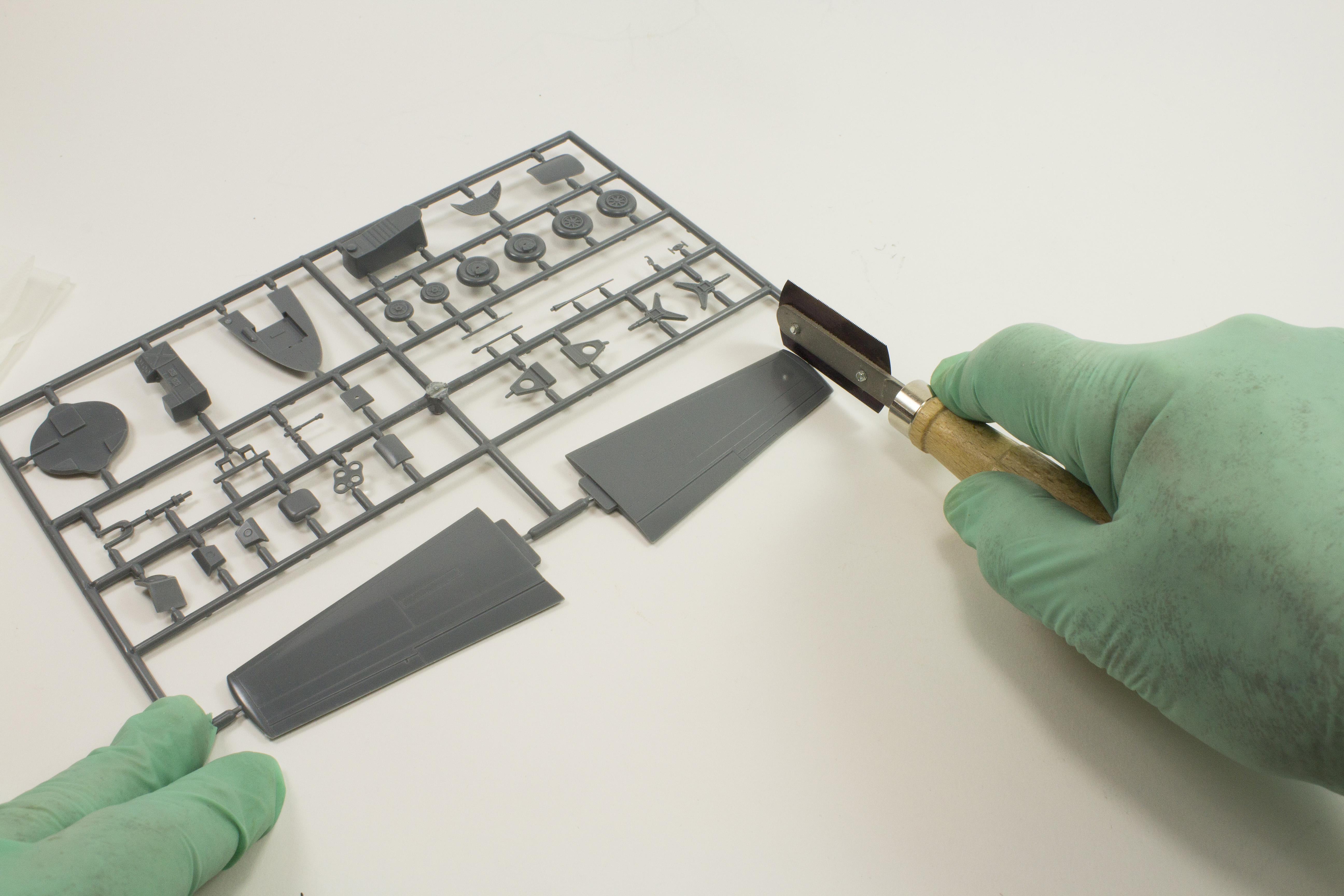

3) For thicker sprue attachments and for prominent parts (like wingtips), a fine saw may be better for precisely parting a piece from the sprue and avoiding damage.

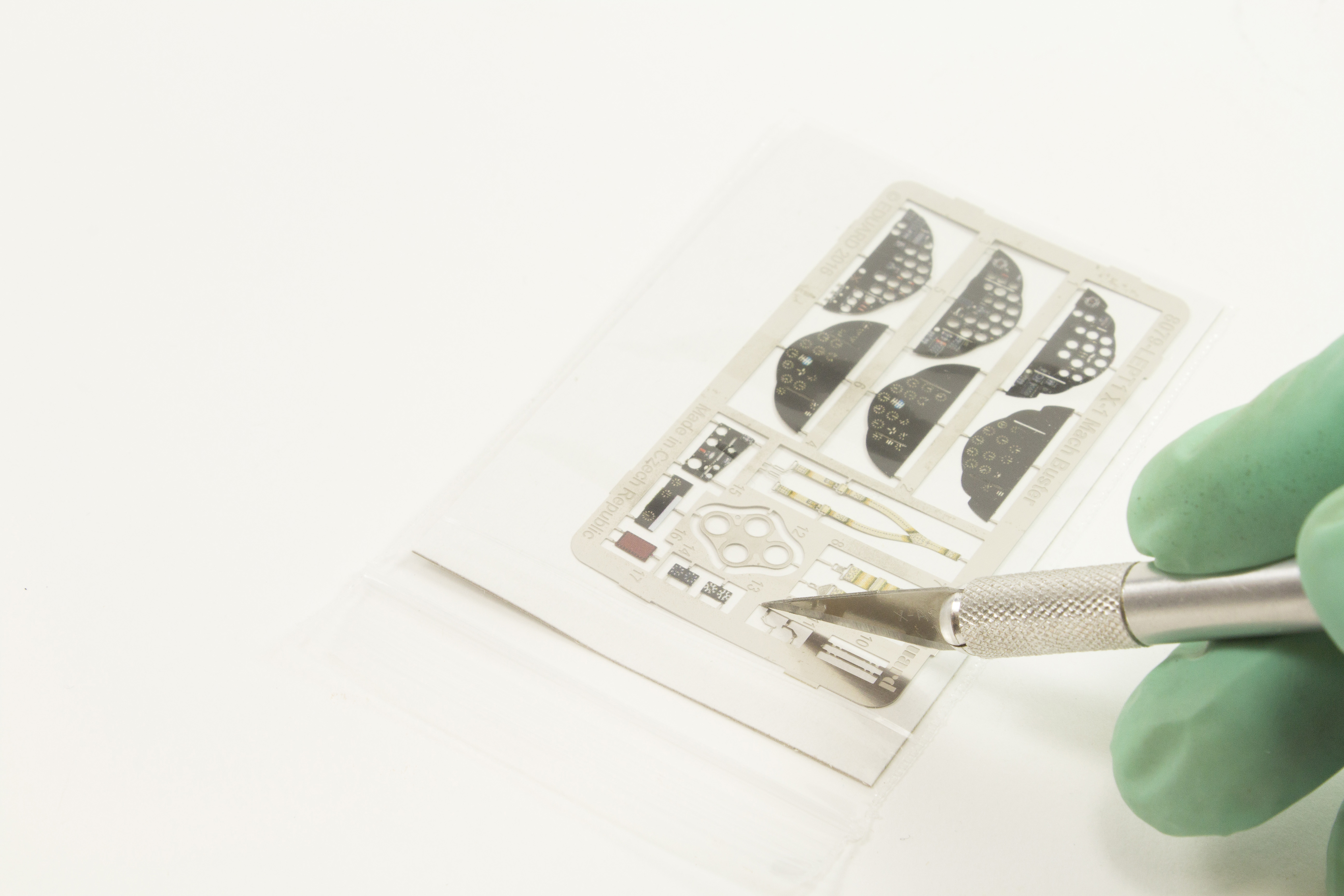

4) Cut photo-etched parts loose with a hobby knife (not your good clippers). Clip as closely as you can, but be careful — they are naturally springy and elusive. For tiny parts, I leave the fret in the bag and cut through the plastic so when they come loose, they’re still in the bag.

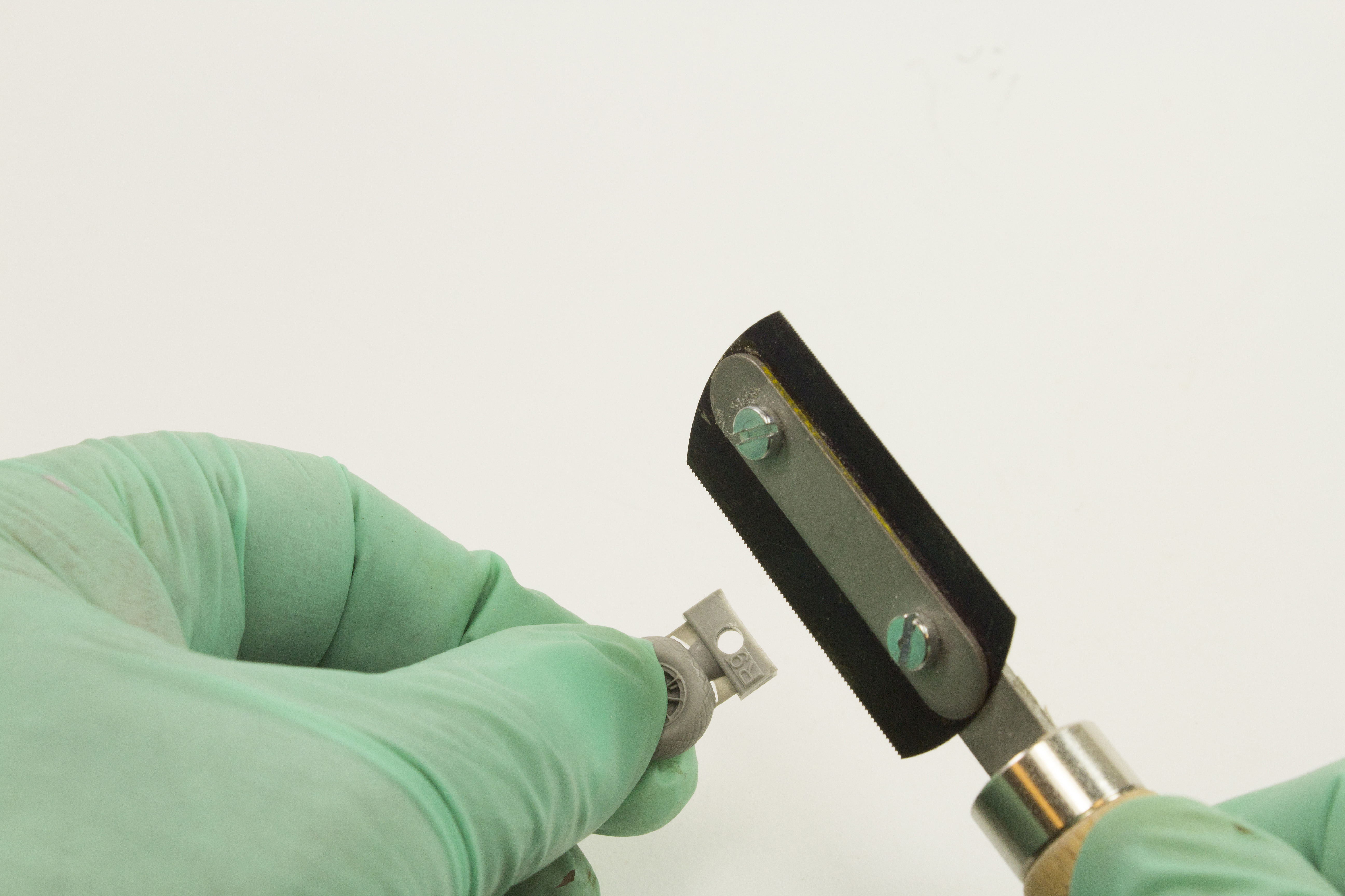

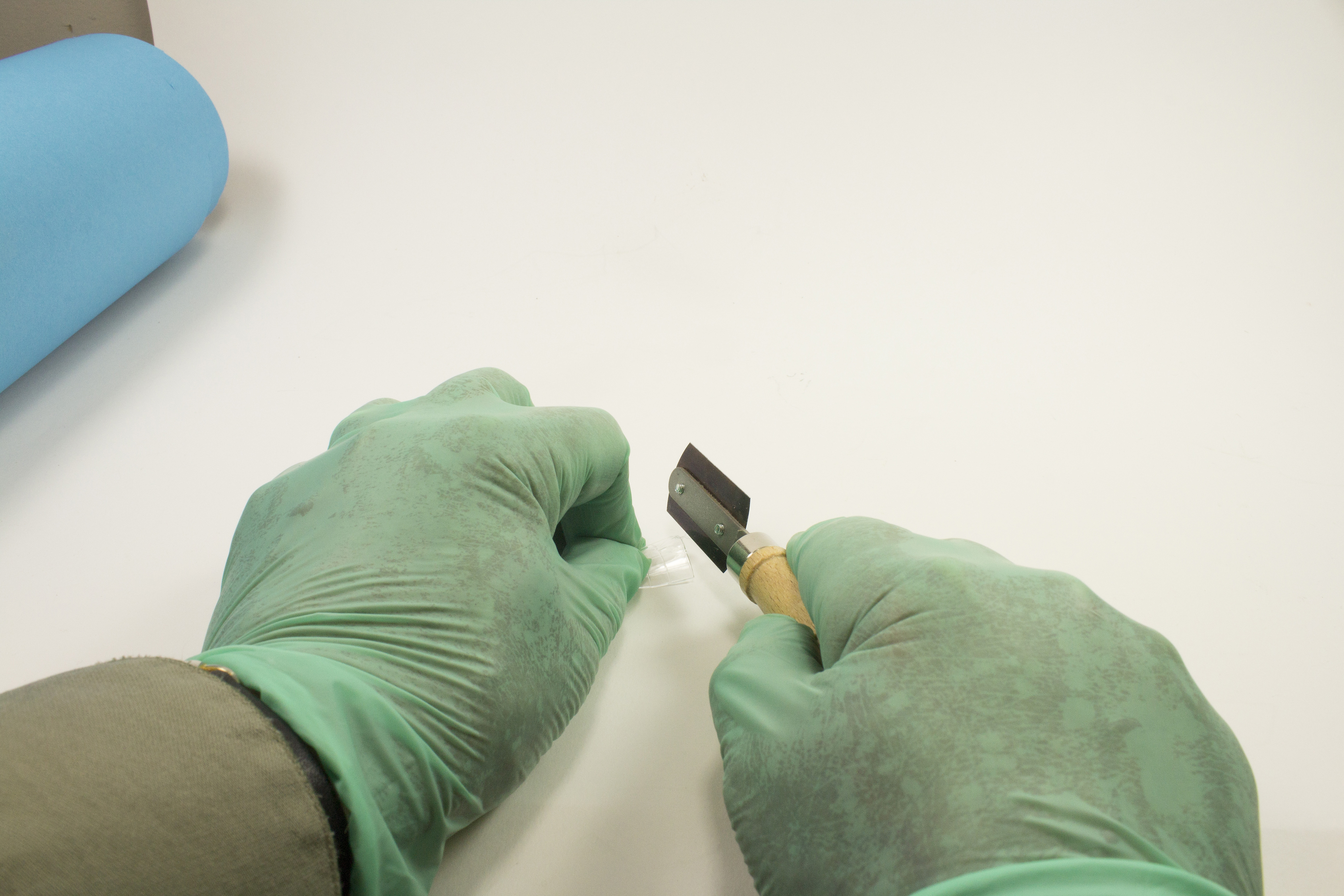

5) Resin parts often are attached to a pour stub. A fine saw (mine is from UMM-USA) is the best way to detach the stub.

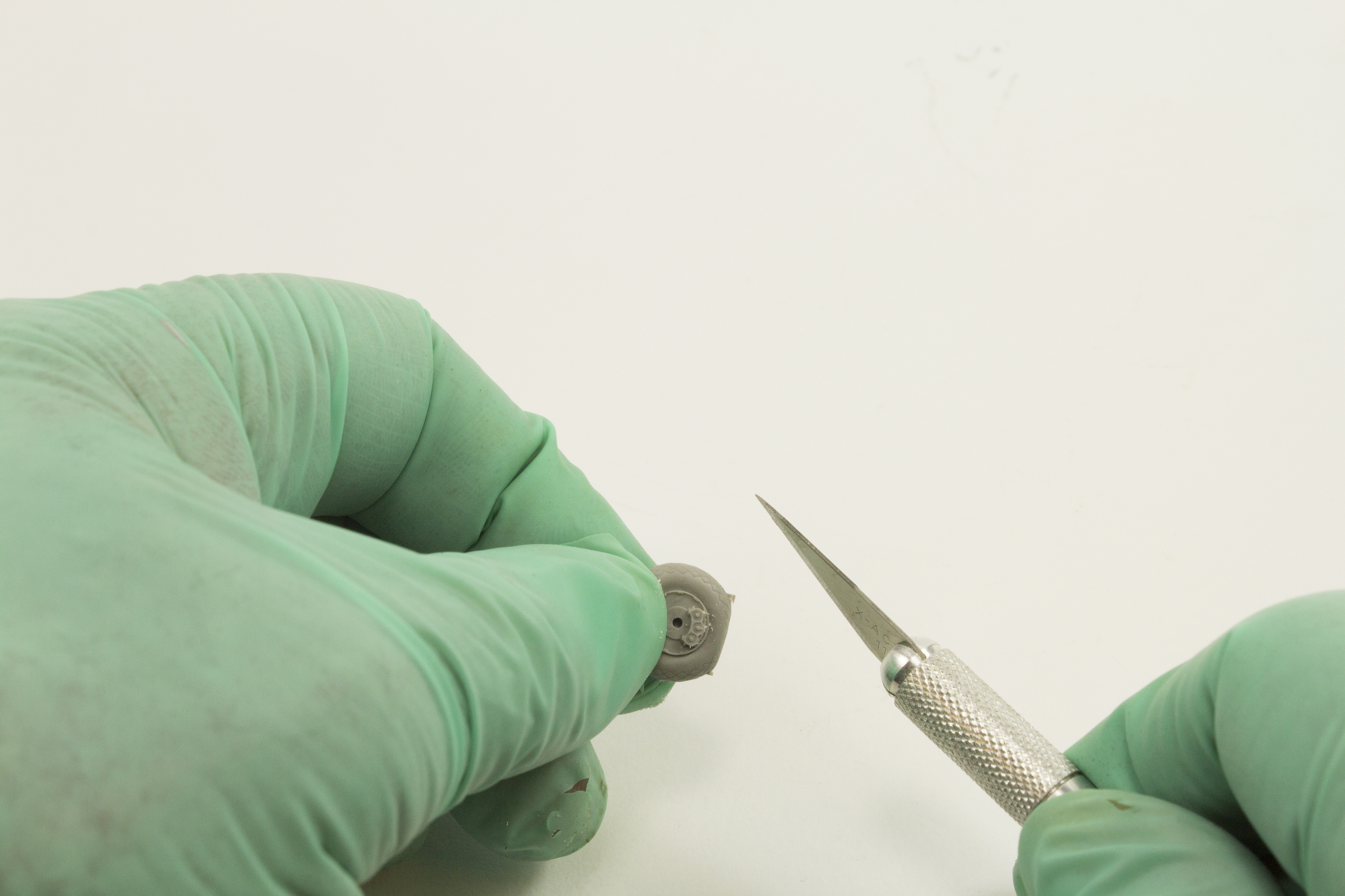

6) Trying to avoid marring the tread on the tire, I carefully trim excess with a hobby knife …

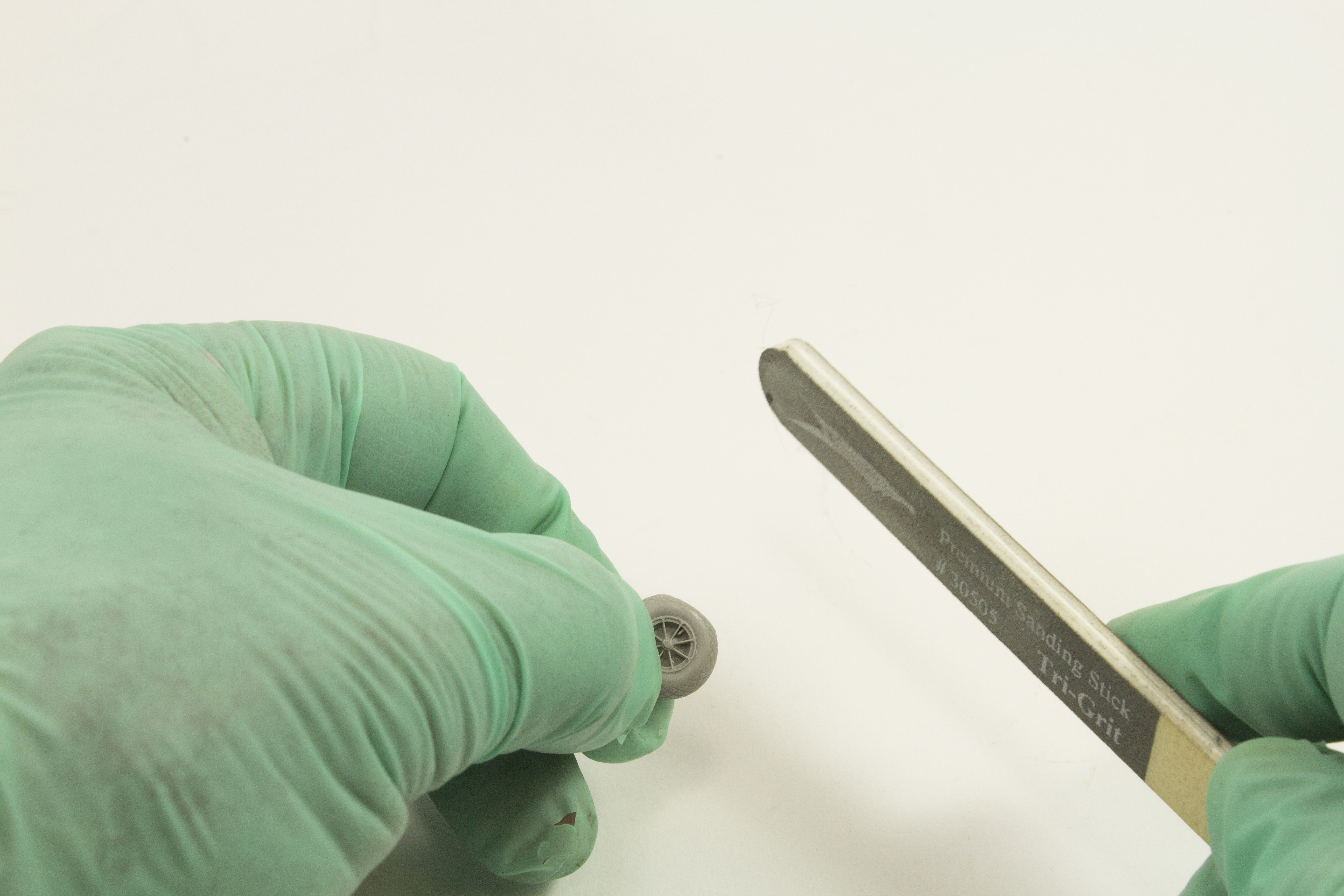

7) … before finally smoothing with a few swipes of a sanding stick. Squadron has handy sticks comprising three grades of grit, sufficient for all but the finest finishing.

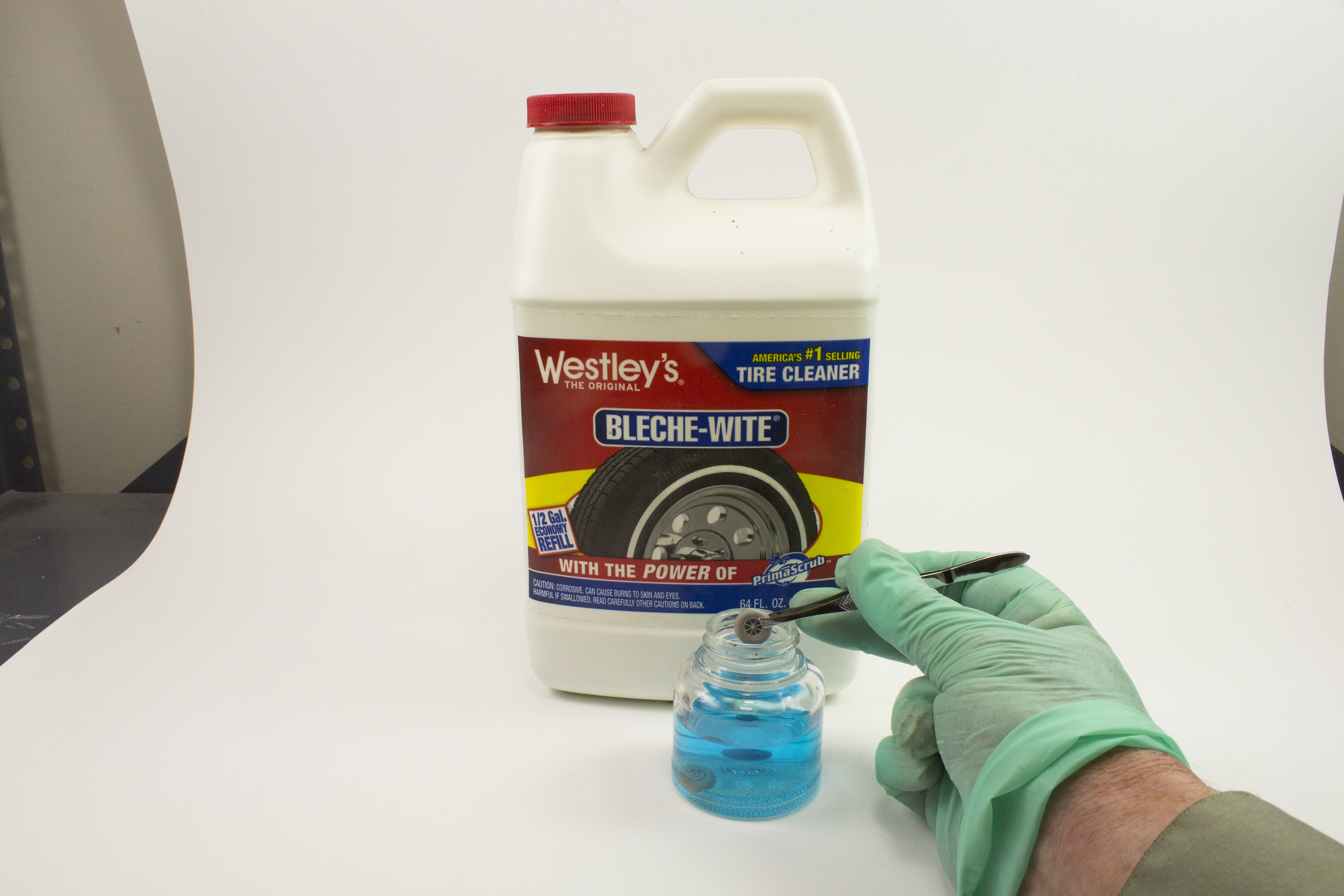

8) After the resin castings are cut loose and smoothed, soak them in Westley’s Bleche-Wite to remove oils and casting residue that can hinder paint and adhesives.
