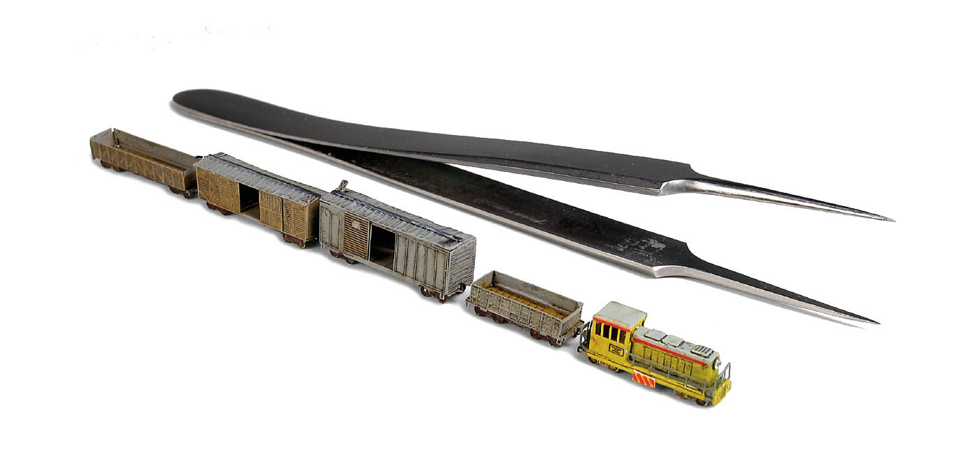

Model railroading scales add a further twist to the story. Again, without getting into the minutiae as to why, model railroading scales are represented by letters (from smallest to largest): Z, N, TT, HO, HOn3, S, O, and G. Wouldn’t you know it, none of these scales have exact matches for popular scale model scales. However, HO (and HOn3) equals 1/87; S is 1/64 (think Hot Wheels cars); O is often said to be 1/48 scale, though it can go as large as 1/45 scale and as small as 1/50 scale (a popular die-cast vehicle scale); and, finally, G is 1/22.5 scale, generally speaking.

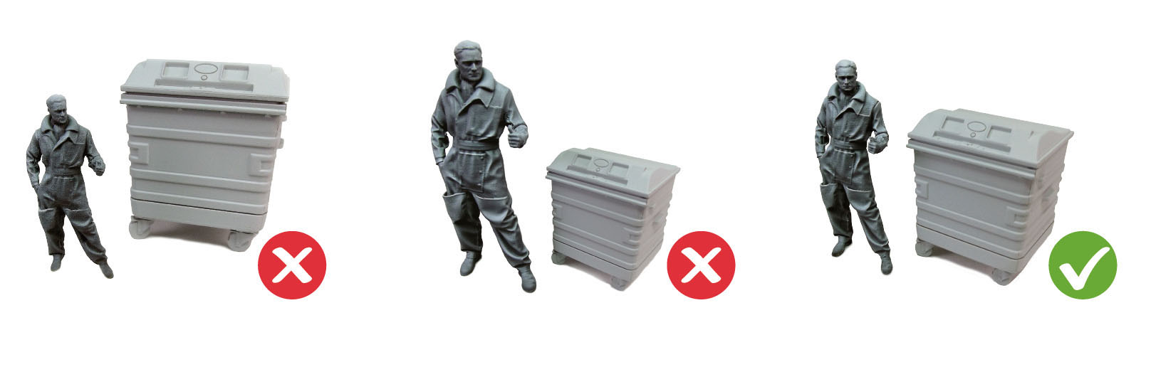

One last bit of advice: If you plan to build multiple models that have a relationship to each other, perhaps in a diorama, you should keep the scale constant. That means, if you have a 1/35 scale tank, then the figures should also be 1/35 scale (54mm). If not, the figures will either look unnaturally small or gargantuan in comparison to the tank. Yes, some modelers use models of different scales to cleverly force perspective and create the illusion of distance in their scenes. However, learn to walk before trying to sprint.
