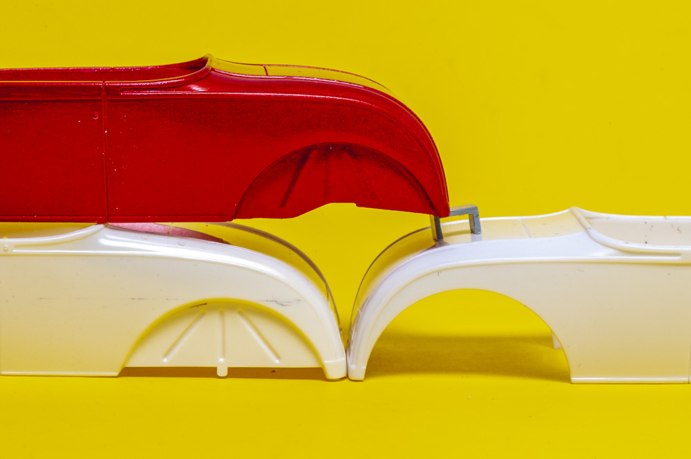

Compare the factory-original rear wheel well design of an AMT 1929 Model A kit (left) to the Revell kit (right). The Revell body has many desirable features, including the windshield and cowl treatment and correct, outward-facing wheel-well strengthening beads.

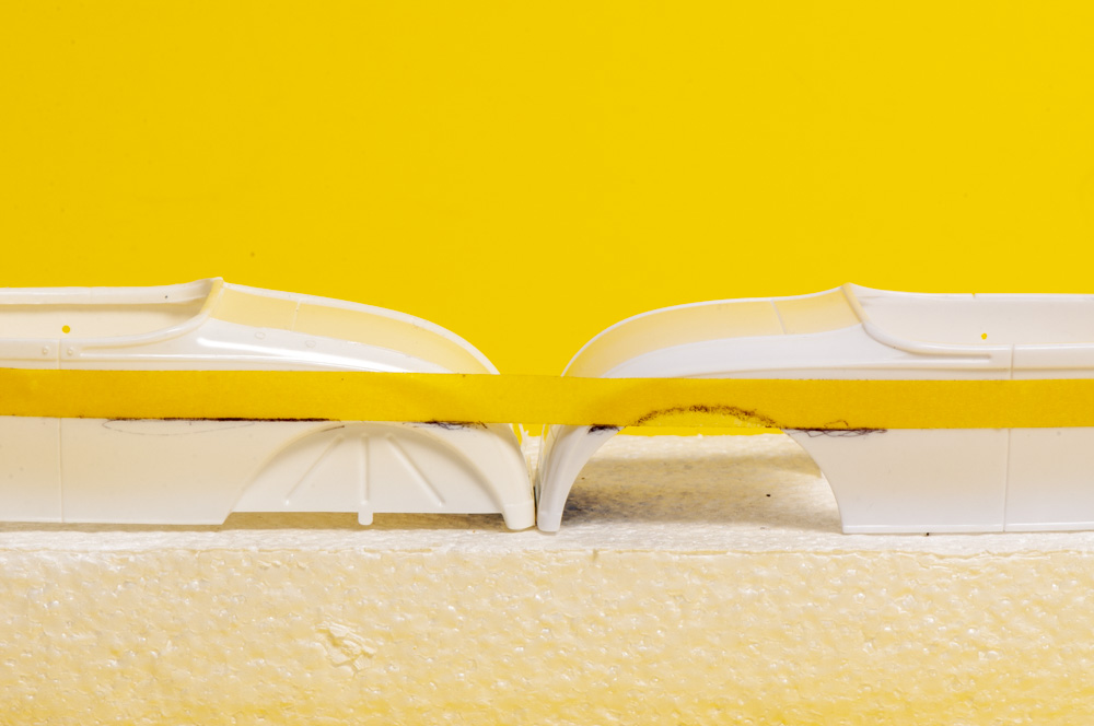

Mark the correct height for the top of the fender opening with 1/8-inch-wide tape from the AMT body onto the Revell body. If you don’t have the AMT body, you can approximate this step using the body on the right in the photo as a reference.

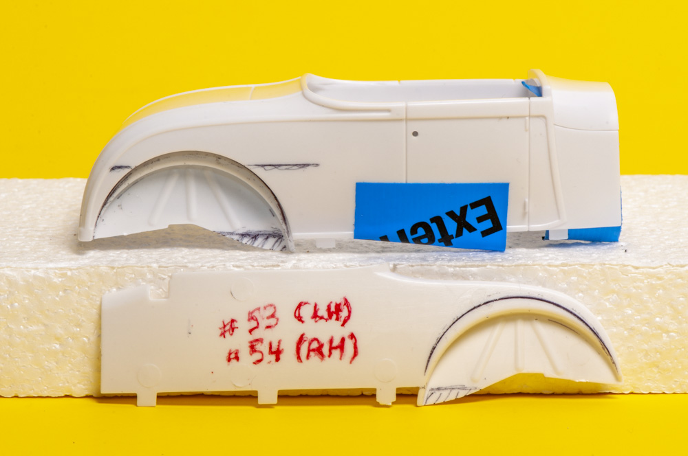

Revell molds the inner wheel well with the interior side panels. Take the interior panels (parts 53 and 54) and tape them inside the Revell body, aligning them with the top of the interior wheel well mark from the AMT body. Mark the Revell body opening on the interior panels as shown. The driver’s side panel is shown below.

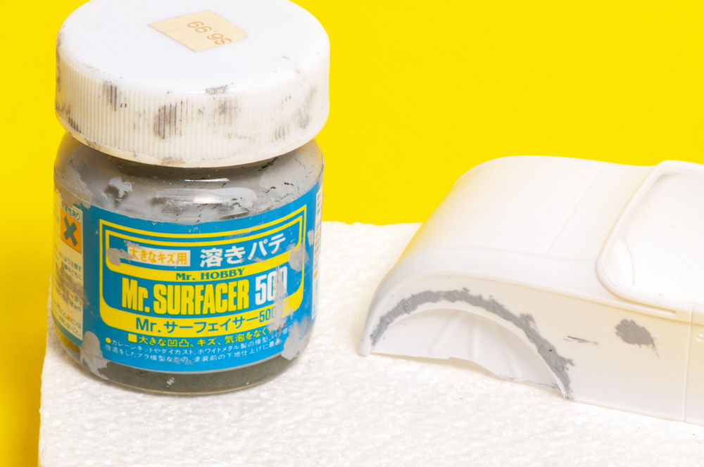

Smooth the body along the fender openings on each side to achieve a flush surface. Use Mr. Surfacer 500 to fill joints where the two parts meet. After sanding, prime the body, check for any flaws, and repeat the filler/sand/prime process until you are satisfied with the result.
